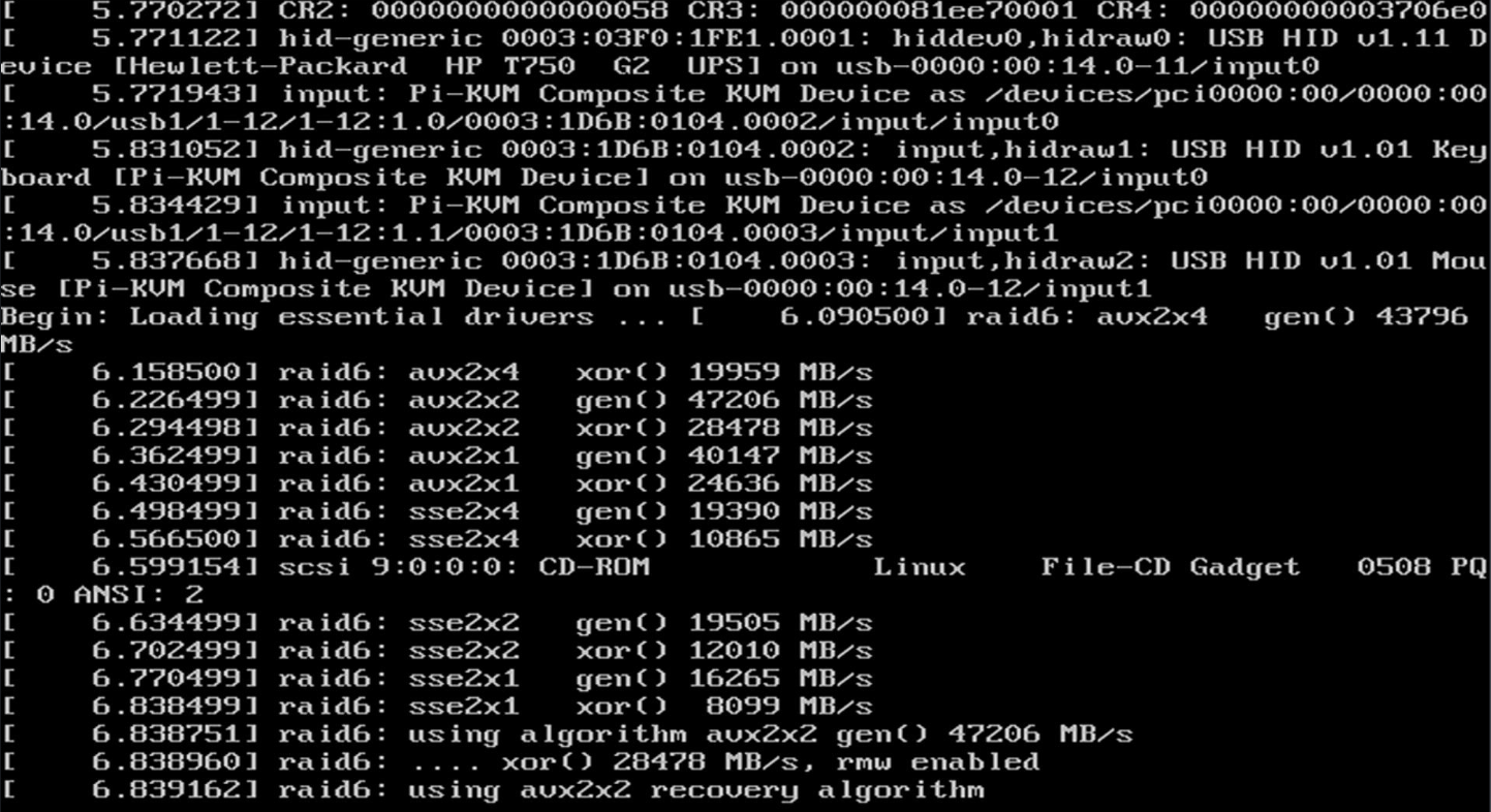

Hi All,
After updating my 22.02.1 installation last night, the server is now failing to boot:
Mobo: Gigabyte D460M DS3H
CPU: Intel Core i5-10400
Mem: 64GB Non-ECC DDR4
For storage I'm using the on-board 6 S-ATA ports plus a PCIe to dual m-SATA for the OS

Hmm...
Hear you saying that your USB drive is the issue, I wonder if it's the virtual CD-ROM that PiKVM connects to my server over USB.
Need to climb to the loft with a monitor and a keyboard, disconnect the PiKVM and test :tongue:
ASiC
Jun 21, 2022
12
Hmm...
Yup, that was it...
I've disabled the mass media storage emulation on PiKVM (https://docs.pikvm.org/msd/#basics ) and 22.02.2 booted up.
Right, I believe it's safe to assume that 20.02.2 will not boot with USB storage devices connected.
Or at least on PiKVM and larod241 external drive.
