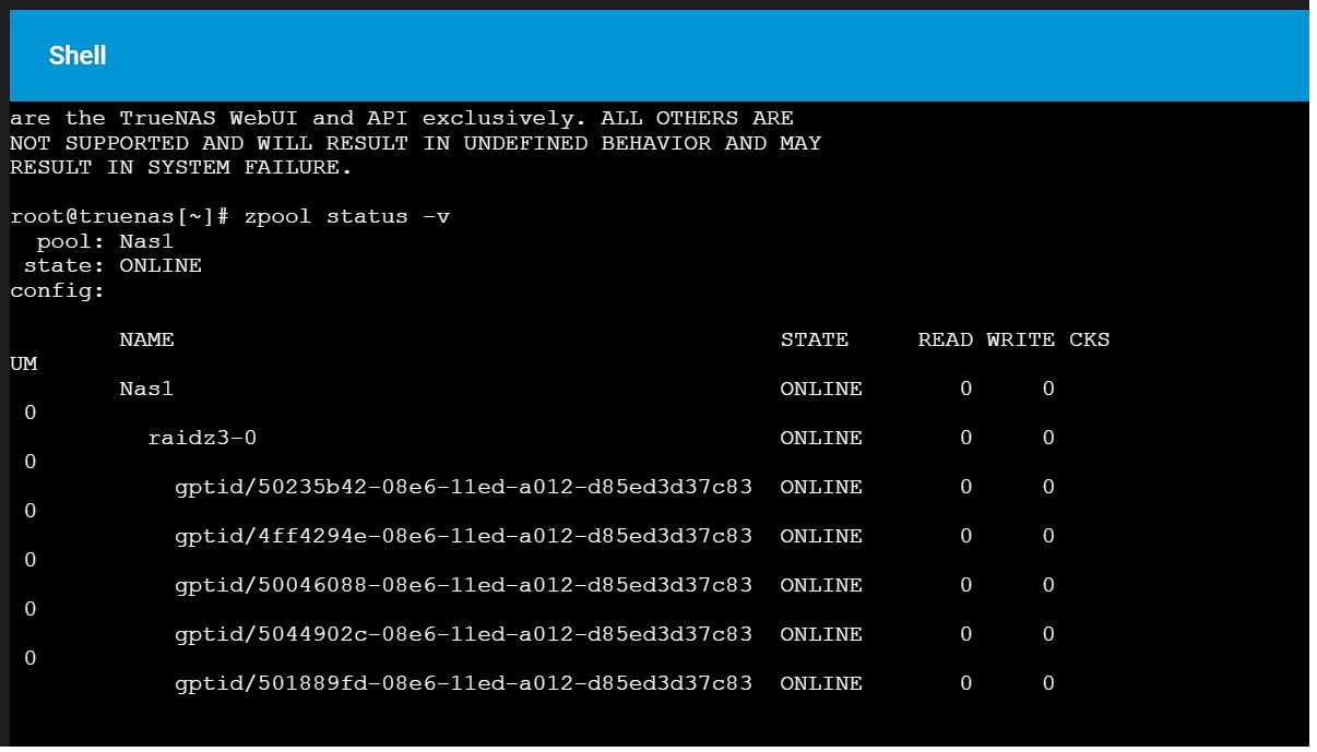

If not showing , go to Shell, and run zpool status -v and post results here (best to copy/paste results from SSH access as copy/paste from the Shell, as most Shell stuff, just sucks).

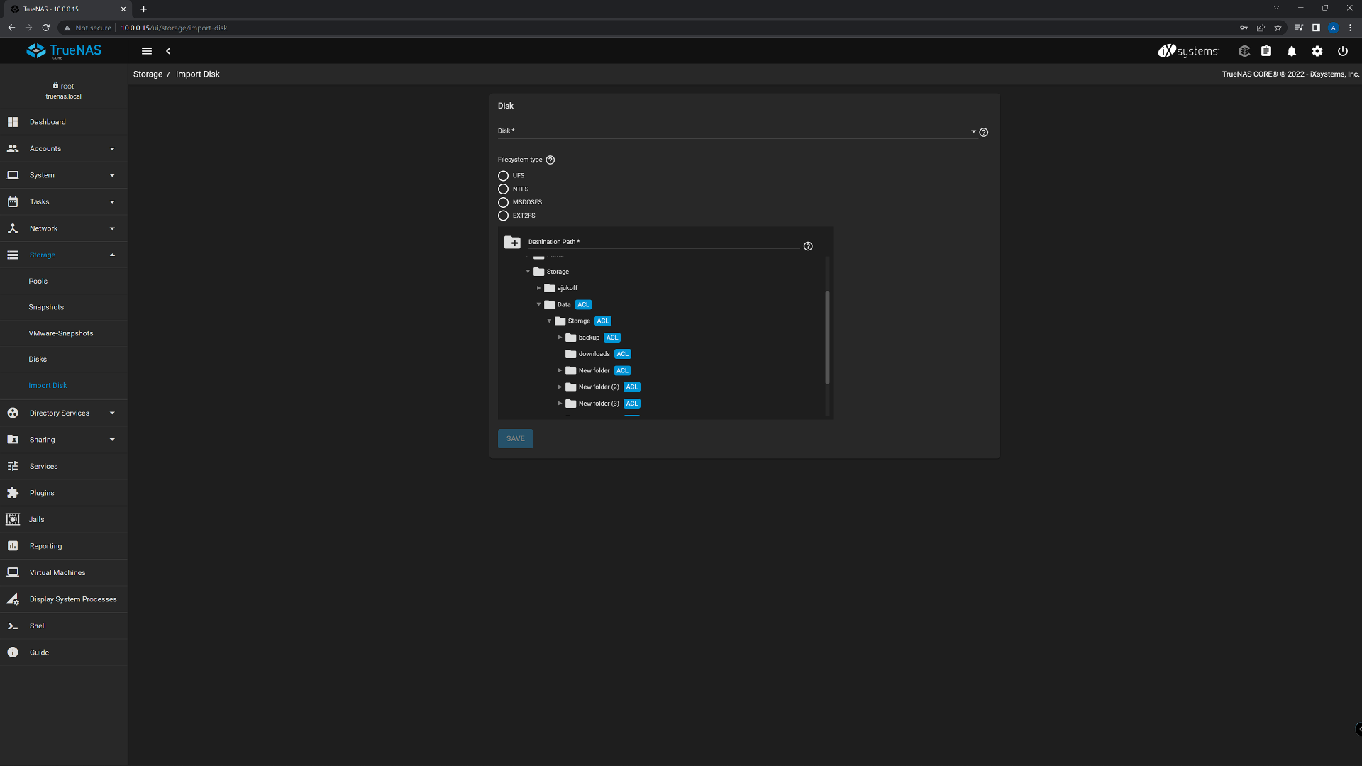

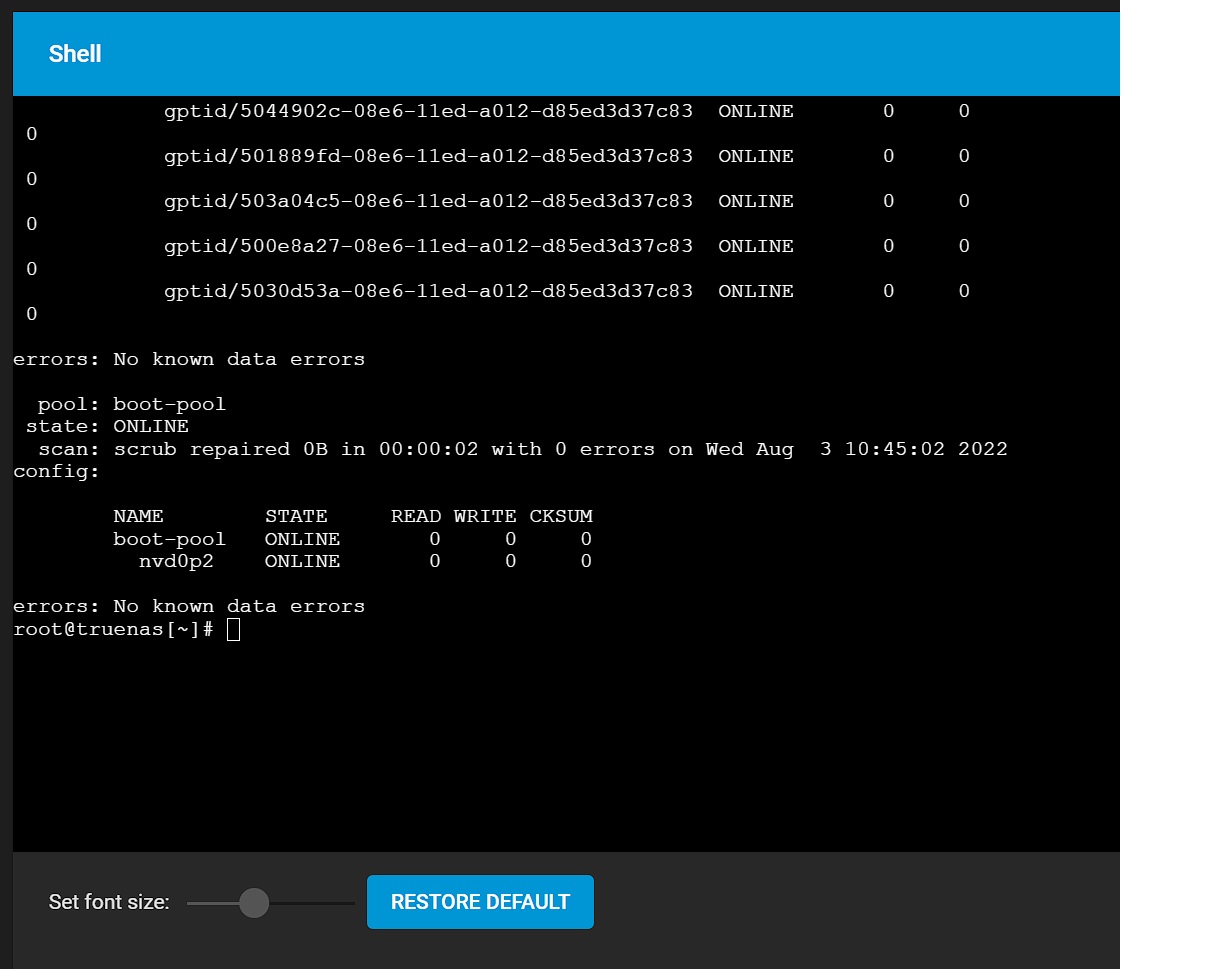

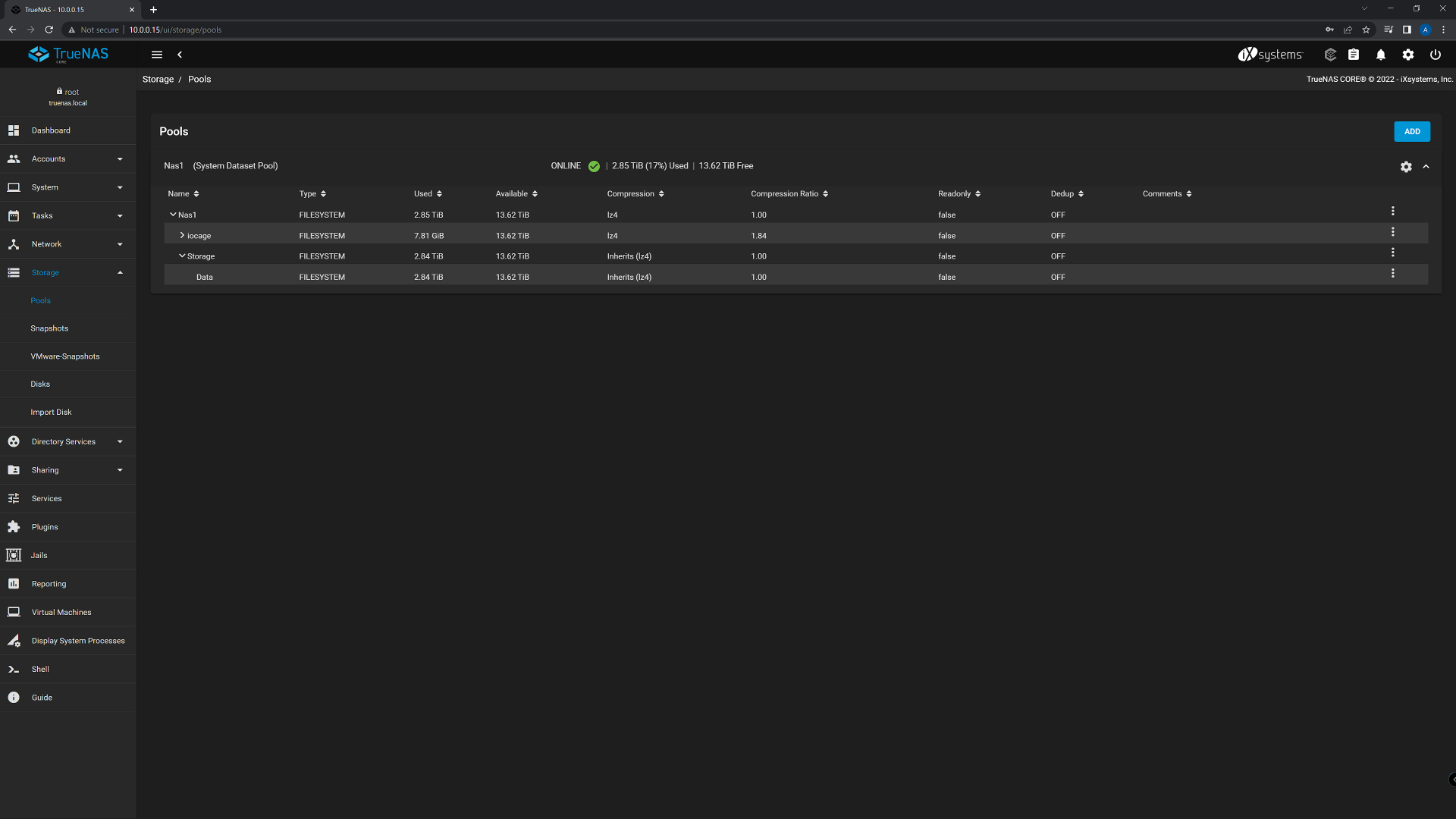

Hi Redcoat,
I have followed the procedure you set out but after importing the pool I still don't have my original files or folders available. Zpool status gives me these results

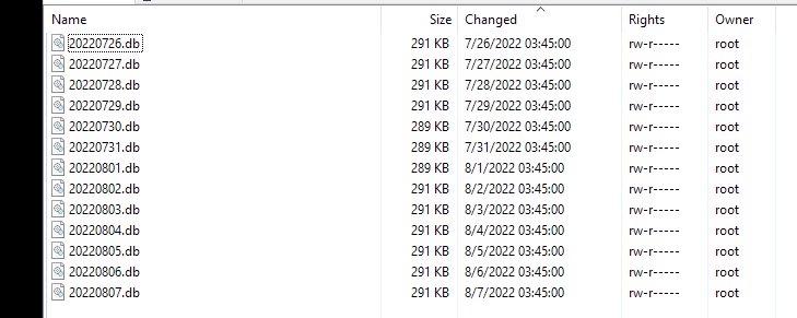

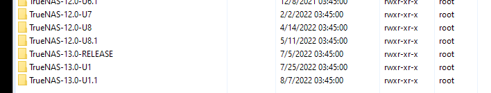

EDIT: Is your server left running such that the daily automatic copy of the configuration will have taken place (typically between 3 and 4 AM EST for me, not sure wjhat the global default is)?. If so, we should recover the backup made the day before you made your upset system mods (or the most recent one made before that time). Though this can be done from the CLI, I strongly suggest that you set up root SSH access to your server and install a copy of WinSCP on your PC.
The config db file is named freenas-v1.db and is located in /data. The automagically stored copy is in the path /var/db/system in a directory that will be named configs-****random_characters****
Mine looks like this: configs-22ecd063490d4ed98c05cf93f09e5b6b, and here's part of what's in it:
In the last entry are all the daily auto backups since I loaded 13.0-U1.1
My idea is for you to find what you have for "the day" before your system upset and copy that file to your freenas-v1.db using WinSCP to do so.
