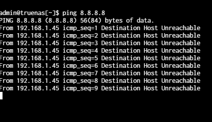

But when I try to ping 8.8.8.8 I can't

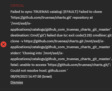

I can't see all the apps that are there I keep getting an error message

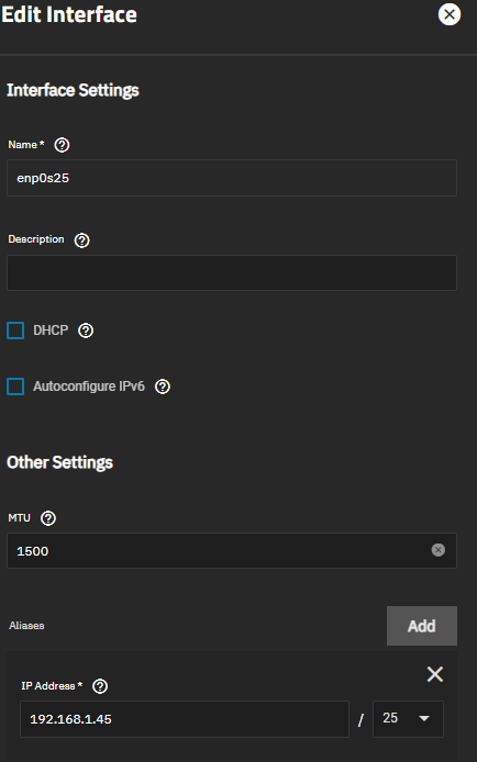

Is that intentional that you set your netmask to /25 and not the much more common /24?

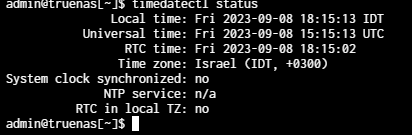

Regarding the time settings, you say you've set it in BIOS but what did you set it to? The time in UTC or something else?

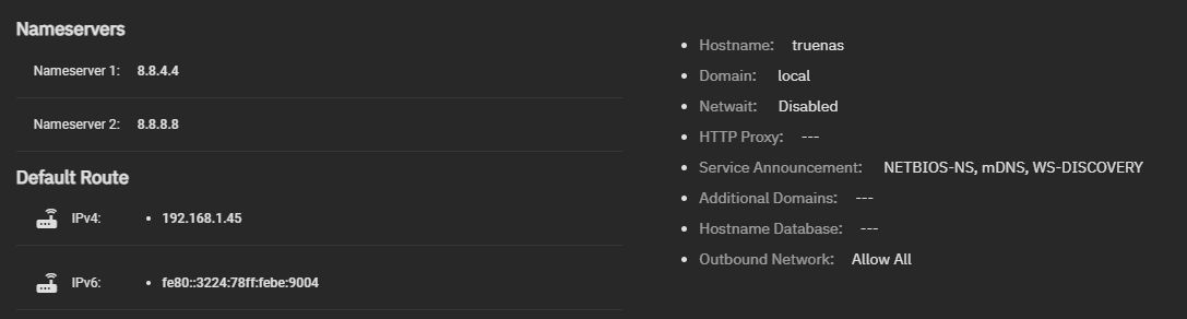

Please also post a screenshot of the network "Global Configuration".
Thanks for the comment
I changed now to 24, there was no reason for it
I tried to change the time in the shell
I read a bit and realized that my problem might be the time and date
I am attaching a screenshot of the time I get
I tried to add ntp server right now without success

If you get "destination host unreachable" you probably did not set your default router correctly in the global network settings.
neofusion
Apr 2, 2022
159
That's exactly it.
As shown in the last screenshot the default route is the same IP as the IP set on the TrueNAS box. That means TrueNAS has no idea how to get out of the network.
You (OrelLuzon) should set the default gateway to the internal IP of your router. Your router is probably 192.168.1.1 or 192.168.1.254, but please double-check, don't just use my guesses. :smile:
