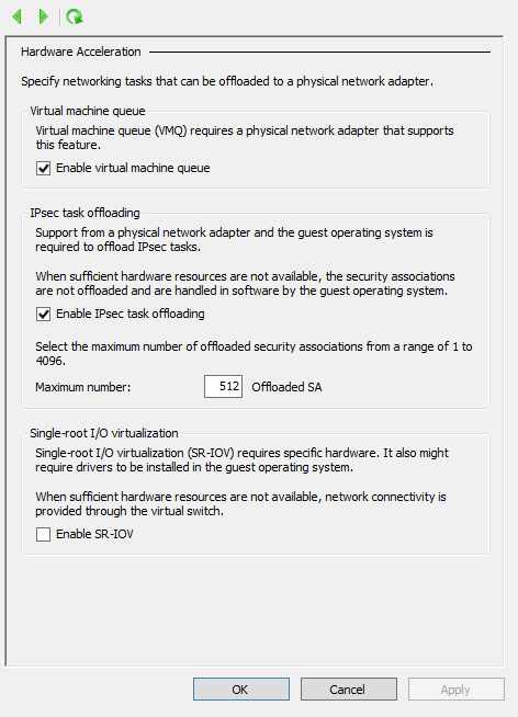

I have two TrueNAS servers, one is on Windows 10 and another is on Server 2019, both running in Hyper-V. I am having a similar issue on both systems. TrueNAS runs on FreeBSD 12.2. I have narrowed it down to a networking issue inside of the VM. The issue doesn't occur anywhere else on my network or in a Win10 guest VM on same system and it is not a problem with the disk drives because it occurs writing to a single SSD as well as a Z2 array. Both systems are using a virtual switch based on Mellanox Connectx-3 10G adapters.

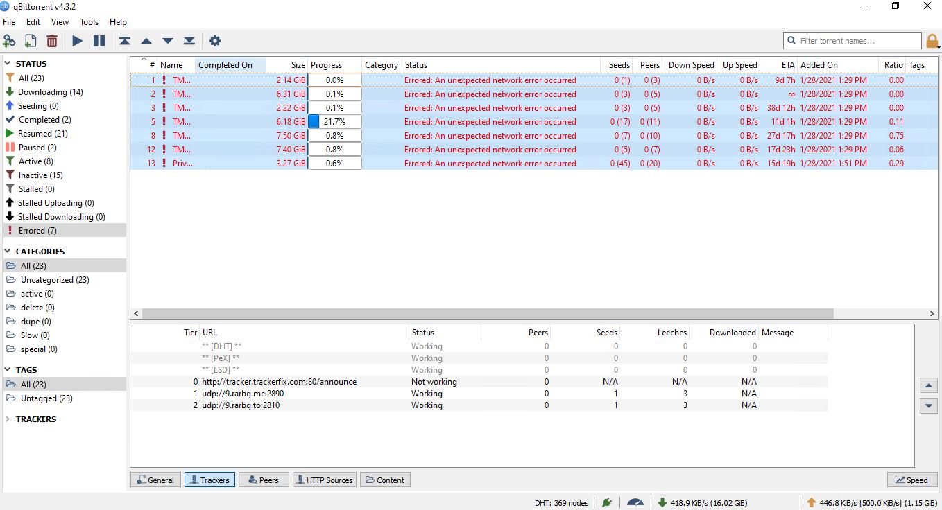

What is happening is that everything boots up and runs fine, but I will get random network errors. Every so often, 5-30 minutes, I get "an unexpected network error has occurred" in Beyond Compare and/or qBittorrent when I am writing to the TrueNAS server. One file will error and then it will continue with the rest of the copy and I just have to resend that one file. I can copy several Terabytes and maybe a handful of files will fail or in qBittorrent a few downloads will error every 5-30 minutes usually resulting in all the downloads failing several times.
I have tried # sysctl net.link.ether.inet.max_age=60 but didn't seem to help. I am wired in with 10G fiber. I have tried disabling VMQ and also Enable MAC address spoofing in Hyper-V, but didn't make a difference that I can tell. Any idea what the problem is, I would really like to be able to use this server reliably. Please help

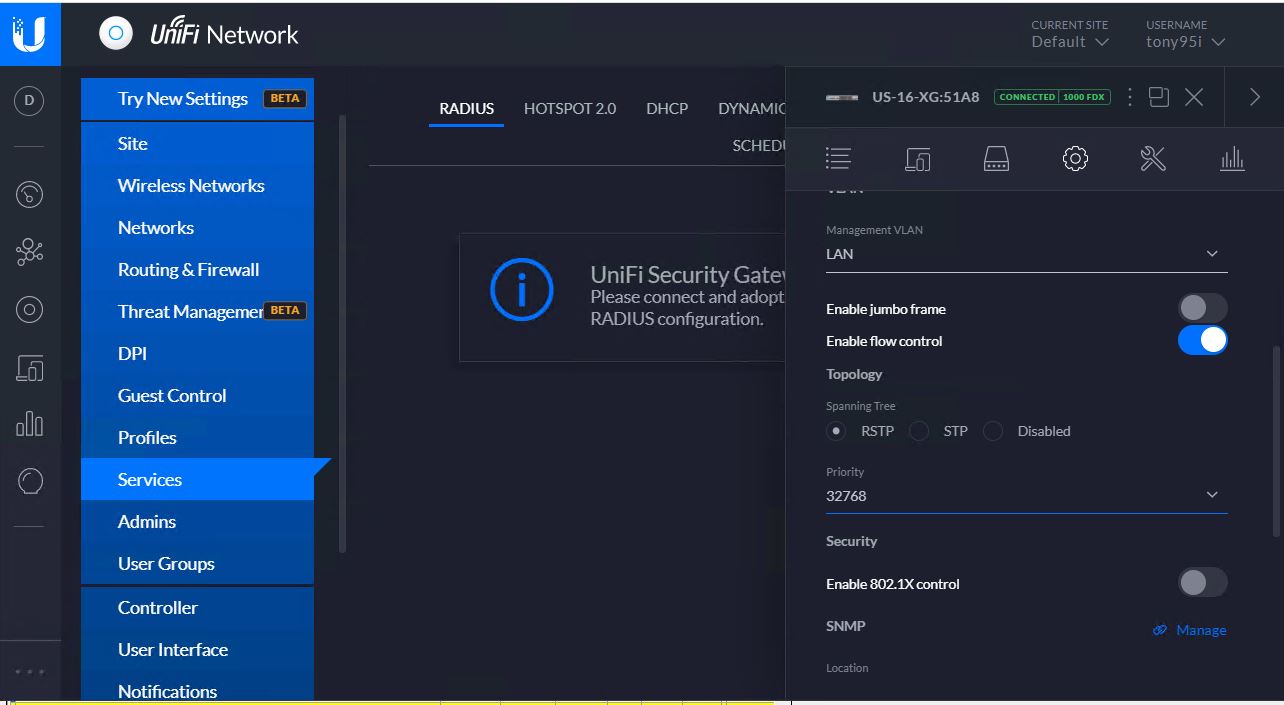

Everything is connected through a unifi-switch-16-xg except a couple of things on dumb netgear gigabit switches. I should probably try to test without the 16-xg, because I had to enable flow control on it to get my 1GB connections to work properly, this shouldn't be creating network errors but you never know. The error is just "unexpected network error has occurred" in either Beyond Compare or qBittorrent, I am sure it is happening elsewhere but these applications are good about catching the error.
tony95
Jan 2, 2021
117
This is the only thing I have changed in switch, enabled flow control. There is a topology there, but I don't know anything about it.

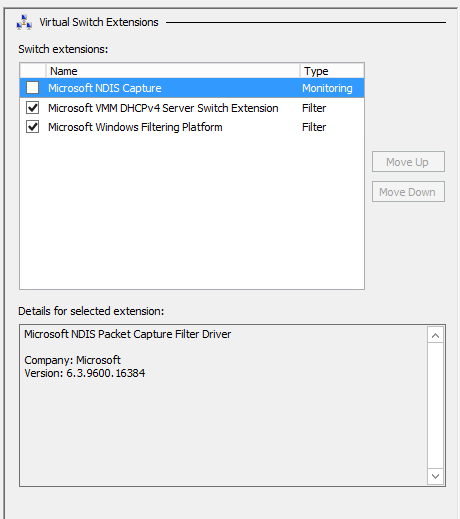

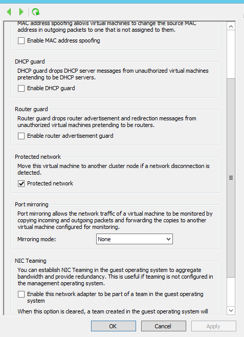

Here are the current setting on my switch that seems to provide the most optimal results to me (it may have something to do with turning on NDIS Capture attempting to comb through that much data along with flow control). I would attempt to turn off Flow Control and NDIS as they are both attempting to scan all of that traffic which may provide an inital transfer but the bug out. Let me know your results once you test it.
Switch Config:
Host VM Settings:

I can't turn off flow control because my 1G performance goes to pot. The NDIS Capture extension was showing a problem when I looked at it, so I disabled it. I don't have the VMM DHCPv4 extension, hopefully I don't need it. I am testing now, but it can be difficult to tell if problem is resolved because it will pop up almost randomly. Some times I get errors after a few minutes, sometimes it take 30 or more. Running several low speed transfers across the network does seem to cause it to happen faster though which I am doing. About 20 minutes in right now, no errors yet. If we make it an hour then that would be a good sign, but probably won't know for sure until it runs a day or more.

Failed again at about 35 minutes which is pretty common after a reboot. I am going to try again from a different PC to the TrueNAS VM.

Failed again running on a completely different PC sending to the NAS. Again after about 35-40 minutes. This has to be some sort of buffer overflow issue or something like that? Runs fine for 30 minutes then errors. If I have no load on network it seems to run longer.
