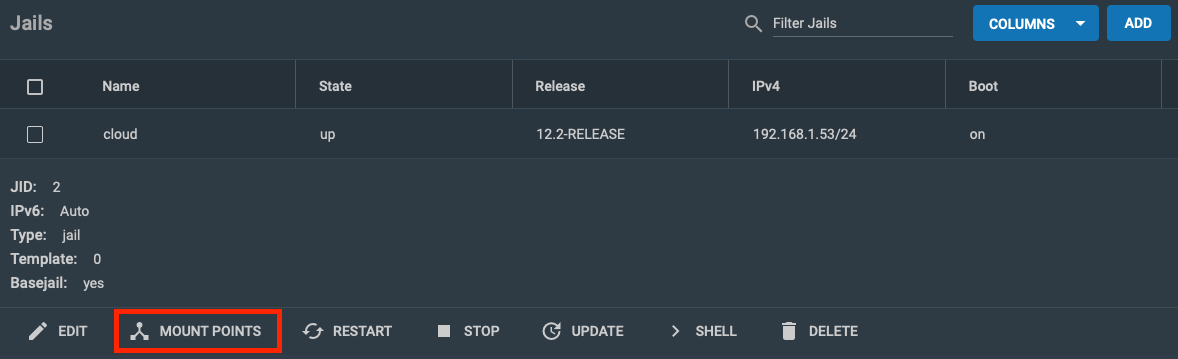

Samuel Tai
Apr 24, 2020
5,399

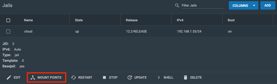

Click the < at the right of the jail to expand it. There will be a button for Mounts. You can choose various datasets outside the jail, and map them to paths inside the jail.

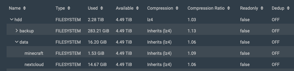

I looked for ways to do what you told me but I couldn't find them. Do you have an explanatory video/tutorial?
So these are the datasets on my HDD pool:

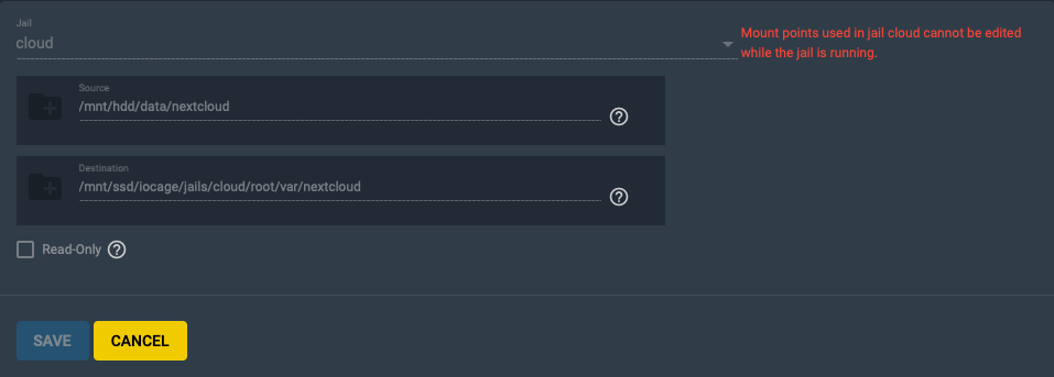

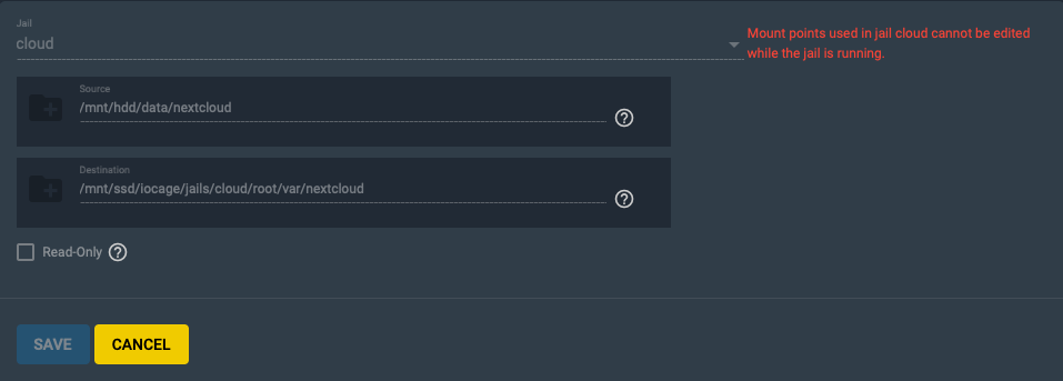

And this is the "mountpoints" setting for my Nextcloud jail:
Bildschirmfoto 2021-02-02 um 18.43.05.png Bildschirmfoto 2021-02-02 um 18.43.59.png
So the dataset /mnt/hdd/data/nextcloud - which lives on the "hdd" pool - is mounted into the jail living on the "ssd" pool at /mnt/ssd/iocage/jails/cloud/root/var/nextcloud - which happens to be /var/nextcloud when viewed from inside the jail.

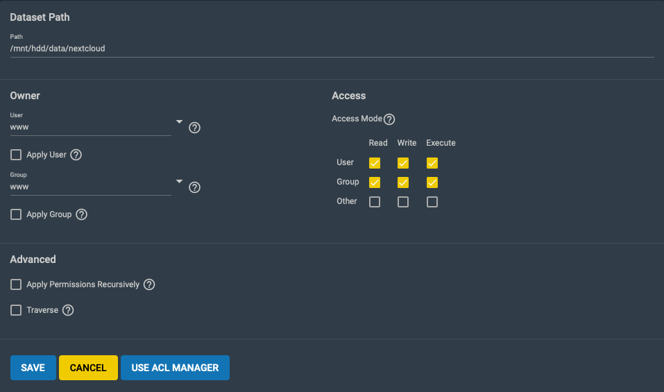

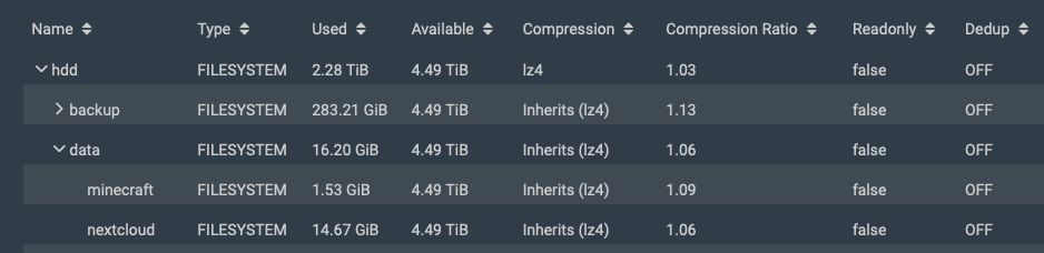

Just make sure ownership of the dataset is correct for your application. In the case of Nextcloud that is easy. Nextcloud runs as user "www" inside the jail and that user exists outside of the jail in TrueNAS, too, with the same UID/GID. So no additional magic needed, just change the user and group of the dataset using the "edit permissions" menu item:
That's all ... HTH,
