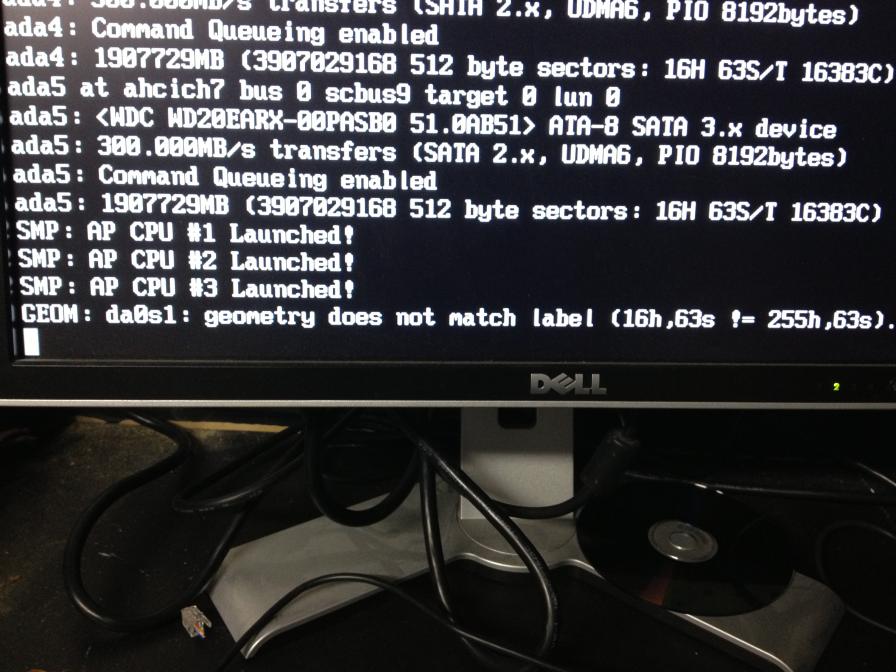

Yesterday, I restarted my FreeNAS box (running 8.0.4 RELEASE) via SSH (shutdown -r now) as I've done many times before. However, this time, the box did not come back online. I went downstairs to the box, fired up the monitor and noticed the following...
First, the boot was stalled at..
"GEOM: da0s1: geometry does not match label (16h,63s !=255h,63s)."
moments later, (roughly 10minutes later) the boot continued and then stopped at..
"Mounting local file systems."
and here it stops, nothing more...

Ok, I've taken some additional photos...
jgreco - Is your da0 a hard drive or the flash drive?
It appears that da0 is something else as all drives are listed (at least I think) as ada0-5, 6 drives total, maybe the flash drive? However, I don't think the issue is da0s1 and really the following error.
I wasn't able to see this error before as I wasn't verbose logging. This error will continue for 10minutes or so.
I'm assuming something is wrong with ada5, however, I'm not sure how to physically identify this drive. Secondly, why would FreeNAS refuse to boot if one of the drives failed, or am I missing something, which is totally possible.

Normally fatal trap 12 occurs when there's some problem with the memory-- try to look into that. Check if you've modified std memory timings in the bios or memory is a being faulty.
For ada5- try to check all physical connections first. To check, think you can try camcontrol -devlist (but this is only after you've booted in freenas.
Da0s1 is normal as this is the partition in your usb.

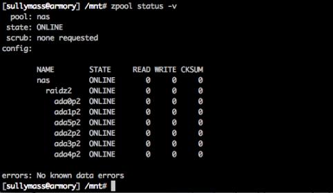

The drive has been replaced, resilvered, old drive detached, zpool scrubbed, zpool has been cleared. However, it appears that the GUI is not reflected an updated description of the new drive.

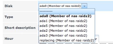

Any suggestions on how to get the GUI to reflect what seen in the zpool status? I've restarted the server about 3 times now, once after the resilvering, once after the scrub, and once after the zpool clear.

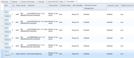

When I went to schedule a SMART test, the drive is also shown as "replacing" as does the GUI.
Thoughts?
Thanks in advance.
-Sully

Disregard. I figured it out.
I exported the pool and then auto-imported. I think this may of been a database error as the pool was intacts but the labeling was off.
