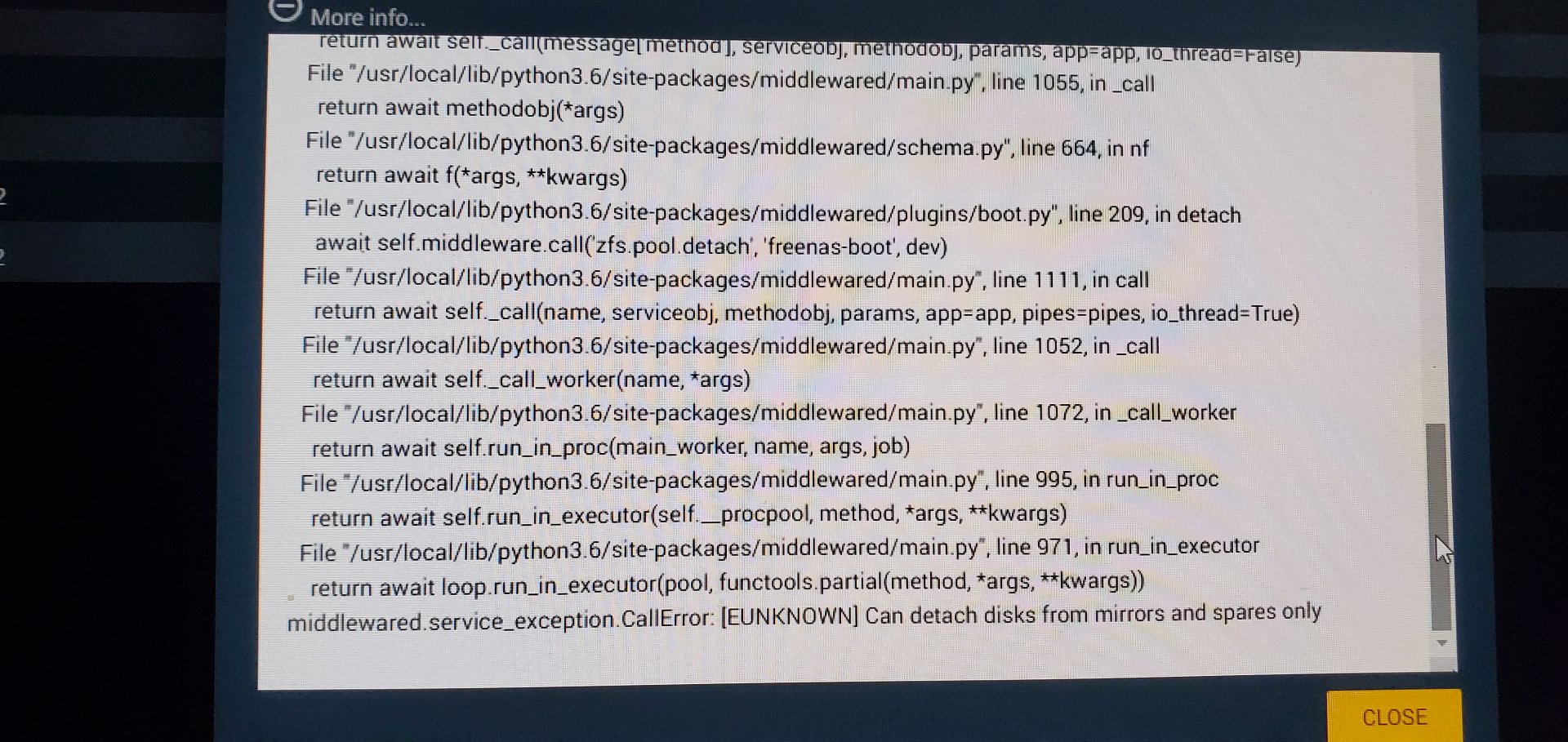

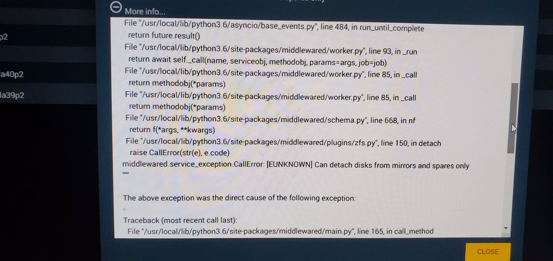

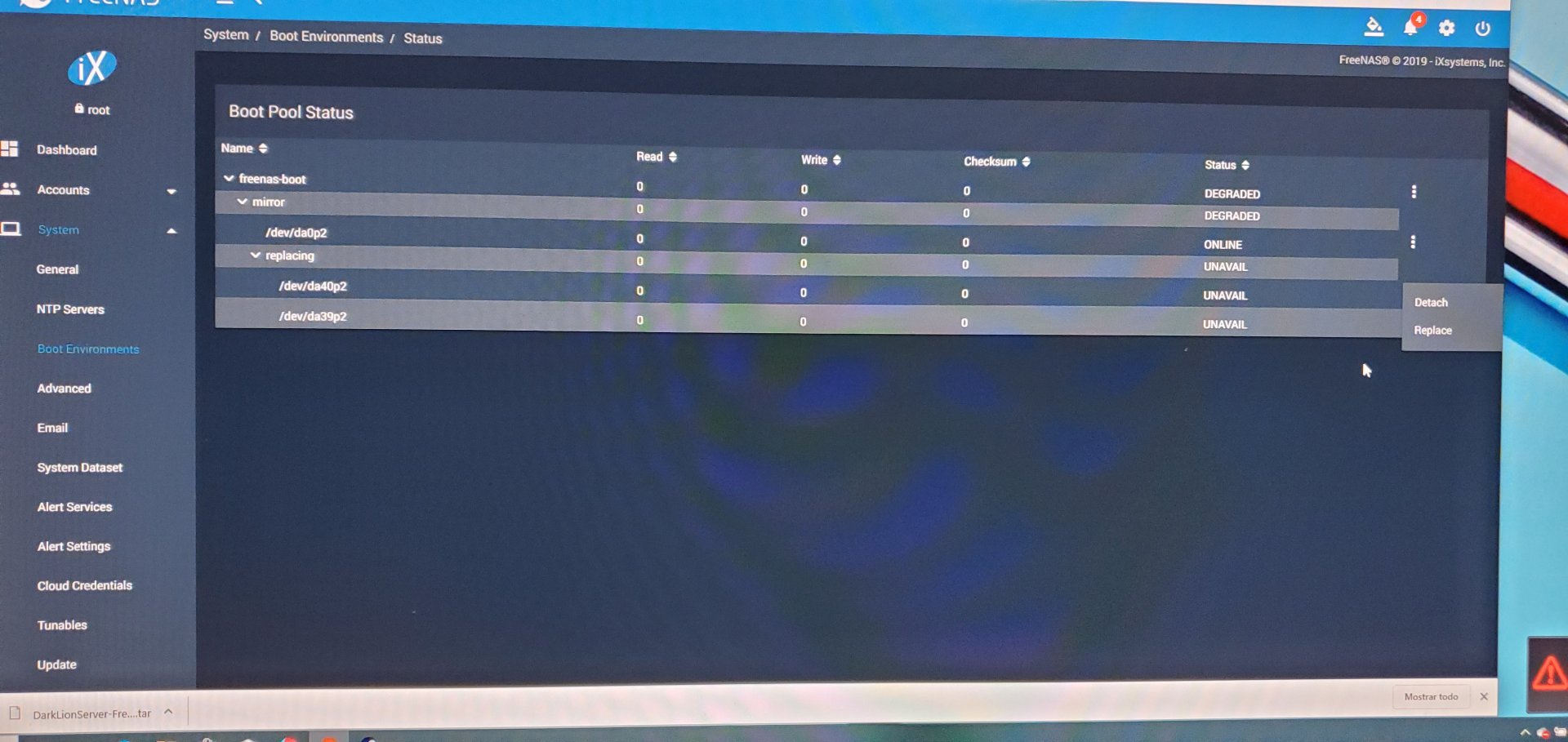

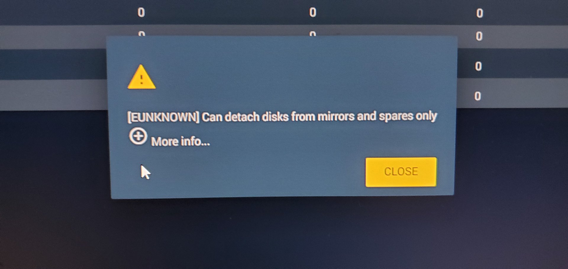

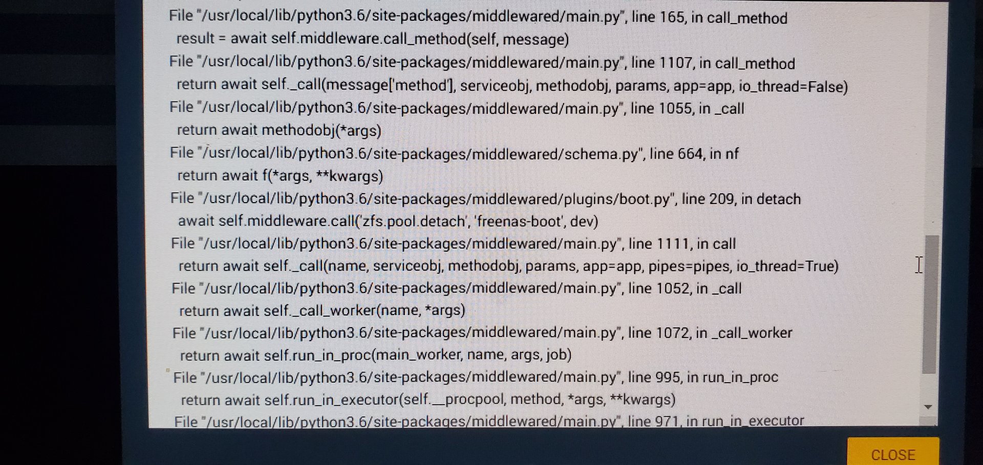

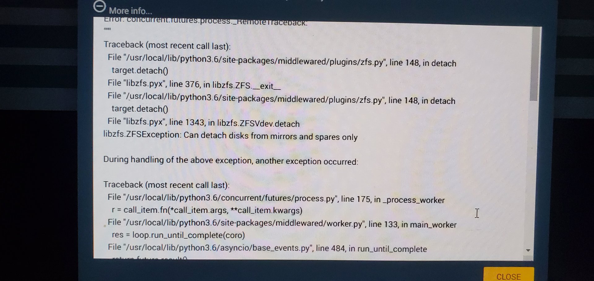

Well when on that screen of the boot environment and pool status I found this, I think the system fail to resilver one of the USBs somehow and now that the other usb and ssd is not present is still saying that is replacing and both, the origin and destination are unavailable.
Any suggestions on how to fix this?
Is not letting me detach or replace neither of those 2 disks and well, they both are screw anyway.

Ok, I want to update as I was able to finally fix it. As I said before my Dell r910 is not booting anything on UEFI mode just only BIOS, As My FreeNAS was installed on UEFI mode I couldn't boot any USB or SSD I had, So I went back to my other Dell r510 and on there I was able to boot on UEFI and make a configuration file backup. I installed the 11.2-u6 and u7 but I was never able to import my pools, I honestly didn't try with the configuration backup file because I saw that there was the 11.3 available, so I went to try that one hopping that this new version will worked better.
So this move paid up as this new 11.3 did let me import my pools and after uploading the backup file, everything came back to nolmar as I had it before, so I will be getting rid of those other USBs that where giving probles with the resilvering.
