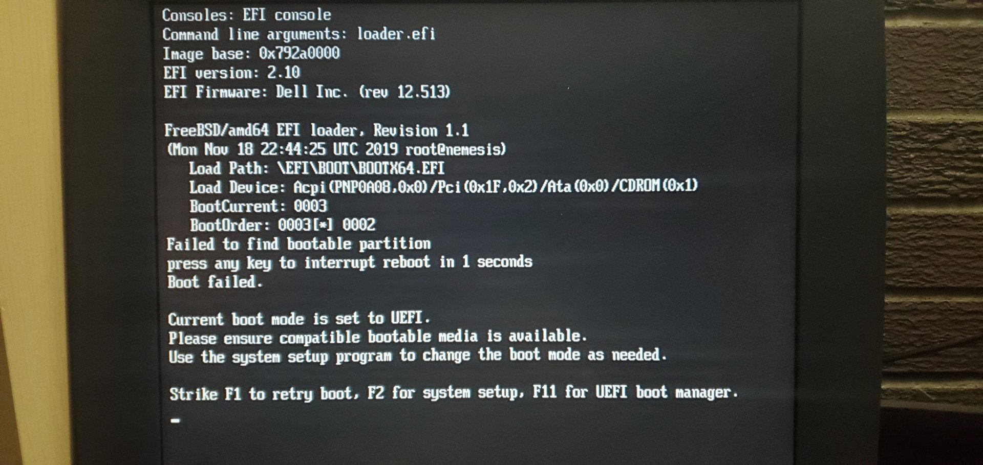

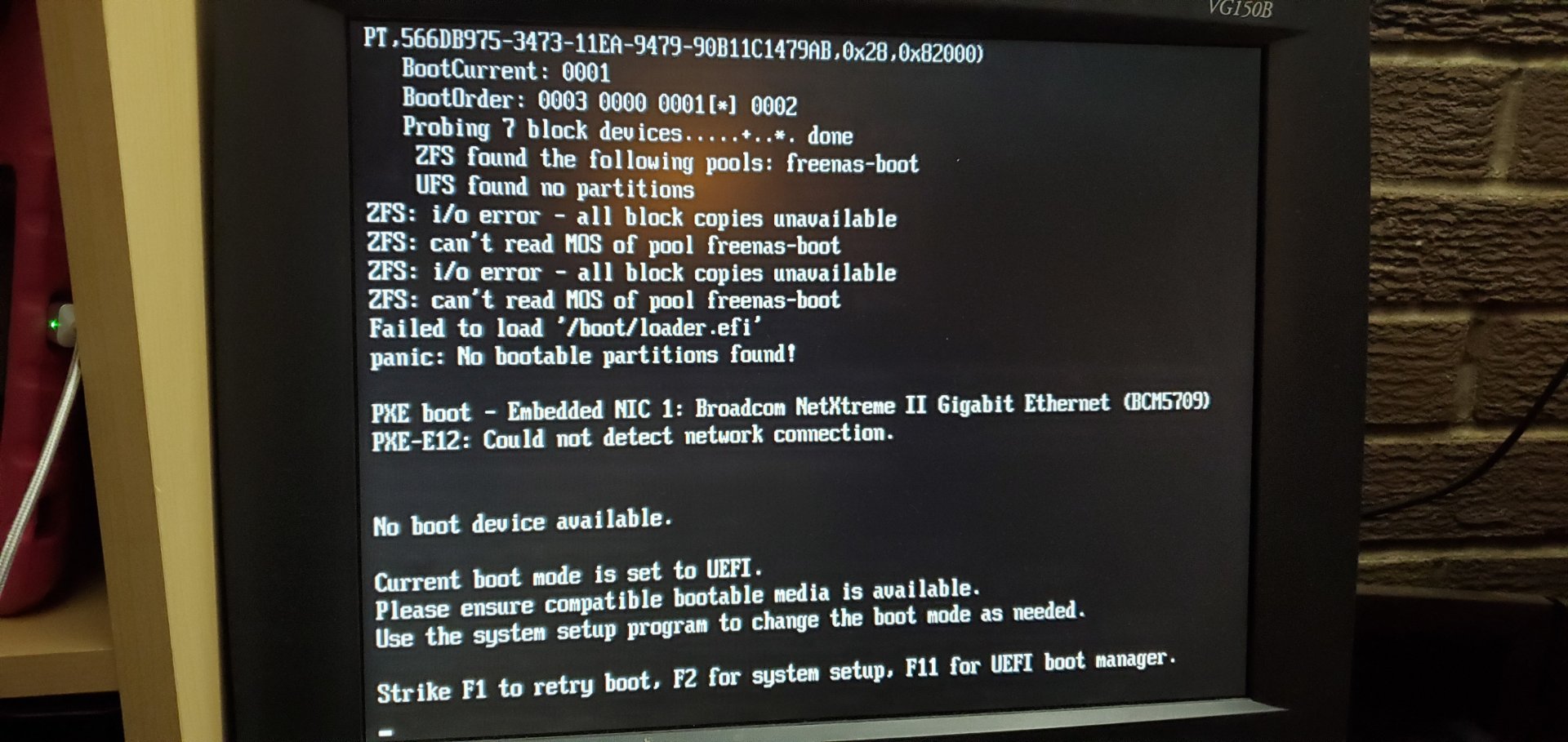

For some reason my system got frozen and I just turn it off and then started it again. But when I did this it won't start anymore. I think somehow the 2 USBs I had for the system got corrupted because is telling me that there is no device for booting. I am attaching screenshots so you can see that even though I try on UEFI (witch is how it was installed) and BIOS mode it just won't boot.
Is there a way to recuperate the system like windows does? I have 3 pools with like 15 terabytes of information that I don't want to lose.

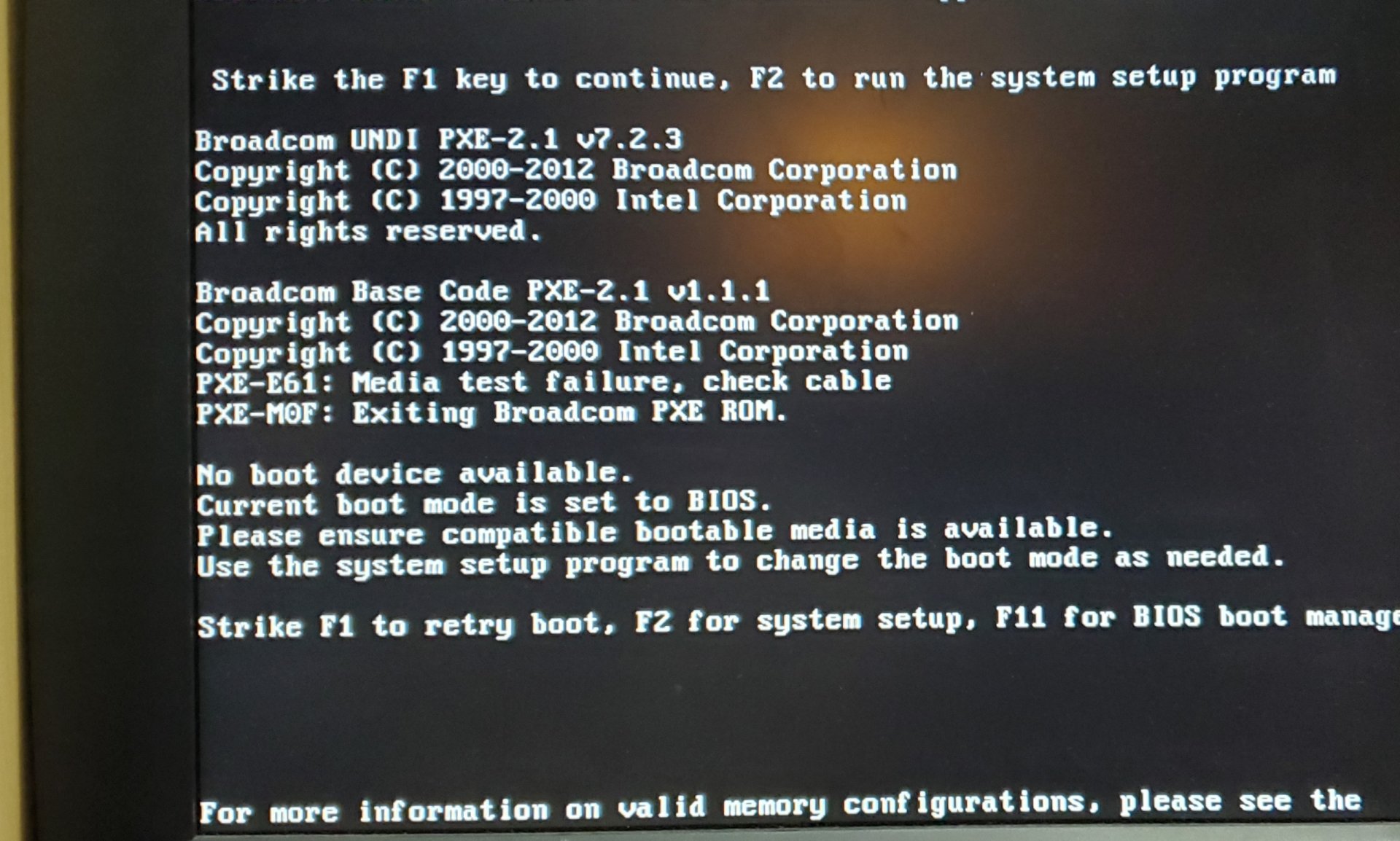

Well, now I think there must be something wrong with the server as I try the other 2 ssd's and then I try to boot the CD to reinstall FreeNAS and I still got the same issue of booting and like no booting image found.
Any thoughts on what could be wrong on my server? I am kinda on big dark age here lol, I have never had a problem trying to boot a CD.

I think you still don't get what I am trying to say. Remember how the installation of the FreeNAS works? How it first ask you if you want to installed it on BIOS of UEFI mode?
I think we already establish that we can change that configuration inside the BIOS to boot an operating system through BIOS or UEFI mode. Well when I installed the FreeNAS, I did it on UEFI and not BIOS mode, so the inside the BIOS the boot loader has to be set on UEFI to be able to boot the FreeNAS I have installed either on my USBs or ssd's. But the problem here is that my BIOS won't boot anything on UEFI, just on BIOS mode so it won't boot any of the USBs or ssd's cuz the 4 of them are on UEFI and the BIOS won't boot on UEFI anything, not even the CD or USB to reinstall FreeNAS. The only way I have to boot the installation disks is using BIOS mode.
So I reinstall FreeNAS on another USB using BIOS mode, I connect the disks and make sure all of then shows on storage-disks, then I go to storage-pools-add-imports and on the pop up menu doesn't appear any pool able to be imported. I am using 11.2-u7 by the way.

well .. do you have your boot device set correctly in the BIOS?
And yes, they are correctly chosen and even I have try hitting F11 and go to the boot menu where I can choose where to boot from, if the boot mode is on UEFI, regardless if I choose a CD, usb or anything it won't boot anything, it has to be on BIOS mode to be able to boot something.
