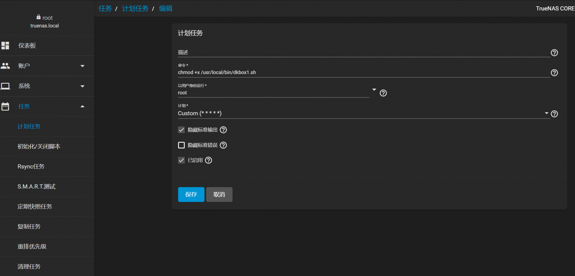

Please screenshot the cron task settings and post them here.
dktech
May 30, 2019
69
9,703
OK, so there's your problem... you're not running the script, you're marking it as executable (chmod +x)
First, in a shell, run /usr/local/bin/dkbox1.sh
See if there's any output (and if it beeps).
If it's OK, change the cron task command to /usr/local/bin/dkbox1.sh

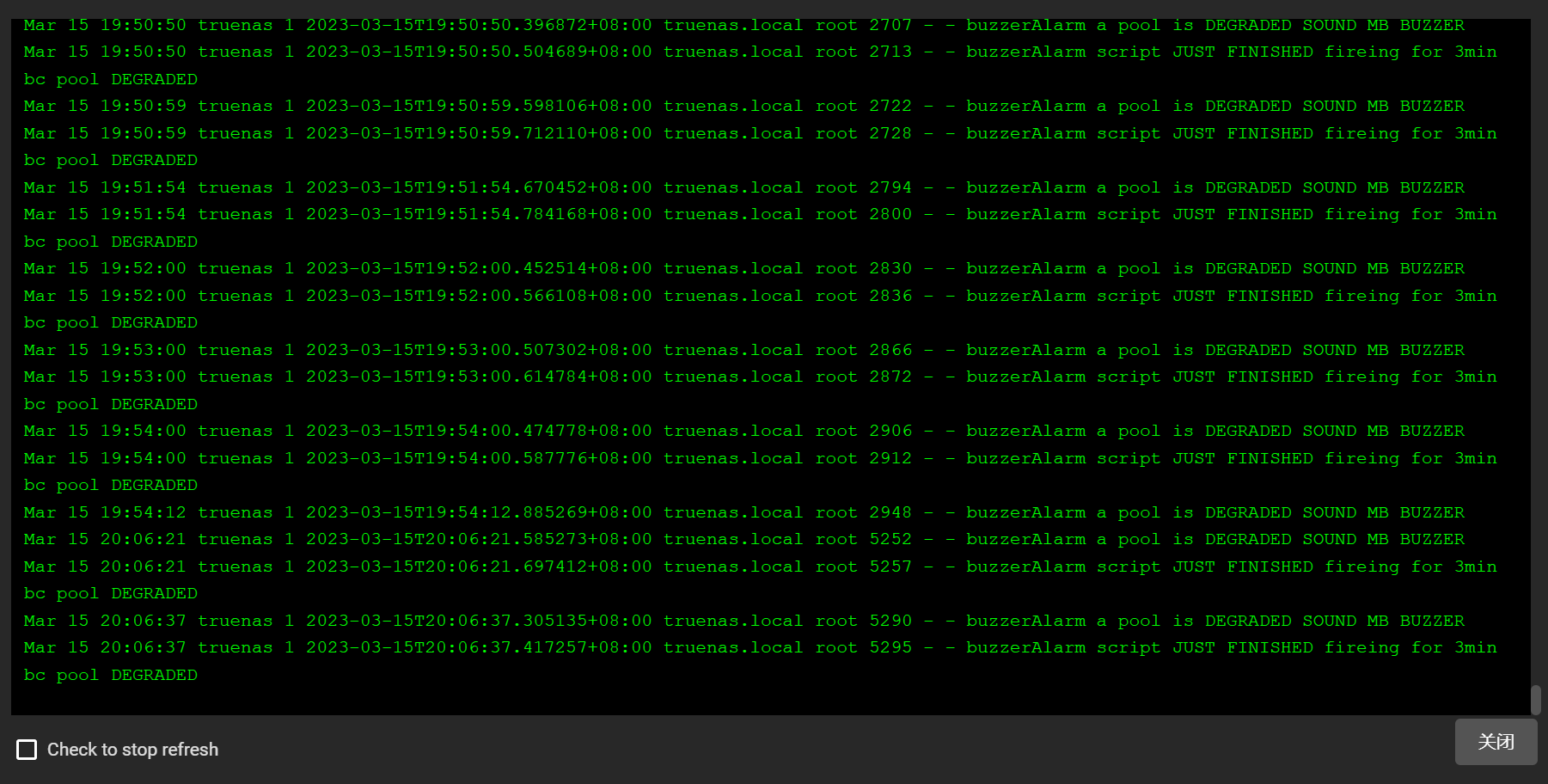

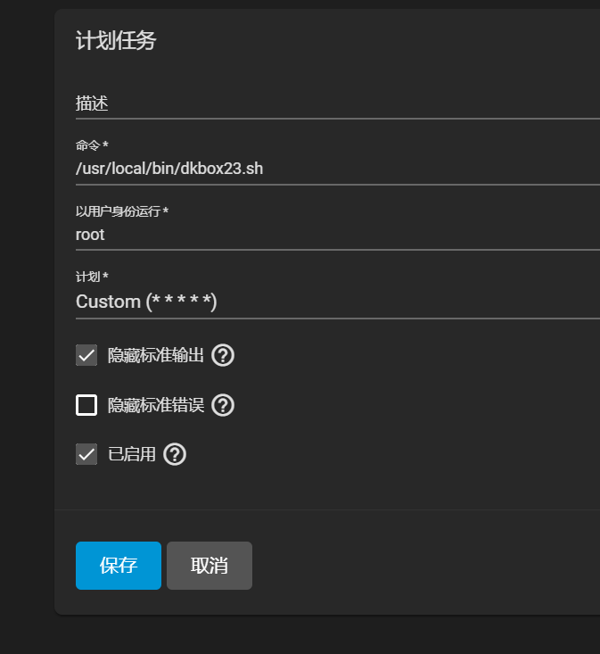

Now the script can already run, I don't know why every time I create a script file, the pasted content always lacks the first letter of the first line and the second line. But now the script will only beep once every 1 minute after running, and will not make continuous sound.

Try changing the cron task to run /bin/bash /usr/local/bin/dkbox23.sh
9,703
If that script is going to run every minute and last 3 minutes, you are going to have problems though.
