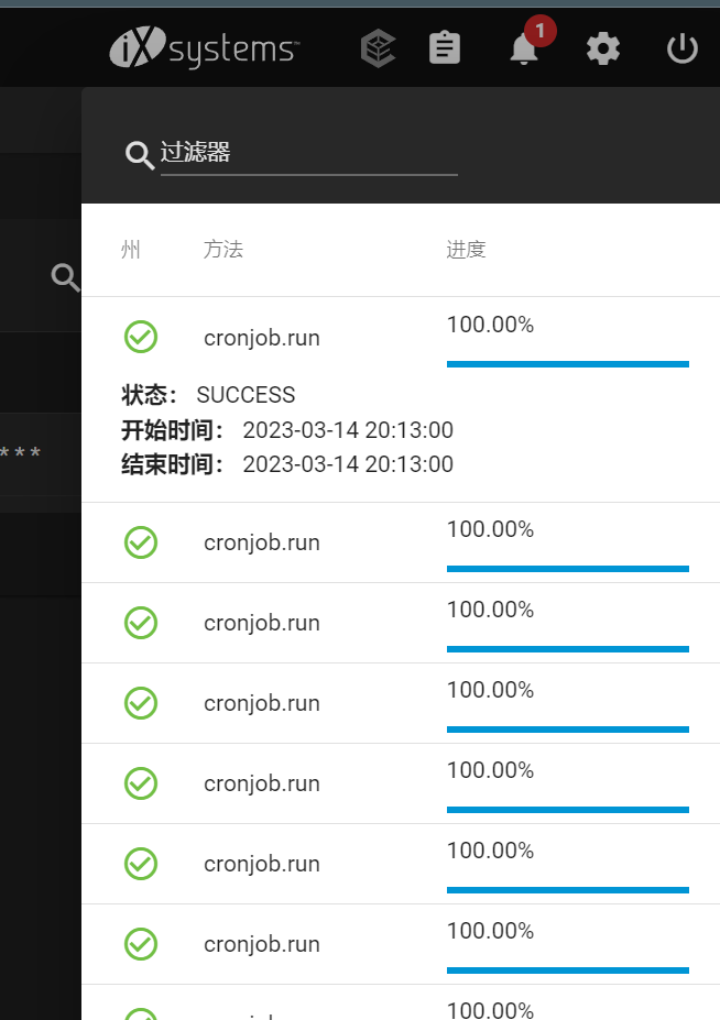

I have created a script file called dk.sh in the pool and added it to execute every 1 minute in the scheduled task, the task also runs successfully, but the buzzer doesn't sound when the pool is degraded. When I use printf "\007" > /dev/ttyv0 to test, I can hear the sound.
Excuse me, where did I go wrong?

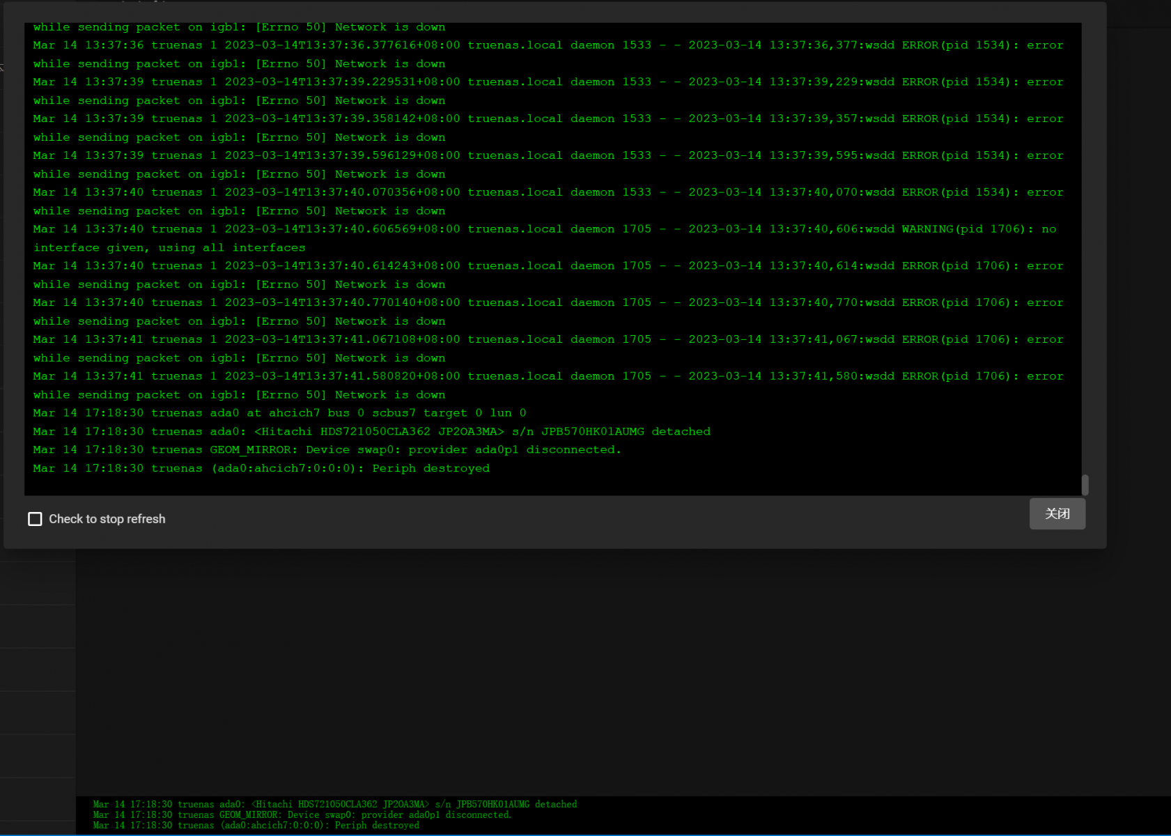

Do you mean these places?
No.
In the same shell where you had tested the printf command, run the script like ./script.sh (whatever you called it)... then see on that same shell screen what comes out.
