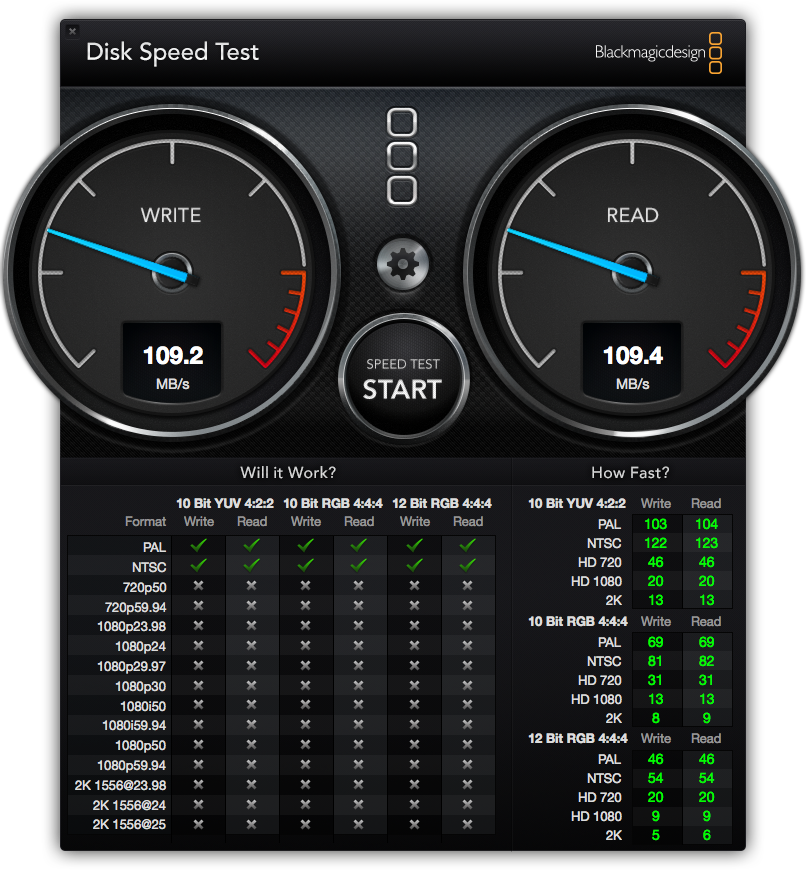

Hey guys,
I just did a quick benchmark on my FreeNAS system and thought I would shared it with everyone. I used my imac which has a SanDisk Extreme II 480GB SSD (therefore would out perform the NAS).
My current configuration is as follows:
FreeNAS-9.1.1-RELEASE-x64 (a752d35)
Supermicro X10SLM-F Motherboard
Intel(R) Xeon(R) CPU E3-1220 v3 @ 3.10GHz
32GB ECC Ram
6 X WD Green 3TB in RAIDz2
According to "Disk Speed Test", I am getting:
109.2 MB/s Write
109.4 MB/s Read
This is using a AFP Share.
Not sure how accurate this program is but seams quite accurate after testing and few other drives such as a USB2.0 external HDD etc.
With these speeds, it is possible I am maxing out my LAN connection (Gigabit network = 128 MB/s theoretical - I will confirm later whether my iMac is using cat5e or 6 - but my iMac to router is cat6 ) to the FreeNAS, so I wondering if I setup Link Aggregation (LACP) if these speeds will increase or stay where they are.
I am quite happy with these speeds as most people would be but I kind of expect that from this machine after all it cost quite a bit. However, totally worth it :).
Link aggregation will not do anything for you, unless you have several clients using the server at once. Also, GbE requires Cat 5e (for relatively short runs, not the whole 100m that does require Cat 6).
If those numbers are accurate, you're maxing out your connection (keep in mind there're several layers of overhead).
How won't Link Aggregation help increase speed (if the drive's aren't maxing out that is and LAN is the bottle neck). Are you not confusing this with Load Balance?
Also theoretically, even though you are using a Gigabit switch you are generally not quite getting those speeds at the switch due to losses in the cable etc (even with less then 100m runs). Using a Cat6 cable should potentially get you as close to the Gigabit speeds at the switch. I am sure that the differences would be very small. Still worth the thought. I will do some tests and actually see if there is a difference when I get a chance, would be interesting to know.

To answer the OP question in the first posting, I do not believe LACP will gain you any benefit unless you do a full implementation of it (special hardware required) and you are correct that your NIC is the limitation.
Yes, I am in the process of getting a SRW2024 cisco switch that support LACP. I don't need the extra speed or anything but I do need a larger switch which I can get cheap that supports it so, thought I would give it a shot. I won't be disappointed if I don't gain any more speed. More curious than anything.
Cheers
Don't expect any significant (as in beyond random fluctuations) changes moving from Cat. 5e to Cat. 6.
If you use LACP, clients get distributed to the various interfaces available. You can't trivially send data from two interfaces to two interfaces on the same client. You also need compatible networking hardware between the server and clients. I believe the latest SMB version included in Windows Server does have some black magic that allows such a setup, but it's the only such solution at the moment, to my knowledge.
Link aggregation (with the proper 802.3ad LACP) speeds things up when you have many connections hitting the same server, but does nothing for a single connection, which will max out at the top speed of one of the member links.
The exception is SMB3 (which is only Windows 8+). It splits traffic over multiple connections so a single transfer can take advantage of multiple links. Pretty cool stuff actually.

He is probably referring to the intellipark issue. I thought the same way you did at first, but 2-3 years of regular use seems to be all it takes to get the head park count up to 300,000, which is the stated top limit for the green drives.
ahh ok. Yeah totally, missed that. looking at a few things online, wd has a utility to disable this intellipark feature. I will check to make sure it works on my HDD if so will just disable it.

doing a bit of google wd released a firmware utility where you can disable the intellipark. therefore should make it similar to a wd red.
I wrote a very detailed how-to on the whole problem as well as how to solve it... It's in the guides section of the forum if anyone is interested.
