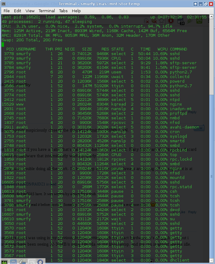

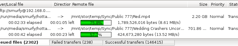

hello all, i was hoping for some in sight. i've got a pretty awesome server but it's seemingly running very slowly maxing out at 11MB/s transfer.
observations: (all speed is over sftp)
-typical transfer from ssd gigabit lenovo laptop to mac mini over lan with sftp yielded ~50MB/s
-expanding 1st array with 4tb hdds array r/w is stably maxing usb2 data source ~25MB/s
-pool degraded with 5x1tb raidz1 + 5x4tb raidz1 (i.e. raid50) still ~25MB/s
-new pool, swapped 1tb hdds for 4tb models, 10 exact hdds in raidz2 ~11.5MB/s (scrubs 183-281M/s)
next steps:
-try fresh image of freenas 9.1.0rc2 x64
-zil & l2arc on usb/ssds/pcie? home use would be great to have +50MB/s over gigabit lan to usb3
goal = all data in once redundant device, low $/energy/noise, media streamer & backup/share server
hardware:
-cat5e wired, gigabit lan ports / switch / & router rj-45 are 50ft, same speed on 6ft lengths or direct connection
-pcie: lsi 9211-8i HBA, nic (dual port non aggregated) supermicro AOC-SG-i2 NIC
-AMD PHENOM II X6 1045T (cpu load is rarely touches 25%)
-FreeNAS (newest) on 16gb lexar usb 2.0 flash drive
-16gb (4x4GB) ddr2-5300 (passed 8hrs of memtest)
-430w antec earth watts psu, mother board asus m4a78-e bios v.2603
-case old lian-li mid-atx, two icy dock 5in3 MB975SP-B
-raidz2 [10 x 4tb Seagate 4TB NAS ST4000VN000]
-nas is backed up via usb2 external hard drives using sftp, changing soon to usb3
zfs config:
-autotune enabled, lz4 compression (other settings no effect)
-dedupe off, atime off, hdd sleep 30 min, acoustic level: med, power level: 127=intermidiate w/standby
-smart (long & short) passes every 7 days, auto scrub every 10 days
-snapshot every 15 min. held for 6 weeks
-i previously had an issue retrieving data so i disabled the ashift so i undid that first.

If its at 25% that sounds like you might be limited to a single threaded application. Also, 11MB/sec sounds suspiciously close to the theoretical limit for 100Mb LAN.
I'd check the cable and your link speed. Something tells me you are 100Mb sometimes and not knowing it. If you have a cable that's flaky you should just replace it. Flaky hardware should just be discard and replaced. It's really not worth the hassle later when you are having unexplained issues because of hardware that intermittently works properly.
Edit: Didn't do the math in my head.. 25% is probably not a single threaded app, but that CPU may have trouble doing all the work. I'd look at top and see if any threads are hitting CPU usage that is at 7-8%. If they are, that's an indicator of a thread that's CPU-bound.
papageorgi
Jul 16, 2013
51
hello again cyberjock, thanks for responding. that's what's so strange, i'm using all the same hardware that i was using in my previous freenas settings with the exact hardware. the only difference was just a moment after using two raidz1 that were mirror to going to raidz2 i saw this. it's all gigabit lan, but i know i would be limited by the usb2 connection the hard drive is using to transfer data. i've for a year have been seeing 22-30MB/s using FileZilla on my linux laptop. and my cpu is almost always idle.

[smurfy@nas] /mnt/stor/temp# uname -v
FreeBSD 9.1-STABLE #0 r+1a51513: Thu Jul 25 09:39:42 PDT 2013    root@build.ixsystems.com:/tank/home/jkh/src/freenas/os-base/amd64/tank/home/jkh/src/freenas/FreeBSD/src/sys/FREENAS.amd64
[smurfy@nas] /mnt/stor/temp# arc_summary.py |more
System Memory:
        1.02%  160.89  MiB Active,    0.88%  139.29  MiB Inact
        53.85%  8.33    GiB Wired,      0.01%  1.14    MiB Cache
        44.25%  6.84    GiB Free,      0.00%  672.00  KiB Gap
        Real Installed:                        16.00  GiB
        Real Available:                99.68%  15.95  GiB
        Real Managed:                  96.97%  15.47  GiB
        Logical Total:                          16.00  GiB
        Logical Used:                  56.37%  9.02    GiB
        Logical Free:                  43.63%  6.98    GiB
Kernel Memory:                                  8.02    GiB
        Data:                          99.72%  8.00    GiB
        Text:                          0.28%  22.71  MiB
Kernel Memory Map:                              10.66  GiB
        Size:                          74.60%  7.95    GiB
        Free:                          25.40%  2.71    GiB
                                                                Page:  1
ARC Summary: (HEALTHY)
        Storage pool Version:                  5000
        Filesystem Version:                    5
        Memory Throttle Count:                  0
ARC Misc:
        Deleted:                                240.21k
        Recycle Misses:                        10.03k
        Mutex Misses:                          3
        Evict Skips:                            3
ARC Size:                              80.53%  7.94    GiB
        Target Size: (Adaptive)        80.53%  7.94    GiB
        Min Size (Hard Limit):          12.50%  1.23    GiB
        Max Size (High Water):          8:1    9.86    GiB
ARC Size Breakdown:
        Recently Used Cache Size:      97.75%  7.76    GiB
        Frequently Used Cache Size:    2.25%  183.39  MiB
ARC Hash Breakdown:
        Elements Max:                          99.58k
        Elements Current:              98.43%  98.02k
        Collisions:                            91.21k
        Chain Max:                              5
        Chains:                                15.06k
                                                                Page:  2
ARC Efficiency:                                95.42k
        Cache Hit Ratio:                97.39%  92.92k
        Cache Miss Ratio:              2.61%  2.49k
        Actual Hit Ratio:              96.47%  92.05k
        Data Demand Efficiency:        99.99%  30.21k
        CACHE HITS BY CACHE LIST:
          Most Recently Used:          24.00%  22.30k
          Most Frequently Used:        75.06%  69.75k
          Most Recently Used Ghost:    1.12%  1.04k
          Most Frequently Used Ghost:  0.00%  0
        CACHE HITS BY DATA TYPE:
          Demand Data:                  32.50%  30.20k
          Prefetch Data:                0.00%  0
          Demand Metadata:              65.61%  60.97k
          Prefetch Metadata:            1.89%  1.75k
        CACHE MISSES BY DATA TYPE:
          Demand Data:                  0.08%  2
          Demand Metadata:              45.77%  1.14k
          Prefetch Metadata:            54.15%  1.35k
                                                                Page:  3
                                                                Page:  4
File-Level Prefetch: (HEALTHY)
DMU Efficiency:                                6.32m
        Hit Ratio:                      80.31%  5.08m
        Miss Ratio:                    19.69%  1.25m
        Colinear:                              1.25m
          Hit Ratio:                    0.00%  0
          Miss Ratio:                  100.00% 1.25m
        Stride:                                5.08m
          Hit Ratio:                    100.00% 5.08m
          Miss Ratio:                  0.00%  4
DMU Misc:
        Reclaim:                                1.25m
          Successes:                    0.06%  689
          Failures:                    99.94%  1.24m
        Streams:                                365
          +Resets:                      0.00%  0
          -Resets:                      100.00% 365
          Bogus:                                0

hmmm maybe it was autotune needing more time? looks like it just bumped up to my normal speeds, maxing usb2 and awaiting my usb3 hard drive dock.

papageorgi
Jul 16, 2013
51
oh i'm sorry i wasn't clear. the usb drives are not in or part of the server anymore than just being a backup of the server is all. i've used the laptop to backup the server through ftp.
it seems it's now very much faster somehow. i think the auto tune kicked in suddenly, which is strange since it's had many days and also several restarts since...
my setup = freenas server with 10 4tb hdds -> gigbit lan -> ssd lenovo laptop with linux -> connecting via filezilla's sftp -> usb2 external hard drives to backup data
i do have a usb3/esata/firewire 800 drive coming from newertechnology to help partially remedy this and hopefully will see the transfer jump to at least 60MB/s. i know this isn't ideal i just can't afford the hardware to build another nas.
