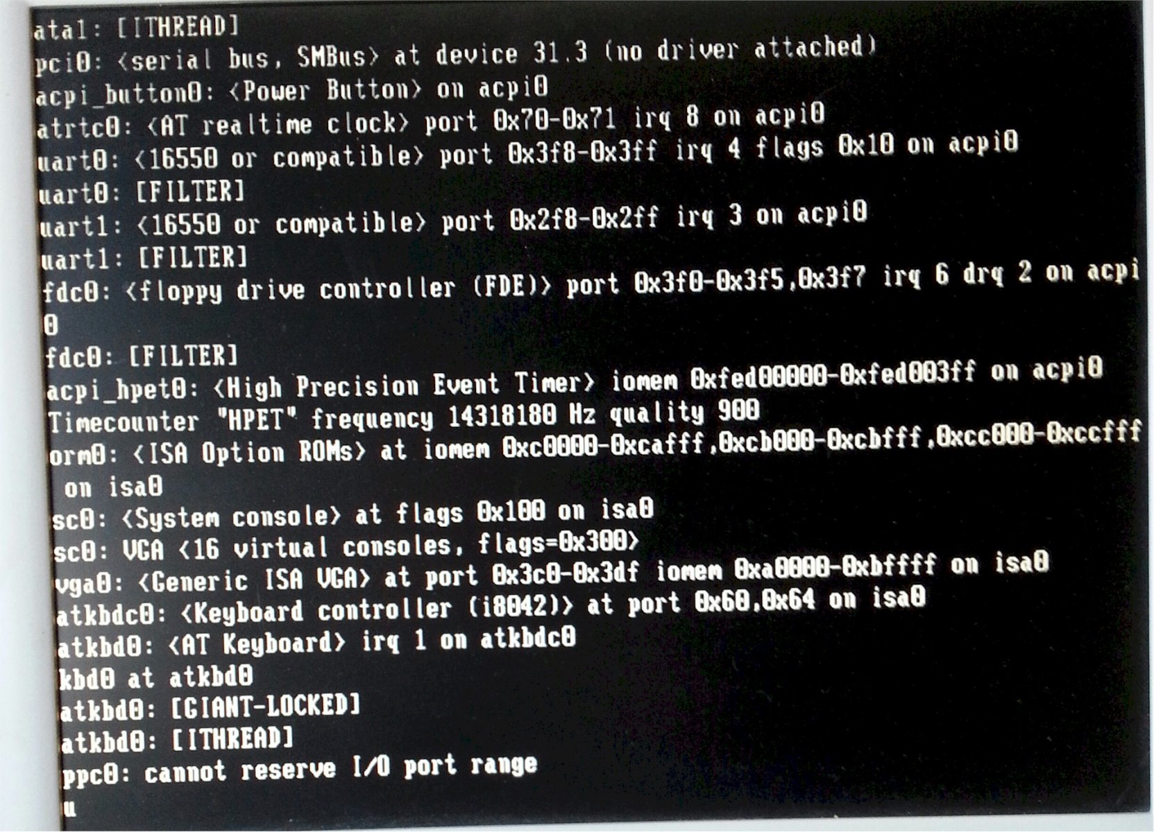

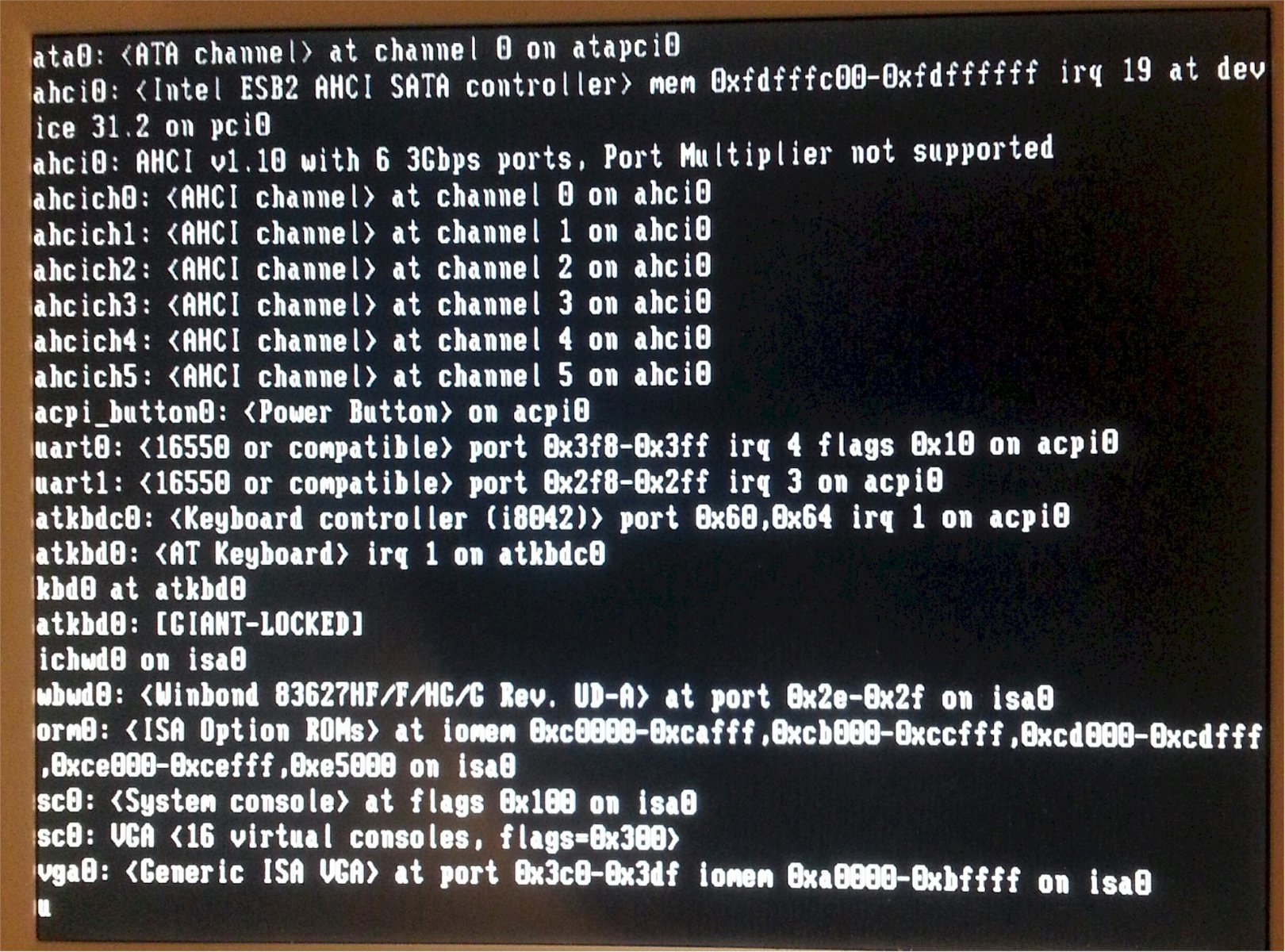

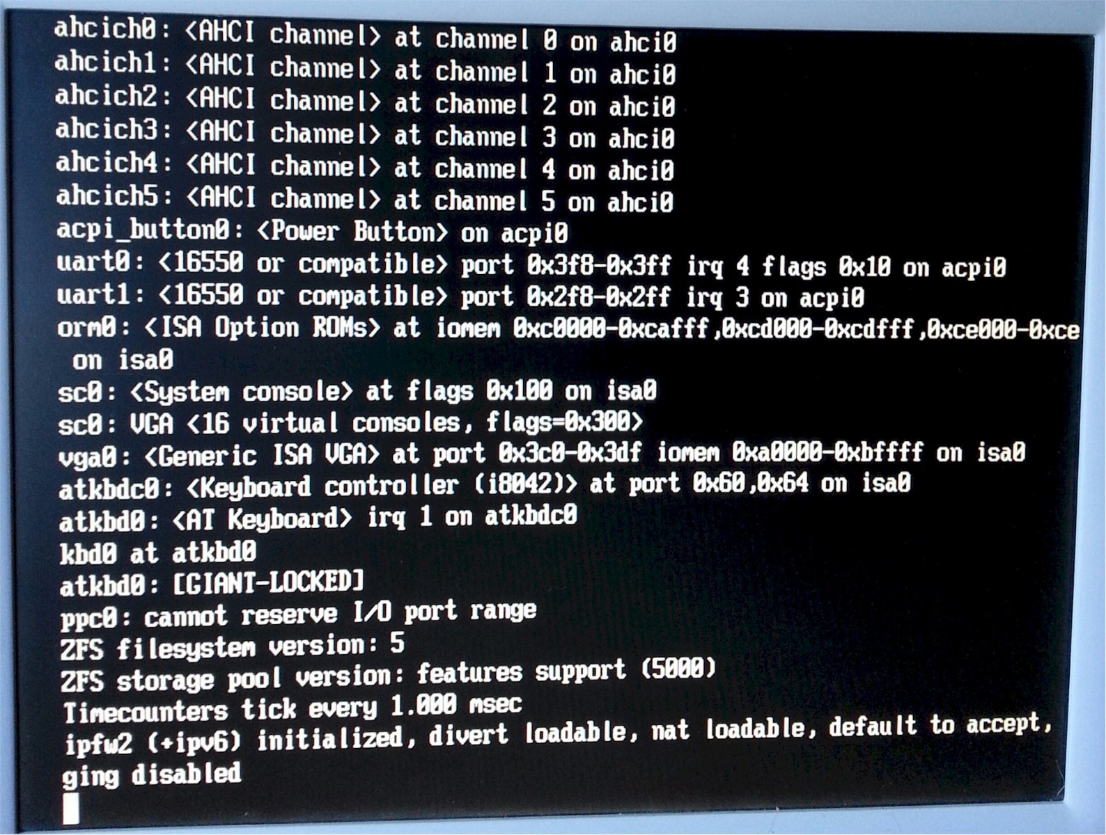

This was a working ProxmoxVE server with a FreeNAS VM using the HDDs as a RAIDz1 array. The machine worked beautifully, if you could overlook the 11MB/Sec R/W over Samba. So I pulled the Proxmox system SSD out and inserted the 9.3Beta Install CD and a blank USB key to be the new system drive, then I reboot and have this boot hang-up problem.....but if I reinsert the ProxmoxVE SSD the system boots fine and happily runs a VM of FreeNAS just fine.
I have also tried installing CentOS 6.5 and some version of Ubuntu on here since noticing this problem, but had no issues installing and both worked perfectly. That being said, I tried NAS4Free and had the same problem, but it is also another BSD based OS versus the others being Linux...for what it's worth.
The boot progression is this:
-Power on server
-wait ~50 seconds while MB waits to make sure RAID cards are up and running before detection
-watch Bios post which takes ~30 seconds including AHCI drive detection
-boots from CD and loads Grub
-choose the FreeNAS installer option from Grub or wait the few seconds for the installer to be auto-selected
-watch for ~30 seconds as many lines are displayed while the machine loads the installer
-the server locks up at one of the screens shown below somewhere in the neighborhood of 3 minutes after initial power-on
-If left alone, 5 or 10 minutes later the machine beeps as if it rebooted, but seems to be in a low power state I can't wake it up from.....I just cycle power or reset button to bring it back for another try.
This picture below is the most recent with only the base hardware, 6-HDDs attached to motherboard AHCI controller, 8GBUSB3MemoryStick attached directly to motherboard over USB2, Internal IDE CD Drive connected directly to motherboard, and the FreeNAS install CD.
Below is a list of the base hardware, then a list of other hardware I have tried while having either the SAME problem or a more significant problem, and finally a list of general parts I changed out at different times trying to find a solution.
