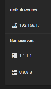

DNS are set up correctly both on my dhcp server and on the truenas machine, you can check the photos below.
as for the VM I had set up a static IP address with the correct default gateway and still couldn't access the wan, and on top on that you don't need default gateway to access the lan (as long as you are on the same network)

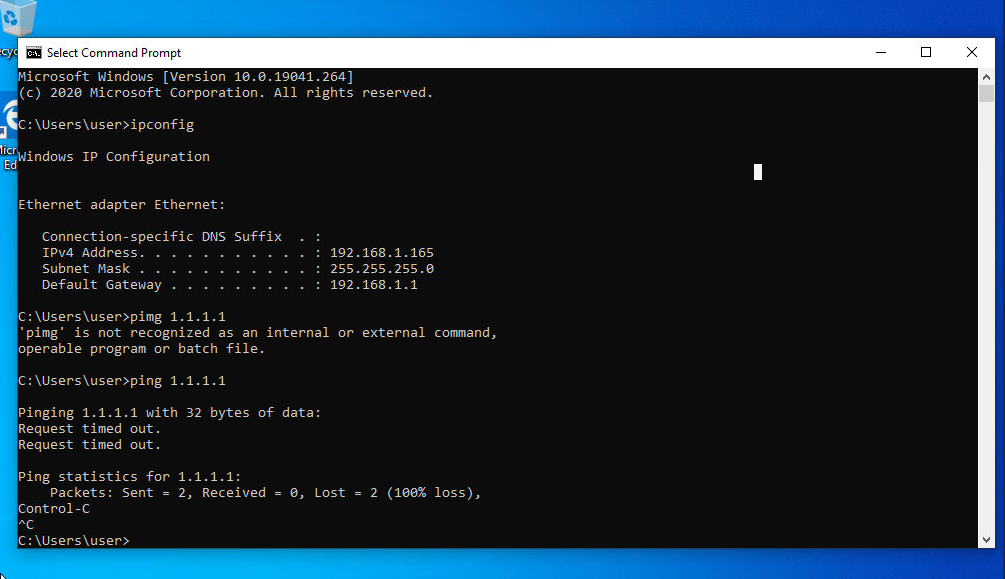

Please attach the output from Network->Network Summary. For your VM, are you using the e1000 or VirtIO driver?
notice:
I know that I have one APIPA interface, I have set it up manually, the RE0 is a 100MB interface that I use only for wake on LAN.
as you can see in the pictures I have attached, the virtual machine is connected through the UE0 interface which is connected to the lan and wan and I can ping public IP addressess and solve DNS names.
e1000 the VirtIO doesn't even show up on the os(probably requires a driver)
