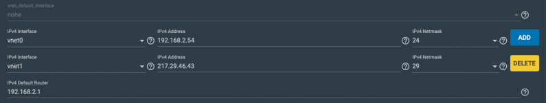

Perfectly safe. Iocage is the same subsystem the UI uses. And you can do exactly the same in the UI, actually you can view or edit the changes I suggested in the UI afterwards. It was just easier than producing a load of screenshots.
This is what the IP configuration section looks like after you created the interfaces - iocage or UI doesn't matter.
HTH,
