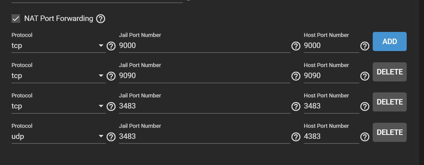

In a jail I have added several port forwardings.
Can I do the same in when creating the jail?
iocage create my_jail ......... nat_forwards="tcp(9000:9000) ........"
Can't seem to find any examples with several ports being forwarded.

Do an iocage get nat_forwards <jailname> on that jail with the port forwards created in the UI and probably you shall be enlightened :wink:

Thanks, that worked. Think even I was close but had spaces in the list.
