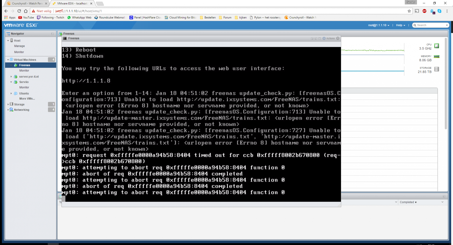

Hey, i have this timeout problem after like 2 to 3 days and when it happens i need to forcefully restart my whole esxi box because it wont shutdown the VM or itself anymore.
I have looked all over the forum and googled a lot but didnt find a solution. i followed this guide: http://www.freenas.org/blog/yes-you-can-virtualize-freenas/
Everything runs fine and fast but when this eror hits everything stops working. (all add a screenshot) (i fixed the update message, gateway settings have been updated and fixed)
I am running the free version of esxi so i cant pass through the pci cards but i dit RDM (raw disk mount) all the disks so it should be rather close to be running on real disks. From what i can find it has to do something with the hdd controller? (esxi is using LSI Logic parallel) and should be supported by freenas from what i can find.
I disabled scrub and made sure there is no write cashing. im guessing its some function that runs every few days as this is happening every other 2 to 3 days. the time in between everything functions as normal.
If there is someone with experience with this problem, please let em know how i can troubleshoot it or fix it.

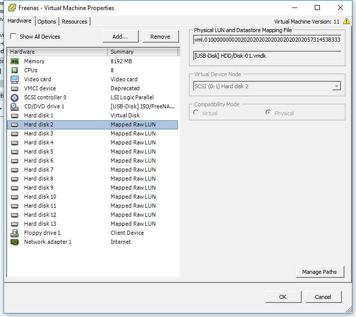

My current setup:
asrock C2750D4I as the motherboard with 32GB ram and 15 x2 TB, 3 of witch are external (cloned) via usb (going to be esata if i find a pcie card...) and the other 12 internal.
On the software side i have ESXI installed on the cloned 3 external disks. The esxi datastore is also on those disks. I have made RDM links from all 12 disks to the dataset so i can use them. Then i have a freenas VM (and some other VMs) witch has all the disks linked (see attachment for settings) and all the other vm settings. and then i have a fresh installed freenas with the settings i need for shares and stuff...
so all 12 internal disks are directly connected to the motherboard with no raid setup or anything, just 12 disks.
trying and changing to the new VM tools that freenas offers, i would like to try and do everything to get this working with esxi... its way faster then freenas was and it would be a hell of a task to convert my other VMs to a new system... I dont care so much about lerning a new VM system... usually i can adapt pretty fast
it could be a option to create vmdk files normally for disks but then i do need to know stuff works solid... as it includes copying and spreading out at least 16-18 TB of data to a lot of places (including friends and stuff over internet) it could be done but would be a task that takes at least 4 weeks to get it all done in safe ways...

So while I know you have desires to run everything on your machine, I do not believe it's capable to run properly using RDM. I believe the problem is that when using RDM then there is a Virtual Controller in between the VM and RAW device and this is causing the drives to drop out.
Also, in your screen capture it states that Hard Drive 2 is connected via USB, is that true? I was under the impression that your boot device was the USB drive and that all the RDM drives were via SATA.
I think you need to think about your next move as I'm unable to give you a solution with your given hardware. You really need PCI Passthrough to do this properly.
