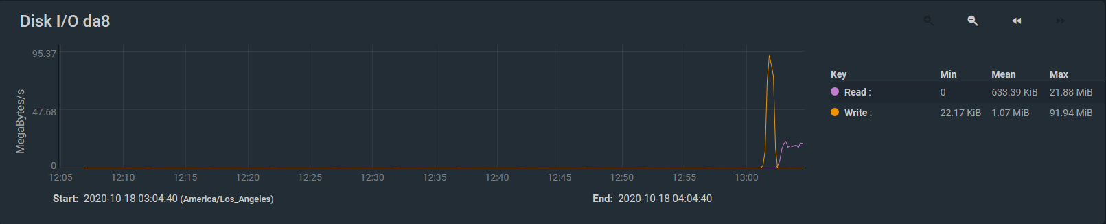

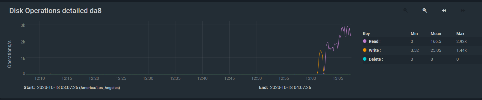

Here some statistics

I wrote "no vdevs" which is utterly nonsense as I found out. I have 1 vdev in each pool and that is the dataset I setup as described before.
