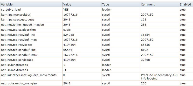

There's just no way to flog more speed out of 6Gb/s SATA3/SAS2 hard drives, but there are some things you can do to improve performance: use mirrors instead of RAID-Z2, use jumbo frames (some will scoff at this, but it made a big difference for me), and set some tunables:

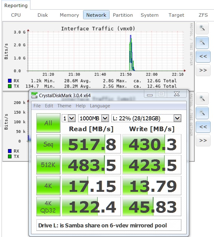

I've done all of the above and the best I can get for network transfer rates is ~3Gb/s. Here are CrystalDiskMark v3.0.4 results from my PC accessing a Samba share on my main FreeNAS server, along with the server's interface traffic graph:
Hope this gets you started... good luck!
