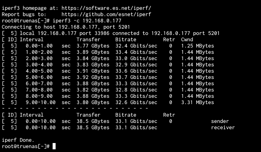

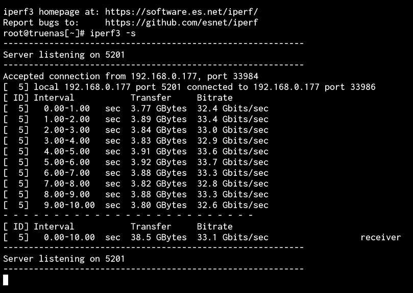

I used two ways, because unfortunately I don't know if they are different when testing. I just hope that should fit.
I think this iperf test if from the NAS to itself... 33Gbit/s, but not going over the LAN
You need to test to/from a NAS client.....
Then we'll see what that USB network adapter really does

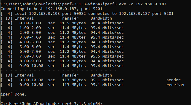

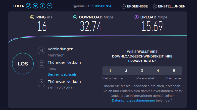

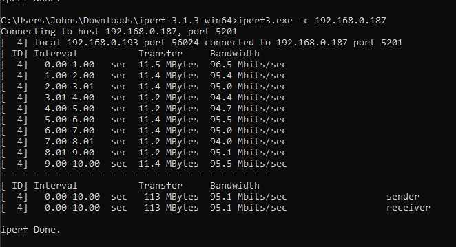

Ok, sorry. I read again afterwards and learned a little more and also understood what you meant exactly. So that I should run the test from my computer with the NAS. I have now done the test from my Windows 10 computer and have really low speeds if I interpret this correctly. But I have good speeds in a normal speed test both from the Nas and from the computer, or am I wrong?

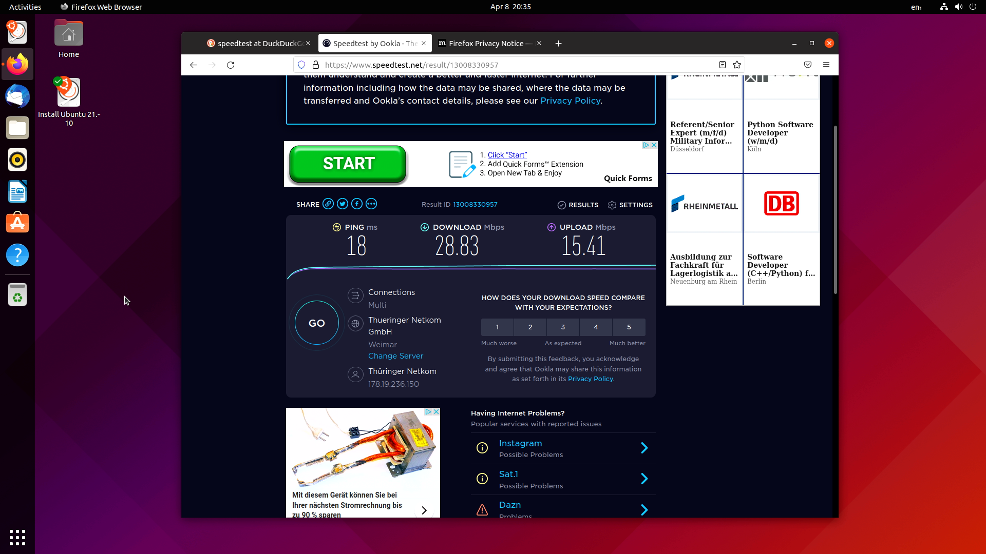

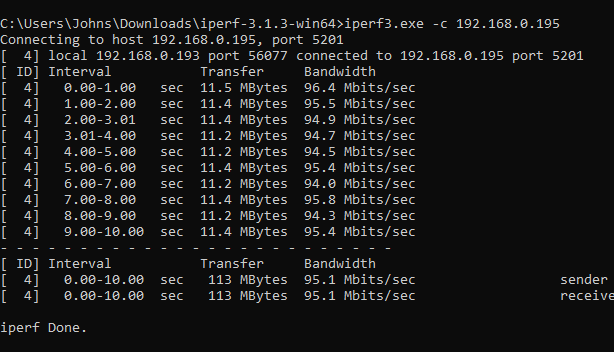

I have now also compared it again from an Ubuntu Boot Stick with the Internal Lan and the Lan Adapter of the Nas and apparently both are similar. And for whatever reason I can't use my internal Lan, even if I haven't connected the adapter and only the normal Lan cable.
So these tests seem to indicate that the max network speed is about 11MB/s = about 100MBit/s
I think that is the limit of the USB stick to its switch?

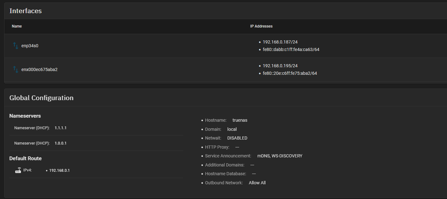

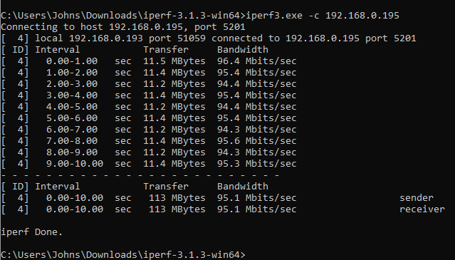

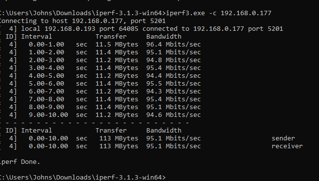

That was also my guess. I completely reinstalled TrueNAS today, because I had already thought that my normal Lan port did not work, last time. After the fresh installation, both were shown as available under the Network tab and I was able to open the web interface from both, but the speed is just as slow for both. I have the Lan port on the Nas directly on the router, but the adapter still on the Lan Switch.
And thank you again for your help and thought-provoking examples
  • iperf Speedtest on Win10 to TrueNAS with LAN-Adapter (conect to Switch).PNG

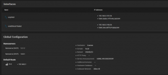

Ok, after another test it turned out that if I connect my computer to the router and connect my NAS to the router without an adapter, there are no more problems...
I feel stupid. I'm going to look for a New Lan Switch.
So now I'm about 1000mb/s(~950Mbits/sec).bin satisfied. Thanks again.
