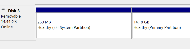

@entilza72 if you can boot from the same mobo it would not be the bios issue. The data disks have no boot loader hence will not boot. Is your bios working well ? To check just go into it & see if settings have changed or some features acts funny, in which case need a bios flash ya.
I've swapped the USB ports, tried a third port, swapped both sticks, changed their boot order, tried with 1 stick (each) in different ports. All no good.
swapping the USB's into a laptop or friend's and assuming Windows go to Create and format hard disks partition to see if the USB's appear with a Freenas like partition (screenshot).

i don't have mirrored USB but i religiously back up the config once there are changes (even if there isn't). Perhaps due to the power shock it may. If you have the config then all is saved, just install into a new USB and upload, it will re boot and appear like it was 5 minutes ago (need to change the IP's at console ya).
If no config then fresh install and import the pool via GUI, you will still get back your data. Few weeks ago a good fellow @PhiloEpisteme showed me how to export and import pool, data was intact but i had my ori config. It should work in your case.
I mounted both sticks in a Win 10 machine and checked the partitions. Both only show as one large partition. Cooked?
1kokies
Oct 7, 2017
138
looks like it, there should be a UEFI/EFI partition as per screenshot above thread
