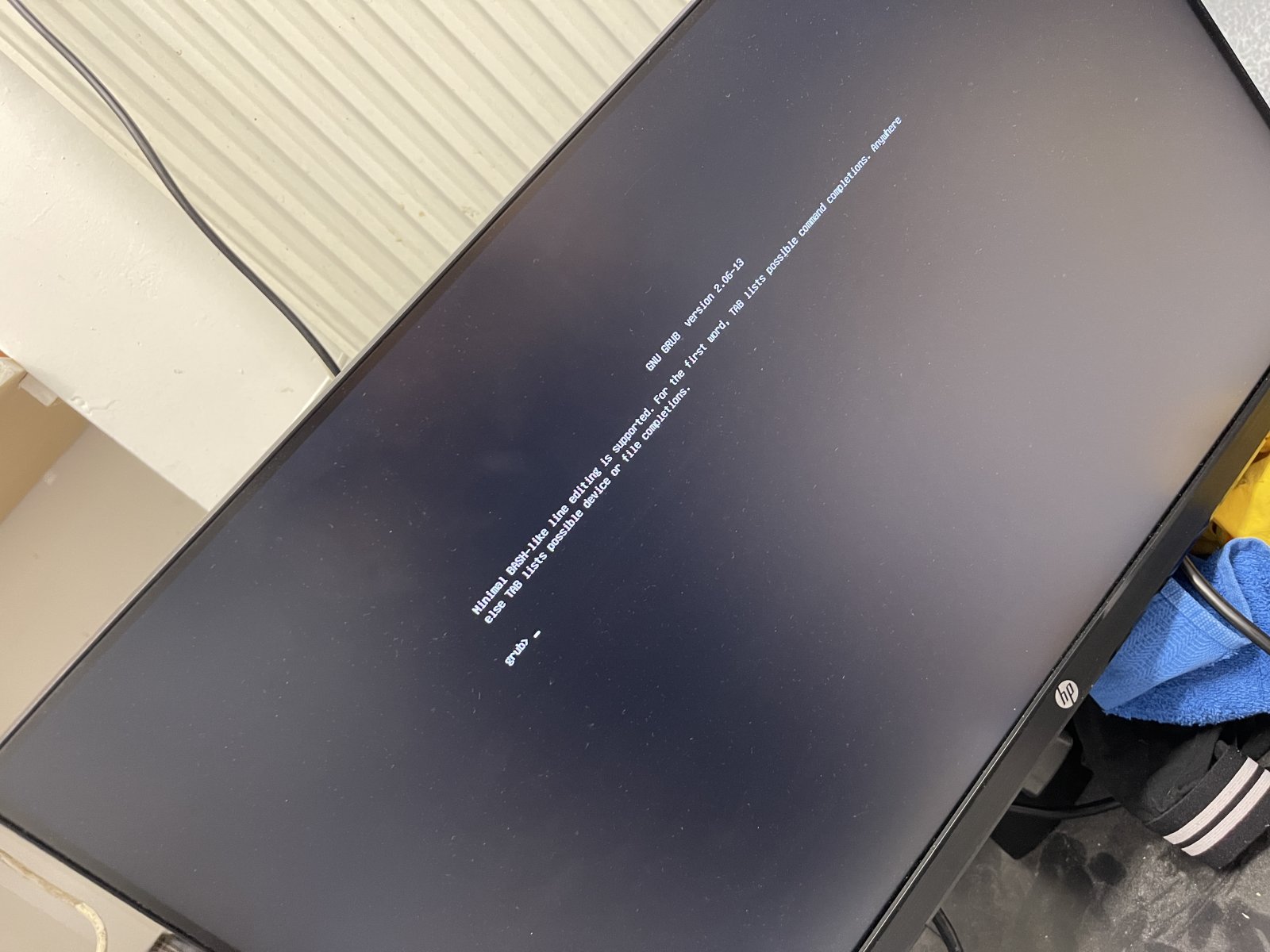

Minimal BASH like line editing is supported.

I keep getting after a few hours or restarts, if the power gets puled like moving from one room to another and just puling the piwer will cause this, so effectivley this would be the same result in a power cut, (I thought this ran in a ram disk so how is pulling the piwer corrupting the drives)
when this happens it wipes both boot pools out and i have to reinstall,

the photo, I'm not sure if you are on mobile and cant see it, but the boot pool keeps corrupting, thats the primary theme,
Random power outages would seem like a reasonable explanation for this. A UPS is recommended for pretty much any system, and doubly so if power is known to be unstable.
I hadn't seen the photo, and don't think I'd have been inclined to pay much attention to a picture of a monitor at a 45° angle when there's no indication in the body of the post of why that picture is there.

sure thing, i stated boot pool corruption, and I don't know what that post/boot screen is, but it look like I cant boot/getpast itwith my current information pertaining to the matter
