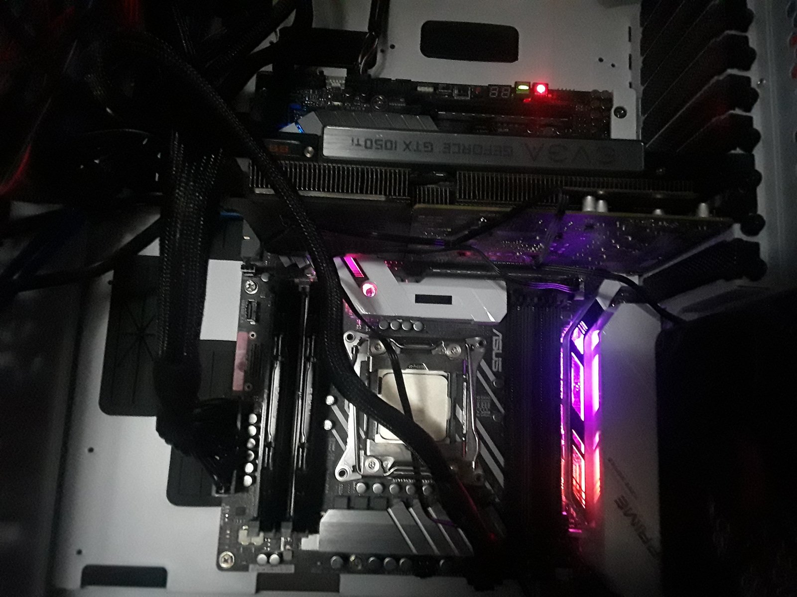

So the core of my issue is that im not getting any display on my monitor, no bios, nothing. When i turn my power supply on the motherboard lights up, all the fans in the system fire up and then go quiet. My motherboards lights stay on, changing colors looking pretty but thats about it. I cant even use the buttons on the motherboard to shut it off or reset it, the only way i can do that is through the power supply. Ive downloaded the bios for my mobo onto a flash drive but i have a sneaky suspicion its not going to just install itself, and im clueless. This is what ive got installed:

The colors arent changing in any sequence, theyre just doing their led rainbow gradient. I apologize if im inept and theres something simple im missing.

Update: ive gotten it to light upjust orange, for a little bit it wouldnt even test the fans, i pressed the on board power button, the q-code did some random shit and now displays 53, the fans run steady without stopping but still no display on my monitor

Maybe it did not find a cpu fan ?
Yeah i noticed my cpu getting hot as well so im going to install a heatsink before i go any further, the only problem is the back plate for the one i have is too small for my mobo so ive gotta go trade it in, get a new one

As far as i can tell all connections are sound plugged in where they should be. I've tried removing the battery on the motherboard and putting it back in. Any suggestions are greatly appreciated
Check the motherboard manual for clearing/resetting the bios. Just removing the battery is usually not sufficient. There is often another step involved, such as temporarily changing a jumper setting or shorting a couple of contacts.

wait a minute .. you are trying to turn on your setup without a heatsink on the CPU? Did something change in "PC Builing 101" that I am not aware of?
Apollo
Jun 13, 2013
1,458
Not a good thing indeed. CPU might be fried, possibly. Not sure if on-die temperature management could kick in to safeguard against such beating.
