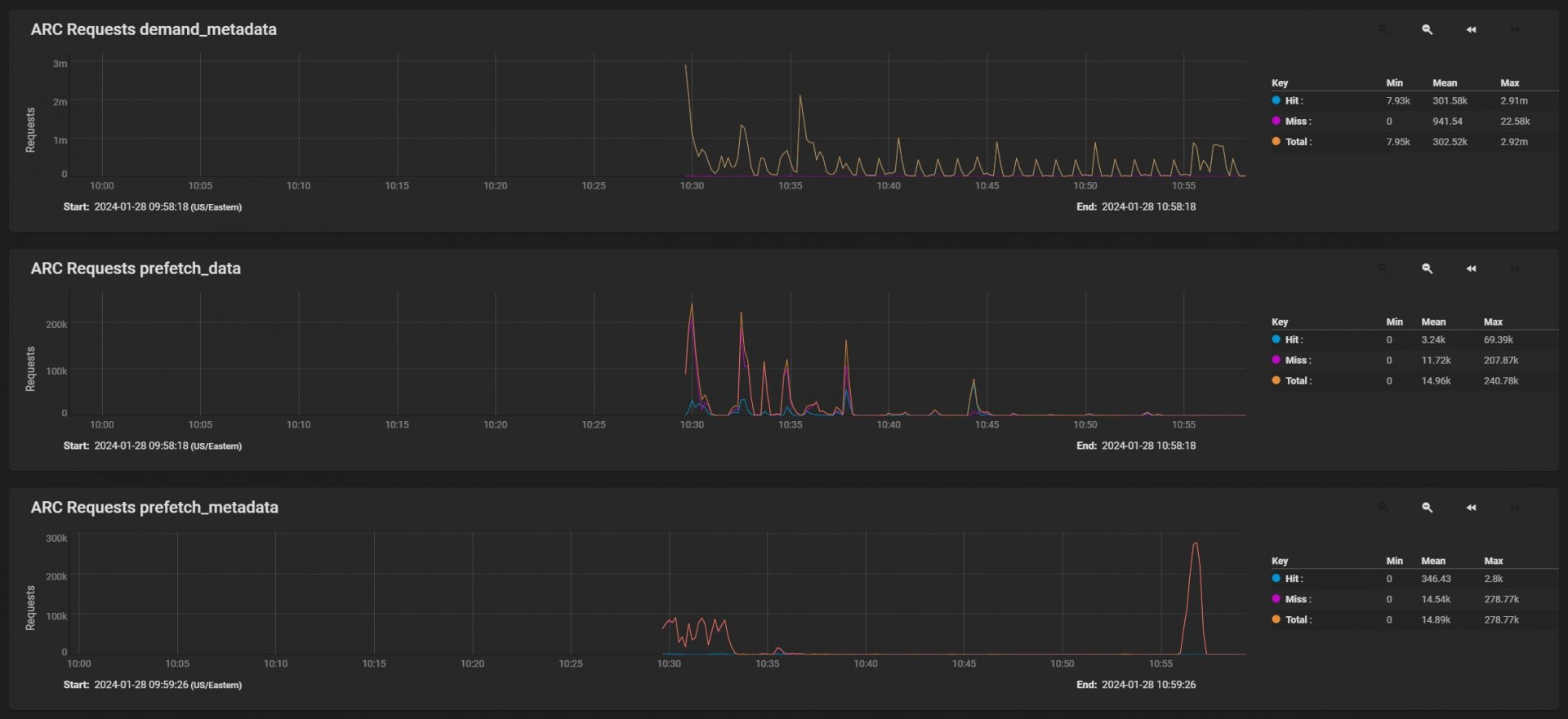

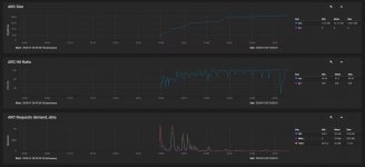

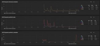

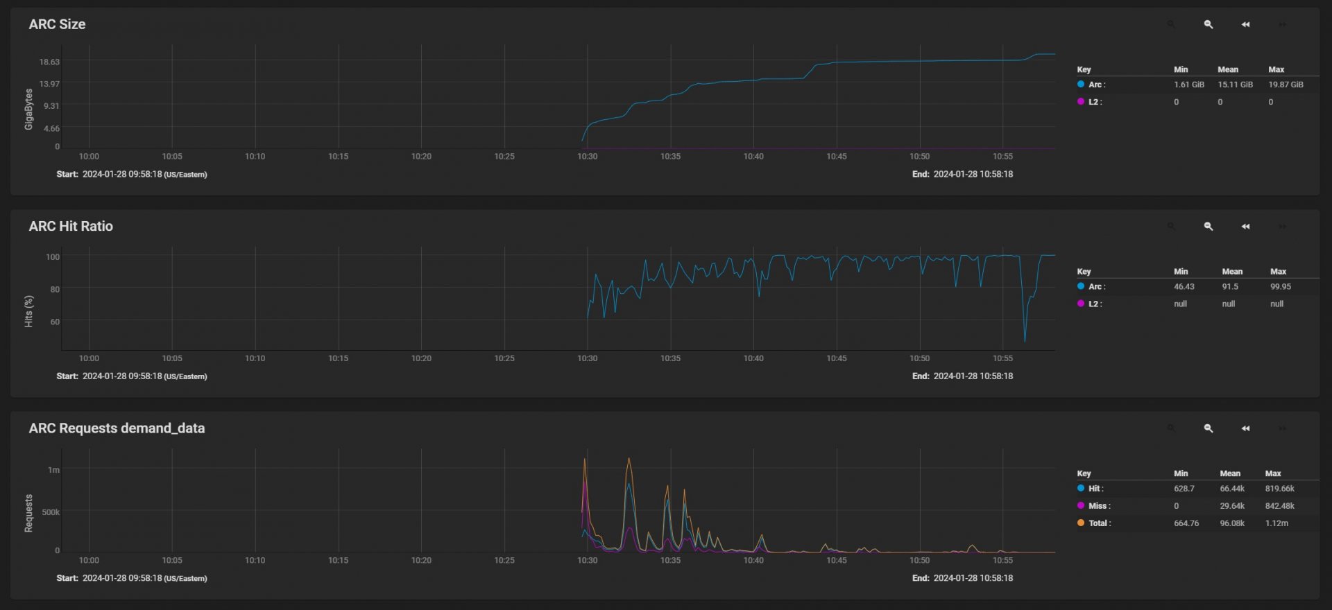

Here is a pic of the Arc screen from my current TrueNas box ... if I am reading it right , from the first graph to me it looks like have a cache drive might be worth it ...
But as I am new to all this I am not sure ... I would rather better safe and then sorry ... Plus with the cost of a card and an M.2 drive being as cheap as they are I am not out a of money if it doesn't really help or only helps out a little ..

Please don't take this as "expert" advice but I will do my best.
Every workload is different and planning ahead for every scenario can be costly. If you want the short answer, try without and see if you even need it.
From your screenshots, your ARC memory is still filling up from a recent reboot. The longer your system is online and being used, the more that will be stored in your ARC.
Also note that ARC will always have dips. I can speak from experience of other SAN vendors too. Any sort of read cache/index/ARC is going to store information from the most active data that is being used. (Every storage vendor has a different logic to how they do this.) Until you have your unit fully loaded and running for days, you can only speculate how well the 64gb is going to work for you.
My recommendation for you is to let it run for at least a few weeks. Unless you are feeling a performance issue, just let it keep going for these few weeks. Then go in and look at your ARC. First thing look at the averages over more than a few minutes. Take at least 1 hour and look at that for the average. If you are >90% hit ratio average, L2ARC isn't probably for you. Me personally, for home use data, I would go as far as saying until you get below 80-85% it isn't worth it. I also ignore the short term dips because no mater what, you will always have these. Even if you have 1tb RAM, if you put enough stored data behind it, something will always cause it to dip if the data being accessed is old and large.
Now if you are doing things like VM storage, then 90%+ is a must and you want to be looking at averaged in both the 1hr and 1day ranges. I have an aging SAN at work from another vendor. It is a hybrid setup with 42x 1tb disks and 9 SSDs (I forget the size). It was getting to about 88% cache hit ration and we were filling it in performance. I was already getting a new SAN in place at this time so I moved a few heavy servers off and the percentage got up to 91-92% and the servers felt as if I doubled their speed. So that 90% ration can be felt. But again, this is for VM workload and not just file access.
