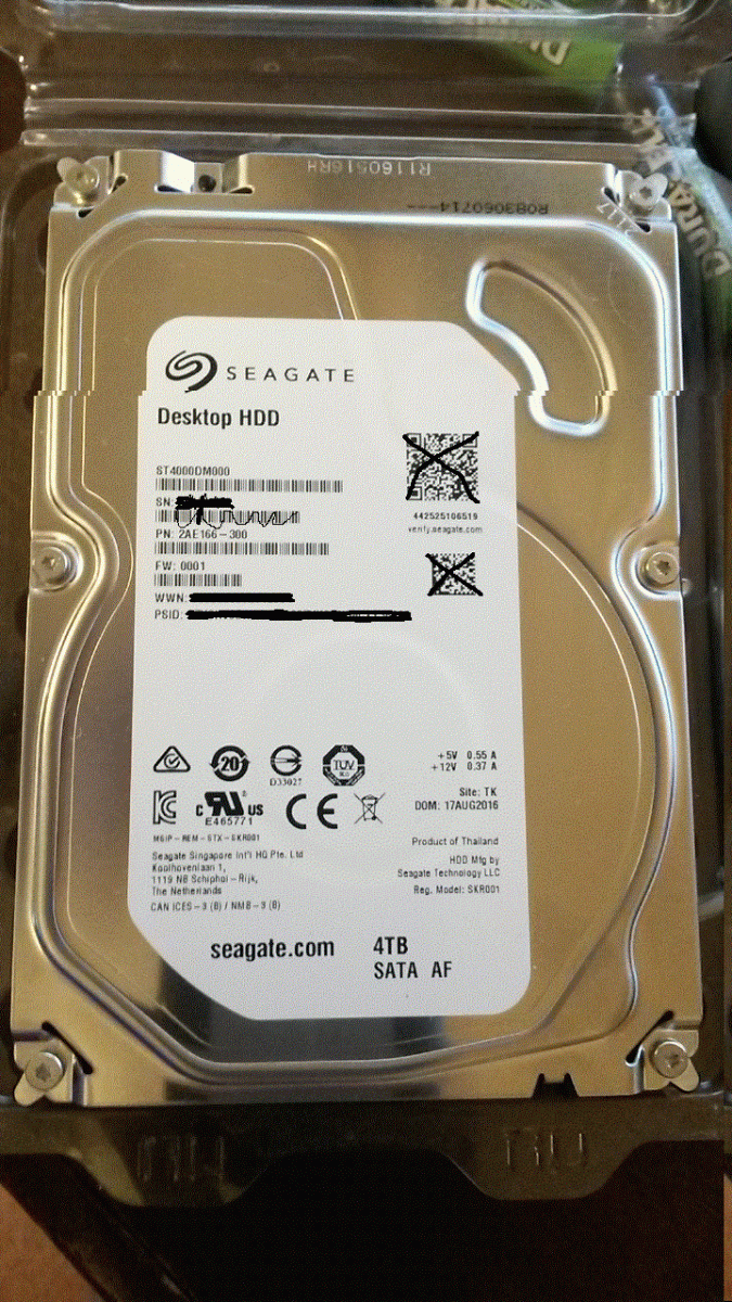

Further Research has show me these are SMR drives
Where did you get that information? The ones I have pulled out are regular Seagate Desktop drives.
Just like this: 20171204_203832[1].gif
Just like this: View attachment 21673
https://www.amazon.com/gp/profile/a...UEYWGGHFUNIAUF3DQ/ref=cm_cr_arp_d_pdp?ie=UTF8
Look under the review. He's was an Archive Drive. How long ago did you purchase yours? I had already pulled the trigger on the hubs, until I found this out. I don't think it will be an issue but I'm guessing these are just like the AE drives I was going to purchase right?
Perhaps it is because of the 8TB capacity where mine are 4TB, but I just pulled mine last year (2016). I bought 8, 6 to use and 2 spares. All of them were as pictured.
The one they show being disasembled here: https://www.ifixit.com/Guide/Seagate+Backup+Plus+Hub+Disassembly/77495
I would guess it is the 8TB model that is the problem.
Edit:
Yes, Seagate Desktop drives only go up to 6TB. He got an Archive drive because he bought an 8TB model.
Edit:
https://www.seagate.com/support/internal-hard-drives/desktop-hard-drives/desktop-hdd/
Well I bought 6TB so I'll post my results once they come in on Weds.
