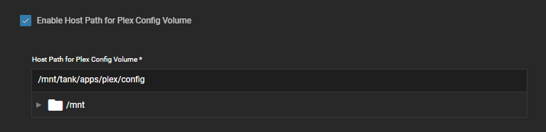

Sure. The way I did it was to keep all my data on the pool (of course) and then migrated my plex configuration settings over.
I moved the "Library/Application Support" directory structure over from the old iocage directories, to a new dataset by hand, "/mnt/tank/apps/plex/config/Library/Application Support"
Then in the Plex App, it was easy to setup a host volume for the new config location.

You will have to go find the location, but it should look something like this:
/mnt/<poolnamehere>/iocage/jails/
