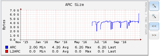

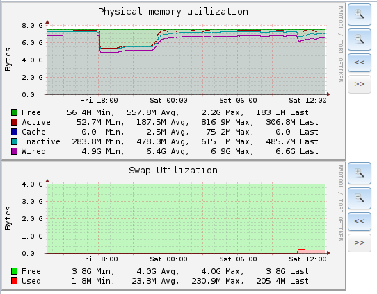

In my FreeNAS machine I have few data (20Gb).
It´s a small business with only 4 user.
The Server is a Lenovo TS140 with 8Gb of ram.
I have one VM with windows for alarm sevice only (alarm server does not work on linux to put in a jail).
Last week for data security reasons I started another Freenas machine in my home, a simplorious hardware (Celeron, desktop pc and 8gb of ram) with replication active between both.
But I did not was lot confortable with this hardware at the backup.

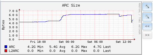

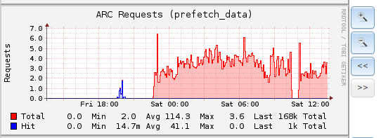

Friday at 18:00 I shutdown the VM just for testing how many memory it was using and stayed off this machine. (you can see at the image that reduce a lot)
So, yesterday I signed and configure rsync.net service for off-site bakcup (now I have one in rsync.net and another at home).

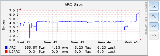

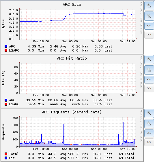

After that I noted that ARC size increase a lot, as you can see attached.
If you see the images attached you will check I never use that amount of ARC memory before.
And today at 11am it attached some swap memory.
The only change that I did was to redirect rsync to another folder at the bakcup site, and start it again.
Another thing is that I never looked swap memory before, and FreeNAS always have used it in my setup.
But, before last week I had the windows VM online, so maybe was because of it.
Should I increase the RAM?
It´s safe to continue using this swap memory?
It´s normal that ARC size increase a lot after start Rsync?
ARC size is a warning about whe you need to increase the memory?
Thanks!

8GB is the minimum for just FreeNAS. If you want to continue to use a VM you should add more memory.
joeschmuck
Old Man
May 28, 2011
10,996
So the real issue here is the SWAP file usage which will traditionally slow something down on your system. While your system is working as designed, it would be better to add more RAM. I like to think of the SWAP file as an emergency fail-over for insufficient RAM. If it happened rarely then that is fine but if this will be routine then I'd add more RAM.

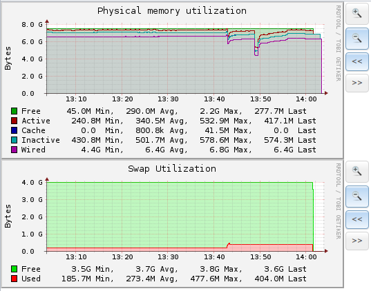

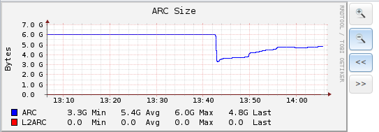

So, I started the windows Vm again, and the swap memory increase a little bit.
Another stranger things is that arc size reduced.

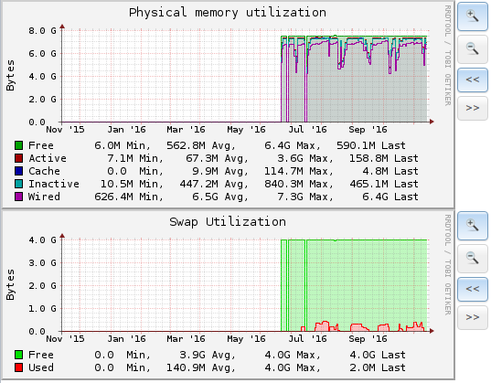

Yes, you can see that always the system used it.
joeschmuck
Old Man
May 28, 2011
10,996
That's good proof that you should increase your RAM if you can.
