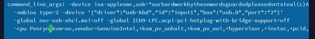

Hi all, little follow up as I do this a second time, this time with Ventura, first one was with Big Sur:
If you are getting permission denied to access the opencore.iso, you want to check permissions of libvirt-qemu user. i had to add "builtin_users" to "Auxiliary Groups" for the user before it launched. see link:
You also NEED to select CPU as Penryn, not qemu32.
edit:
none of this worked, so take it with a grain of salt

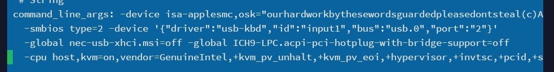

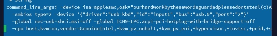

Also, here is the CLI information in text format so it can be copied directly instead of copied off a screenshot:
all the white spaces matter here. first line is not indented, everything after that is 1 space in.
command_line_args: -device isa-applesmc,osk="ourhardworkbythesewordsguardedpleasedontsteal(c)AppleComputerInc"
-smbios type=2 -device '{"driver":"usb-kbd","id":"input1","bus":"usb.0","port":"2"}'
-global nec-usb-xhci.msi=off -global ICH9-LPC.acpi-pci-hotplug-with-bridge-support=off
-cpu Penryn,kvm=on,vendor=GenuineIntel,+kvm_pv_unhalt,+kvm_pv_eoi,+hypervisor,+invtsc,+pcid,+ssse3,+sse4.2,+popcnt,+avx,+avx2,+aes,+fma,+fma4,+bmil,+bmi2,+xsave,+xsaveopt,+rdrand,check
This isn't working just yet. I am now stuck on the apple logo when selecting the install. Will update as I go.

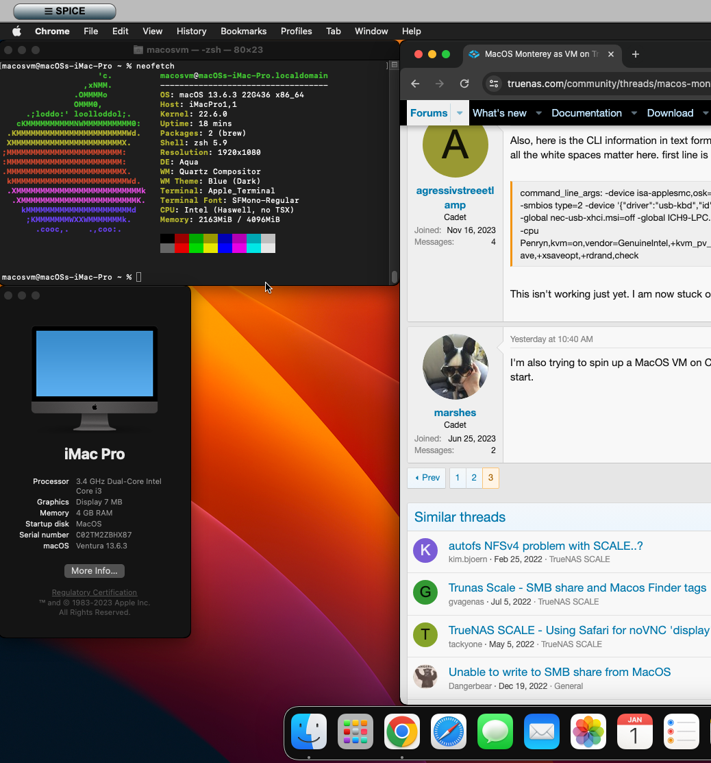

edit: was able to get Ventura to boot and seems to be stable. The install process seemed pretty straight forward, except the installer wouldn't reboot the VM automatically (anyone know why?). So each time the installer seemed to freeze, I just shut it down, started it back up and selected the newly created disk. Had to do this maybe 4 times throughout the process. I also used the full img for Ventura created from Nick's OSX-KVM github.
The config I got working for my system is as follows:
# command_line_args: -cpu Haswell-noTSX,kvm=on,vendor=GenuineIntel,+invtsc,+hypervisor,vmware-cpuid-freq=on,+ssse3,+sse4.2,+popcnt,+avx,+aes,+xsave,+xsaveopt,check
#   -usb -device usb-kbd -device usb-tablet -device '{"driver":"usb-kbd","id":"input1","bus":"usb.0","port":"2"}'
#   -global nec-usb-xhci.msi=off -global ICH9-LPC.acpi-pci-hotplug-with-bridge-support=off
#   -device isa-applesmc,osk="SECREToskOMITTED"
#   -smbios type=2
I had to omit machine: q35 as I couldn't get the VM to boot with that config in and couldn't figure out an args combo that would work.
This is now running on TrueNas Scale Cobia / 23.10.1
HW is AMD Ryzen 5 PRO 5650GE with Radeon Graphics w/ 64 GiB of ram.
Next up, I want to see if I can connect to this VM directly outside of TrueNas's web UI. That's also something new to me, and could use some guidance on how to set that up. I just setup realVNC which I used a long time ago, and will do what I want.

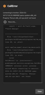

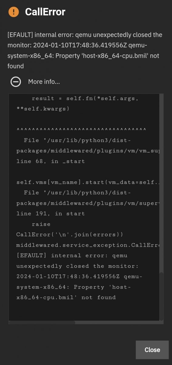

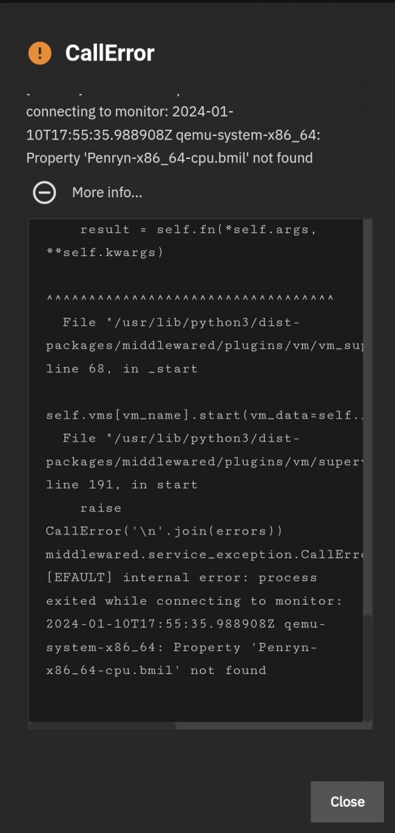

I am getting this error when starting.
This is when I have the command line argument as host. If I set it to Haswell-noTSX or Penryn both do the same thing.
Holy crap, it was just that it didn't like that order.
THIS WORKED:
edit: was able to get Ventura to boot and seems to be stable. The install process seemed pretty straight forward, except the installer wouldn't reboot the VM automatically (anyone know why?). So each time the installer seemed to free, I just shut it down, started it back up and selected the newly created disk. Had to do this maybe 4 times throughout the process. I also used the full img for Ventura created from Nick's OSX-KVM github.

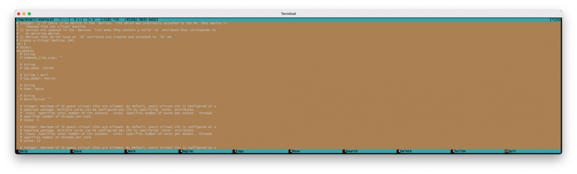

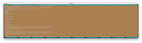

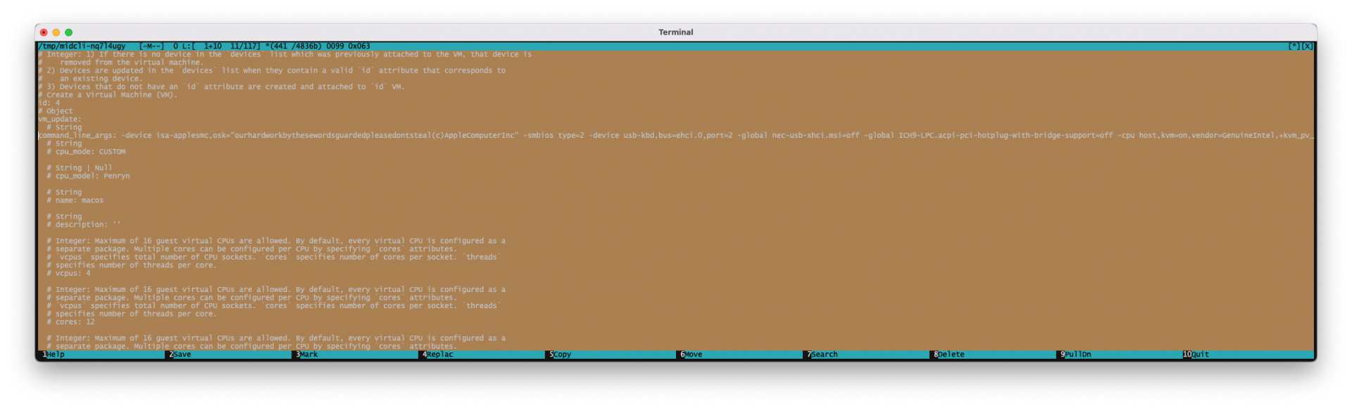

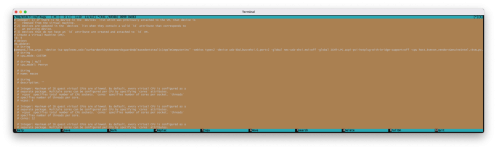

Did you edit the TrueNAS config?

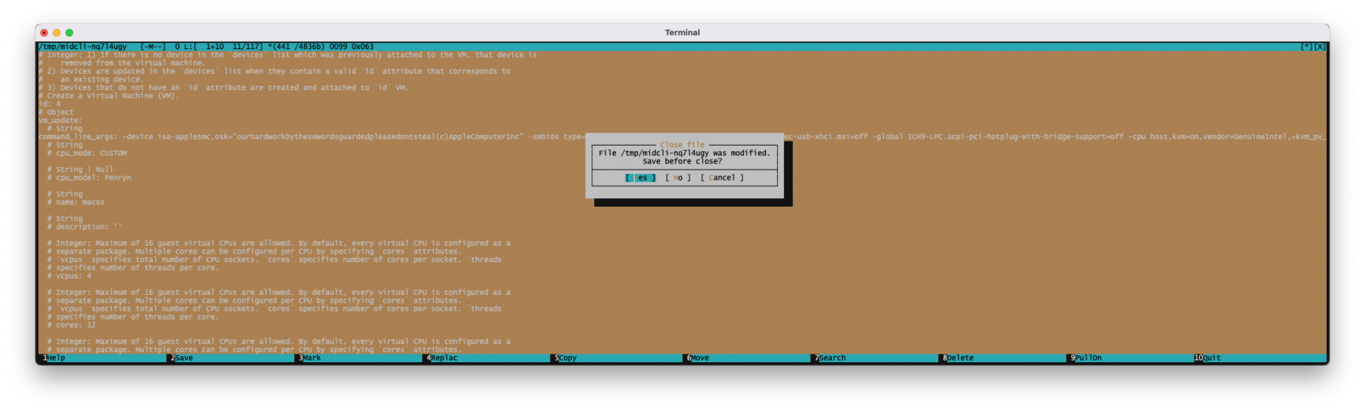

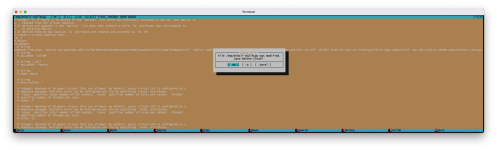

Edit 1:
You start by going to TrueNAS shell, then enter the CLI:
`sudo cli`
Then we'll first get to the vm service:
`service vm`
Then check what VMs you have, we need the id, if this is the first ever vm created on the machine it will be 1 I think:
`query`
Then now that we have the id we cane edit the config (I put the number pne for this command, if your id for your MacOS VM is different then put that number instead):
`update 1`
Now you'll be in the text editor. Look around this topic and you'll find the info you need. I can provide more if you need it. Also, you have to delete the hashtags in front of whatever you change for it to save. Then hit escape and then select yes to save and hit enter.
Edit 2:
So in my screenshots I blurred out the osk. It's the same for every Mac so Google how to find it, it can be found anywhere, technically Apple could get mad about it being shared so that's why I redacted it.
Here's what worked for me:
command_line_args: -device isa-applesmc,osk="<redacted>"
-cpu Haswell-noTSX,kvm=on,vendor=GenuineIntel,+kvm_pv_unhalt,+kvm_pv_eoi,+hypervisor,+invtsc
I took some example screenshots:
(Notice in the screenshots I deleted the hashtags to edit the config. I hit backspace 3 times for each one, deleting 2 spaces and the hashtag. Not sure if deleting the two spaces is necessary but doing this every time has worked every time for editing this correctly.)

Ah yeah, I seemed to overlook that post. I was able to edit the config and I tried a few combinations that have been scattered in these posts as well as what was listed on Nicks. Some combinations allow me to save the file, but once I go back into it to check none of the edits are saved.
Nicholas Flamy
Feb 25, 2023
28

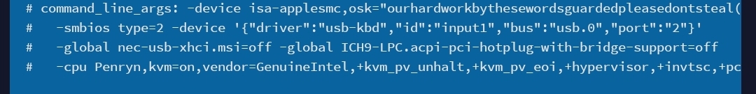

2 things:
Did you delete the hastags?
Did you hit escape, and then use the arrow yes to select Yes, and hit enter?
