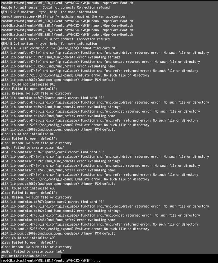

OK so far everything works in the instructions linked at the top (Kholia) up until the " ./OpenCore-Boot.sh" part.
The only change until then was running dmg2img on another machine (WSL on Win10 in my case) sicne its not available on truenas
I checked my available cpu types by running "qemu-system-x86_64 -machine help" and did not see x86-64 but did see q35 so I left q35 it there.
I think Straafe is talking about calling "CLI" when in the shell ang going from there. I found his "serve update vm" in there but that's AFTER i install a which we have not done yet so I'm missing a step.
When I try to run ./OpenCore-Boot.sh I just get the following. I tinkered with the script to see if I could fix it. Here is the following. Would love advice n how to create the VM from here.
OpenCore-Boot.sh
env bash
# Special thanks to:
# https://github.com/Leoyzen/KVM-Opencore
# https://github.com/thenickdude/KVM-Opencore/
# https://github.com/qemu/qemu/blob/master/docs/usb2.txt
# qemu-img create -f qcow2 mac_hdd_ng.img 128G
# echo 1 > /sys/module/kvm/parameters/ignore_msrs (this is required)
# This script works for Big Sur, Catalina, Mojave, and High Sierra. Tested with
# macOS 10.15.6, macOS 10.14.6, and macOS 10.13.6.
ALLOCATED_RAM="8196" # MiB
CPU_SOCKETS="1"
CPU_CORES="1"
CPU_THREADS="2"
REPO_PATH="/mnt/NVME_SSD_1/VenturaVM/OSX-KVM"
OVMF_DIR=""
# shellcheck disable=SC2054
args=(
  -enable-kvm -m "$ALLOCATED_RAM"
  -cpu host,kvm=on,vendor=GenuineIntel,+kvm_pv_unhalt,+kvm_pv_eoi,+hypervisor,+invtsc
  -machine q35
  -usb -device usb-kbd -device usb-tablet
  -smp "$CPU_THREADS",cores="$CPU_CORES",sockets="$CPU_SOCKETS"
  -device usb-ehci,id=ehci
  # -device usb-kbd,bus=ehci.0
  # -device usb-mouse,bus=ehci.0
  -device nec-usb-xhci,id=xhci
  -global nec-usb-xhci.msi=off
  # -global ICH9-LPC.acpi-pci-hotplug-with-bridge-support=off
  # -device usb-host,vendorid=0x8086,productid=0x0808  # 2 USD USB Sound Card
  # -device usb-host,vendorid=0x1b3f,productid=0x2008  # Another 2 USD USB Sound Card
  -device isa-applesmc,osk="ourhardworkbythesewordsguardedpleasedontsteal(c)AppleComputerInc"
  -drive if=pflash,format=raw,readonly=on,file="/mnt/NVME_SSD_1/VenturaVM/OSX-KVM/OVMF_CODE.fd"
  -drive if=pflash,format=raw,file="/mnt/NVME_SSD_1/VenturaVM/OSX-KVM/OVMF_VARS-1920x1080.fd"
  -smbios type=2
  -device ich9-intel-hda -device hda-duplex
  -device ich9-ahci,id=sata
  -drive id=OpenCoreBoot,if=none,snapshot=on,format=qcow2,file="/mnt/NVME_SSD_1/VenturaVM/OSX-KVM/OpenCore/OpenCore.qcow2"
  -device ide-hd,bus=sata.2,drive=OpenCoreBoot
  -device ide-hd,bus=sata.3,drive=InstallMedia
  -drive id=InstallMedia,if=none,file="/mnt/NVME_SSD_1/VenturaVM/OSX-KVM/BaseSystem.img",format=raw
  -drive id=MacHDD,if=none,file="/mnt/NVME_SSD_1/VenturaVM/OSX-KVM/mac_hdd_ng.img",format=qcow2
  -device ide-hd,bus=sata.4,drive=MacHDD
  # -netdev tap,id=net0,ifname=tap0,script=no,downscript=no -device virtio-net-pci,netdev=net0,id=net0,mac=52:54:00:c9:18:27
  -netdev user,id=net0,hostfwd=tcp::2222-:22 -device virtio-net-pci,netdev=net0,id=net0,mac=52:54:00:c9:18:27
  # -netdev user,id=net0 -device vmxnet3,netdev=net0,id=net0,mac=52:54:00:c9:18:27  # Note: Use this line for High Sierra
  -monitor stdio
  -device vmware-svga
  -smbios type=2
sudo qemu-system-x86_64 "${args[@]}"
Response:
