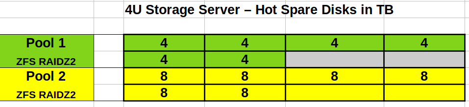

I would like to show how a "maximum" storage build with the 16 hot swap case could look like, see attachement.
Pool 1 is the primary pool with different DataSets, the space should be enough, but I would like to have an "option" to add another data pool in the future like Pool 2 for other stuff, at the moment it is not clear, maybe a backup pool, but these makes no sense on same hardware.
I would like to connect/wire most of the HDD/backplanes depends on the mainboard with available ports, when I backup with an extra disk, I can put to an empty HotSwap slot, process the backup and take the disk out :smile:
I think the board with 10Gb LAN sounds fine, but maybe the wiring problem like Etorix mentioned could be a problem.

What would you do, buy an additional LSI/HBA card which handles all/partial of the disks?
There are not that many reasons to justify multiple pools... The only good one is when your need different pool-level options for different data usage. What you described here requires different datasets, not different pools.
maybe a backup pool
That would be closer to an illusion than an actual backup. Being in the same server, it will fail to the same physical incident (fire, flood, ...) or the same logical incident (intrusion, human error, ... ). Because the 2 will fail to the same incident, one can not be considered as a backup for the other. See my signature for a complete backup strategy.
Exactly :smile:
That would be the equivalent of copy No3 : Offline backup. Just be careful here because done this way, this copy will have no redundancy by itself and will be pretty fragile. Also, to move, plug / unplug drives all the time increases the risk of mechanical failure. Better than nothing and important to have at least that, but not the strongest one either.
In all cases, good thing that you think about backup now instead of after loosing it all like so many others.
