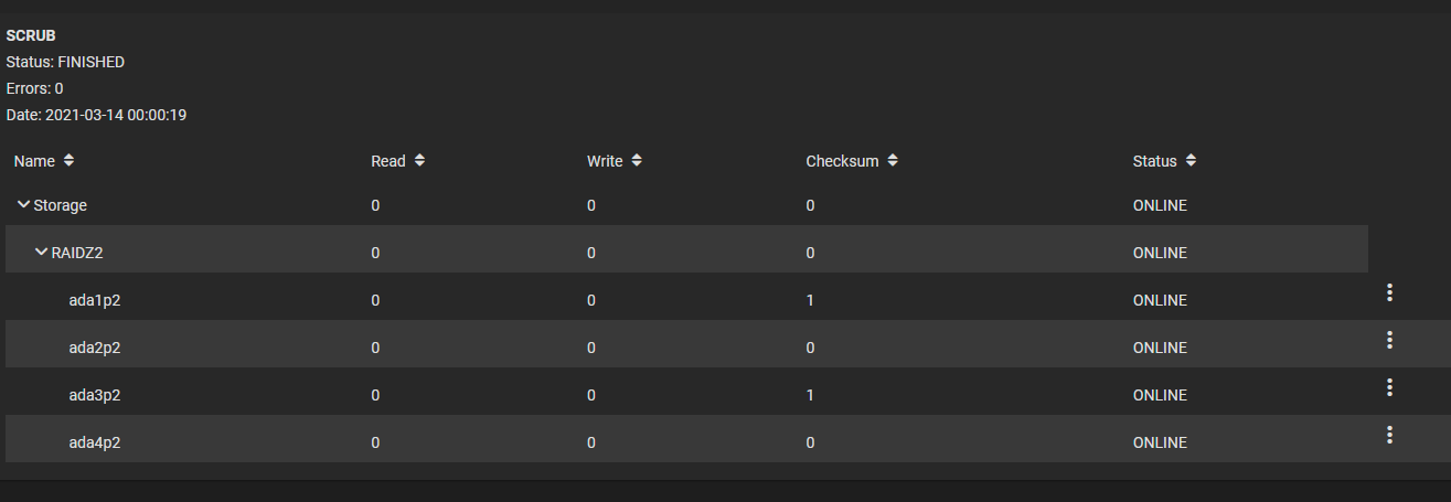

starche.old
Mar 4, 2021
38
Quick question here.
This what I saw just now,
How I can see what's wrong with my pool?
All I manage to find is this:
2 questions here:
1. How bad is that?
2. How I can fix that?
Etorix
Dec 30, 2020
2,134
zpool status -v and smartctl -a for ada1 and ada3 may answer the first question.
starche.old
Mar 4, 2021
38
I was copying a lot of data these days, so I did not want to interfere the process with the commands. This night all data is in. Just ran zpool status -v and it says that scrub repaired all errors. That's great news, however, ada3 (while being brand new) will be replaced later this week (replacement is on the way. ada1 is an older drive and I cannot just return it. So, I started long SMART test and will see the outcome.

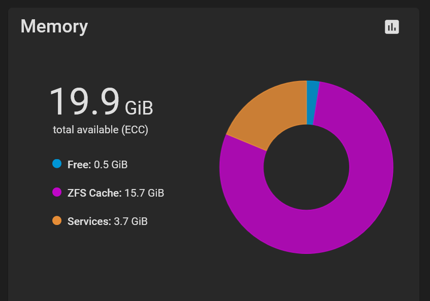

starche.old
Mar 4, 2021
38
Is that OK, that the whole RAM is occupied by zfs cache? How I can clean it up? Or I should leave it as it and "don't worry, be happy"?
Redcoat
Feb 18, 2014
2,925
That's just how it should be so leave it as it is and "don't worry, be happy"!
9,703
"Free RAM" = wasted RAM. You should be using it if at all possible or it's just money spent for nothing.
Caching ZFS (ARC) is a great way to use it when it's available.
