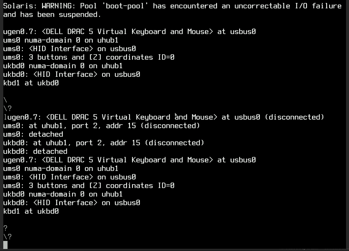

I have access to the local console, however, I don't know if the commands are working. I have attached a screen shot. I can type and press enter, then the next line just comes up blank.
I have not tried SSH access.

Oh yeah, there's your answer right there, first line. Your OS is hosed, whatever happened to be loaded into memory will keep chugging along, but anything else will just break in weird and wonderful ways.
