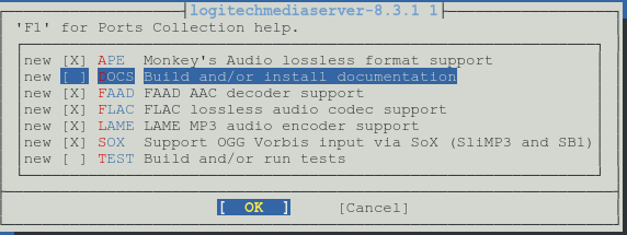

Had some confusion related to "selected flac and lame support on the first screen. Disable dtrace an all tests, documentation in following screens. kept the defaults for the rest. This build is slow! At the end you will have a ":" prompt, type "q".
Select flac and lame - must AAC and others be unselected?
Ran with "disable tests" and and aborted with dtrace errors. Tried to run again but never given setup/config screens.
Found dtrace disable - NOTE disable dtrace is only available on Perl settings screen about three screen/pages in.
Took nearly an hour to fully complete on Intel(R) Core(TM) i3-4160 CPU @ 3.60GHz
Still fiddling with permissions. Hoping LMS server stays running more than three days.
Don't unselect the other audio encoders.
You must unselect "DTrace" for Perl, yes, as it seems to break the build with missing packages. Also you don't need it since it's a performance analysis tool.

Thank you for the instructions. I never used LMS before and wanted to try out the plugin but that failed so I found your instructions. They worked for me except for using the Web UI shell command. When I attempted to run the portmaster I was shown the following menu:
When I would choose "OK" the entire shell shell turned blue. I let it stay that way for a few hours because I knew it took some time for the build. I eventually checked my CPU usage and realized that nothing was happening. I decided to just ssh into the jail. I executed portmaster again and this time I was shown many more menu options which I guess were dependencies for LMS. My piCorePlayer was found right away. At first only a few albums showed up but after a rescan I think everything is there.
Thanks again!
