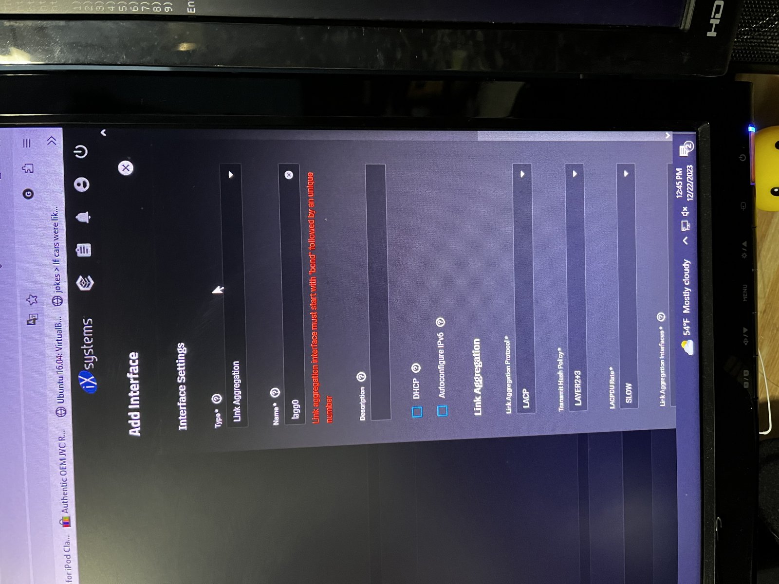

Hi all,
I have used truenas core for the last couple of years, and I decided to switch to truenas scale as a part of my nas upgrade project. The installation went smoothly, but I can’t create a lagg with the network card I added. I can get to the menu for creating a lagg just fine, but whenever I enter a name, I get an error saying that it must be a bond with a unique number. I have tried many names that fit such criteria, like lagg0, LAGG0, lag0, etc, to no prevail. I also tried setting up a lagg from the serial console instead of the web ui, but that still didn’t work. Am I doing something wrong or is this a bug? I have attached images below of the two interface attempts. Thanks in advance for your help.

Use the name bond1 like the ? information popup for the name field says to do.
15,504
I'm not sure how you posted two screenshots with the answer to your question, but failed to see it. As they both say, 'Link aggregation interface must start with "bond".' I use bond0, since computers start counting at 0, but any unique number would work.

I am such a dummy. I thought that "bond" meant the protocol used, hence the attempts at "lagg0" and the like. Thank ya'll for clearing that up, and I apologize for the stupid question.
