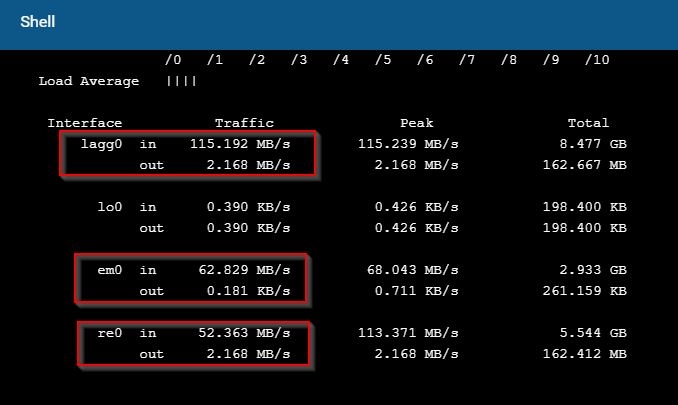

I have configured the network using Lagg. The network card is Gigabit link speed.
The network lagg0 speed alway stops at 1Gbps.
Please give me an advice :)

thank you for replying me.
#1
If only one client access to FreeNAS server, they can transfer file ~116MB/s
#2
If 2 or 4 client access to the FreeNAS server at the same time, each client can only get 1/4 of 116MB/s
I checked the network status of FreeNAS, the total transfer speed of lagg0 is only 116MB/s. I thought it must be ~232MB/s.
type of load-balancing on switch is src-dst-ip
Fredda
Jul 9, 2019
608
Keep in mind that with just 2 clients and a LAGG consisting of 2 port you have a 50% chance both connections go through the same channel
and so resulting in a 1GB/s speed. But with 4 clients this chance is very little.
You should check with iperf if the network is really the limiting factor. Start the iperf Server on you FreeNAS box (iperf -s)
and run simultaneously the iperf client on your clients (iperf -c <ip-of-FreeNASBox>) and see if you still get 1GB/s total bandwidth.
