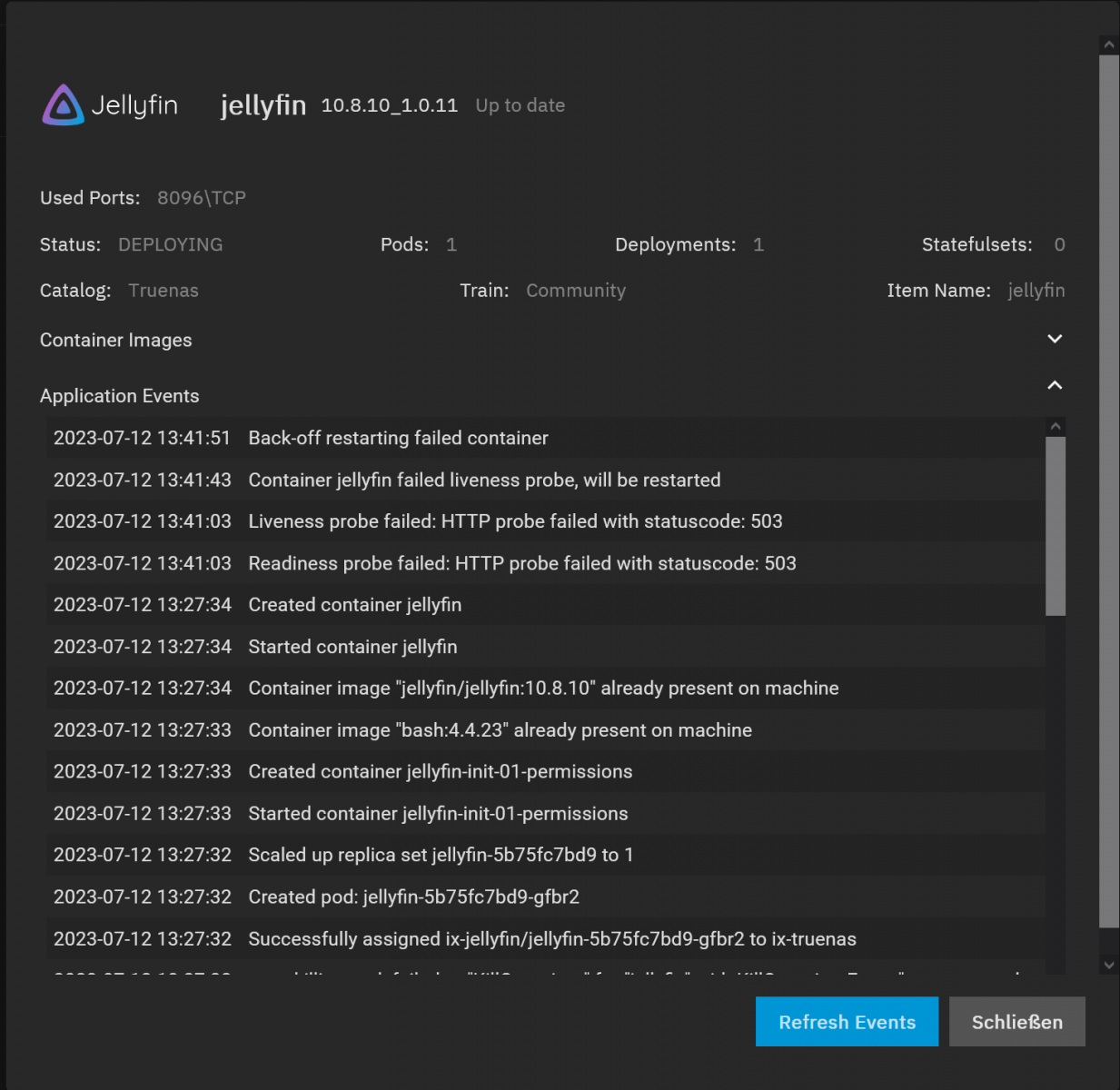

In the log you can see, I started the App and created a User at 11:29:48 At 11:34:31 it was already offline and I wanted to login again. the Error message is:
[ERR] [18] Jellyfin.Server.Middleware.ExceptionMiddleware: Error processing request. URL POST /Users/authenticatebyname.
Before tha event a lot of other errors occur and I have no idea why.

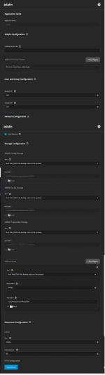

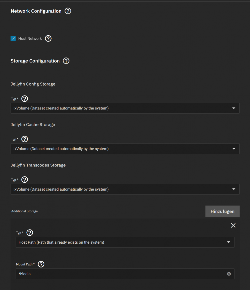

Okay guys I played araound a little....During installation I chose my own place for the config files like you can see here:
Within a new installation i left the config files to be automatic in IX Systems like you can see here:
That seemed to work.
Don't know why, but something did not work for my own defined storage path for config files. Maybe this will help somebody else.

I saw one error in your log where it attempted to write to a read only database (sqlite).
If changing the paths from yours to the default works, then I'd guess a permission issue? I can't recall my exact jellyfin setup but more than likely I used the default paths. I followed a video I had found on youtube. Haven't had any crashes and its been running since last year.
Actually, I just came across this and it might be the issue you have: https://www.truenas.com/community/t...truenas-folder-sqlite-database-locked.110092/
They also changed their config to local to fix it.
