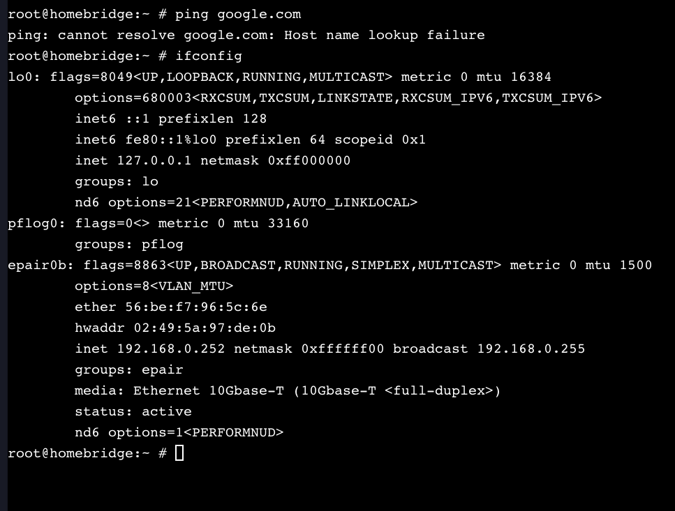

I have 2 jails on my NAS that ran perfectly fine before I updated to 13.0-U5.2, and now pinging google.com doesn't work despite no changes being made. I s the answer right in front o me or is this a major bug?

Within the jail:

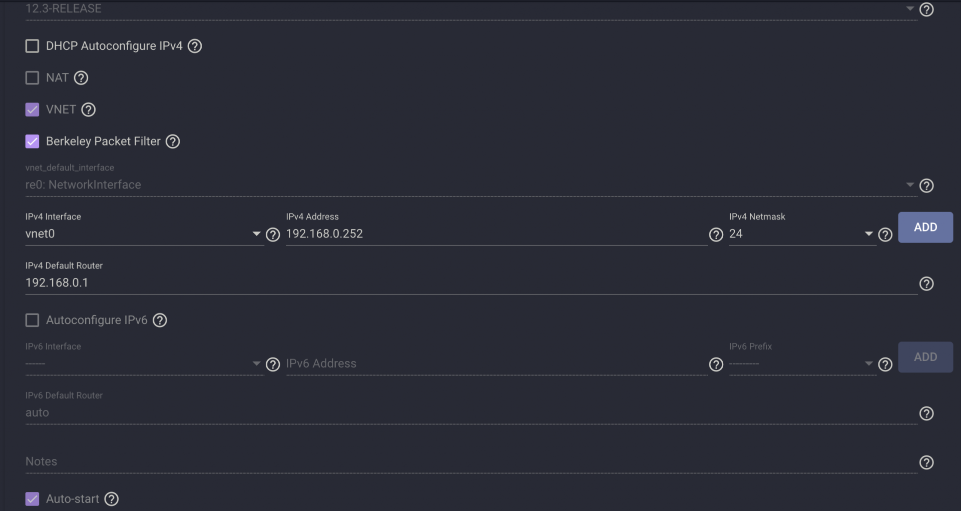

Is the resolver configured under the jail's Network Properties?
Oct 22, 2019
3,641
You can manually enter each nameserver line in the jail's "resolver" text field under Network Properties. Or write the word none to inherit the TrueNAS system's resolver.

What about manually typing in /etc/resolv.conf as the value for "resolver" under Network Properties?

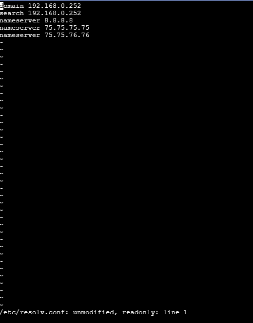

The domain and search entries in the screenshot above are nonsense. But that should not keep name resolution from working. Is 192.168.0.1 your router? Could you put nameserver 192.168.0.1 in your jail's resolver field and try again? Why don't you use your router as the recursive namerserver for all local devices in the first place?

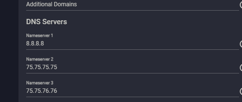

I put it into the resolver and it did nothing. I reconfigured the base nameservers and set the jails to recursive and it also did nothing. It worked totally fine before the update. Anything I can screenshot to help?
