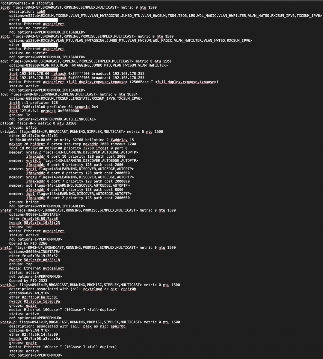

After some time (1 day - 1 month), all the services connected to bridge1 lose network connection.
Neither ping to router nor to www.google.com are possible.
After I perform a reboot, everything works as it should.
I checked the ifconfig output, I could not see anything different between the two,
where the first output was made when the services could not ping other addresses
and the second output was made when the services could ping other addresses.

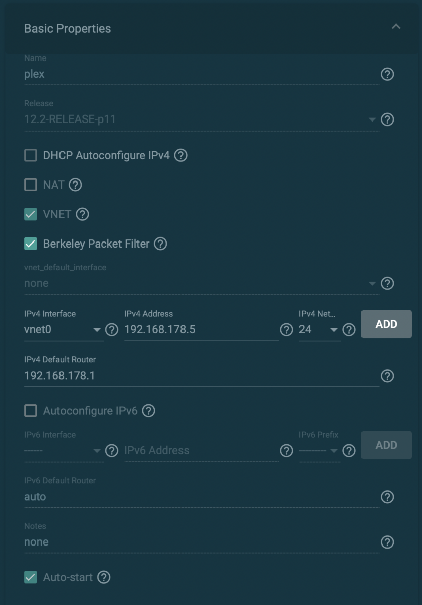

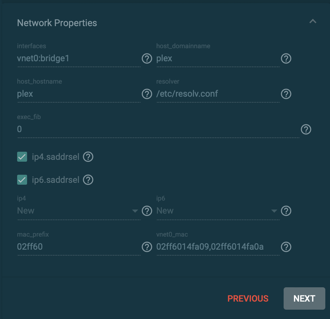

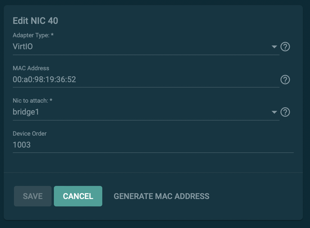

I attached the configurations of a Jail and a VM and also of the ifconfig output.

The driver for aq0 is a developer preview. It's not guaranteed to be stable, and is shipped with TrueNAS only as a convenience for testing.

Thanks for your reply.
I am aware of that. I was just hoping I was either making an configuration error
OR
I could somehow reinitialise the network interface and bridges, so I don't have to reboot the entire server every time that happens.
After all. I can connect via SSH and to the web UI even when the Jails are not available in my network
