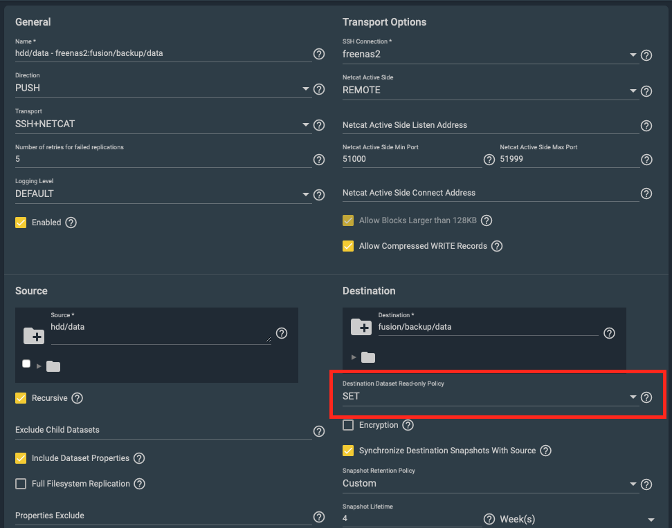

Hi, where can I find the read only parameter? I cant find it.
Patrick M. Hausen
Nov 25, 2013
7,776
On the Main System are two pools with jails and on the backup system are also two pools but without jails at the moment
You can only have one pool with jails active on each system. So on the primary system you can replicate the jails to a different pool, but you won't see these replicas in the "Jails" UI. If the first pool fails you can manually restore the jail datasets from this backup after you have repaired the first pool.
If you replicate to a second system you will be able (I guess) to see the jails in the UI after you used iocage activate, but you won't be able to start them, because the replicas must be read-only for incremental replication to work.
Please see attached screenshot.

Okay, for the first backup pool it is now working. But by the second Backup pool I get the following in the Jails. I typed in the cmd iocage activate <poolname> and after that I get the same Error as every time... its in read only mode
Leonard
Patrick M. Hausen
Nov 25, 2013
7,776
OK, so you cannot activate it when in read-only mode. OK. But you have a backup.
In case your primary system fails, you can go to Storage --> Pools --> the dataset in question
and set it to read/write, then use iocage activate and start your jails. Proper backup solution if you ask me.
