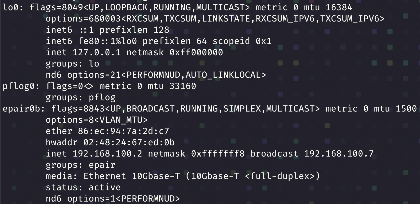

Nope. The interface inside the jail is named epair0b or similar. You need to do iocage console <your jailname> and then ifconfig.
fsociety3765
Feb 2, 2021
61
I have doubled checked this again. And what I have provided is correct. There is no interface named "epair0b" or similar. It is as above.
I have set up direct SSH access to the jail, and that is what I was using but I have logged into it via the TrueNAS SSH session using the iocage console command and the results to ifconfig are the same as above.
The first output posted here is from inside the jail, the second is on the host TrueNAS.

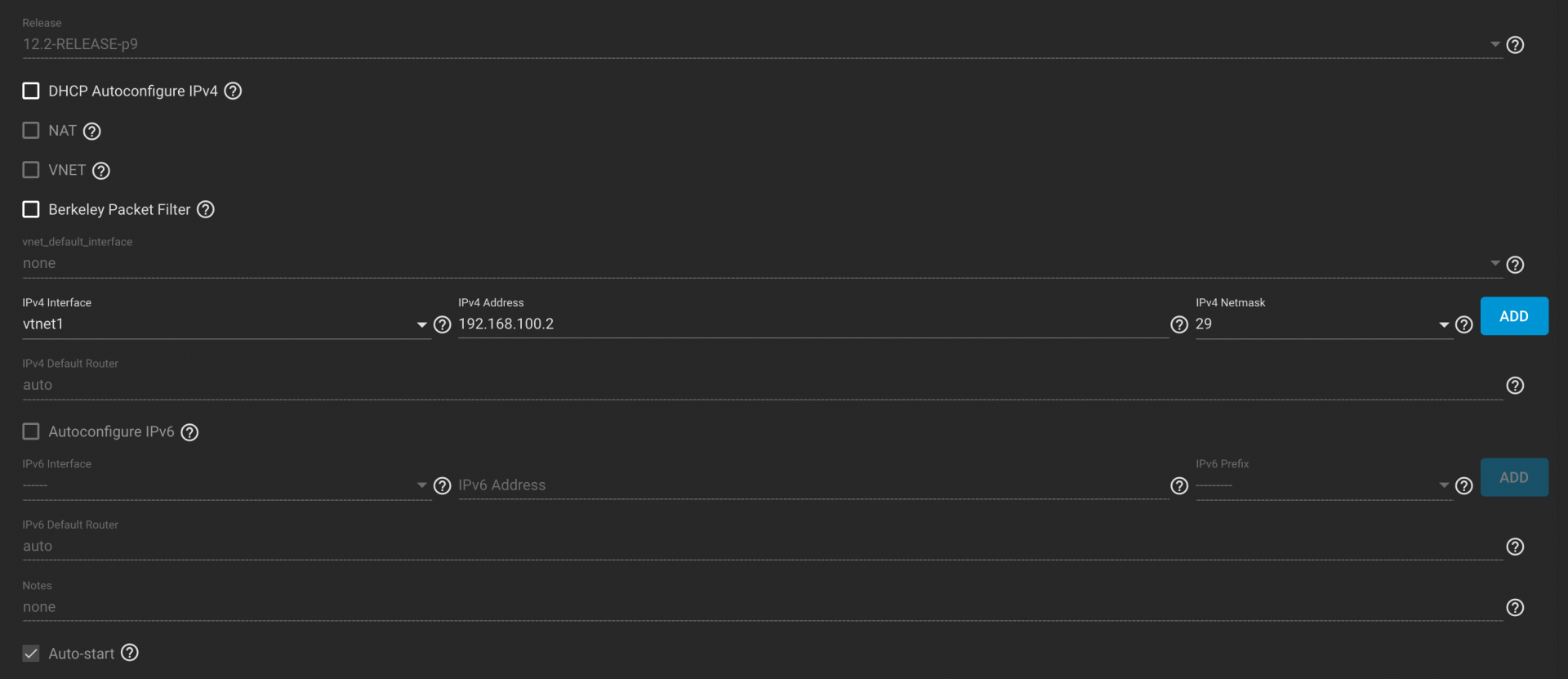

fsociety3765
Feb 2, 2021
61
No, that is currently disabled. Should I enable that? I think I disabled it as it wouldn't let me select "vtnet1" as the interface otherwise.

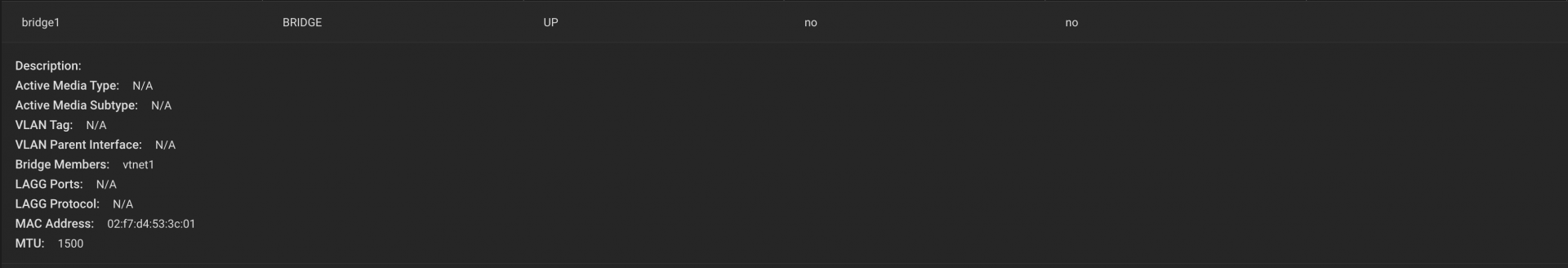

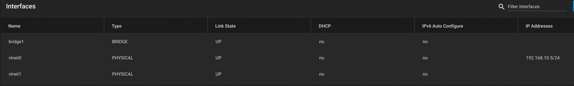

Hmm. Don't seem to be having much luck here. I have created the bridge and assigned vtnet1 to it. Whenever I try to disable hardware offloading on vtnet1 it won't save for some reason though. Does the hardware offloading need to be disabled directly on vtnet1 and not the bridge?
Even still, the bridge doesn't show up as an option in the jail properties for the IPv4 interface.

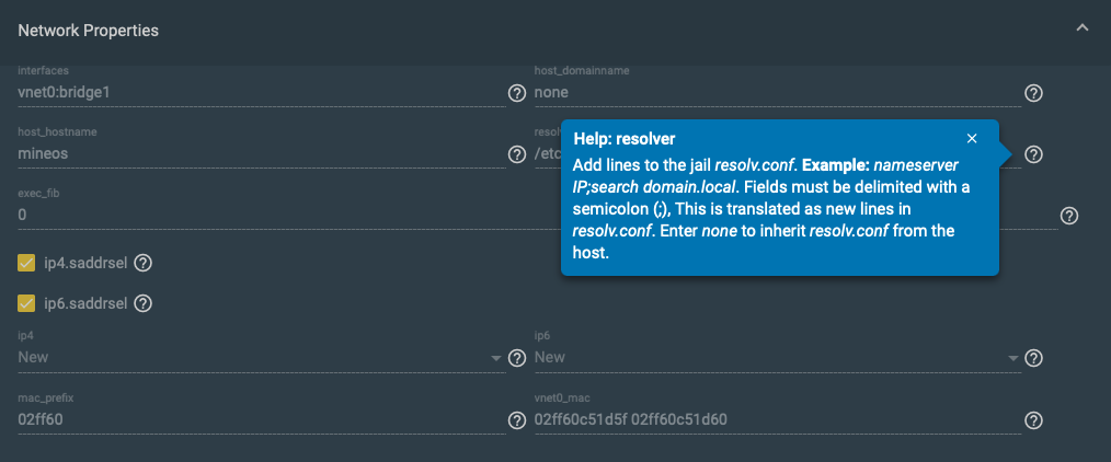

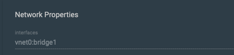

Not the IPv4 interface. That stays at vnet0. Further down in the Network Properties:
And the disable hardware offloading is possibly not necessary when running virtualised as you seem to do. I honestly don't know. I run TrueNAS as my hypervisor host.

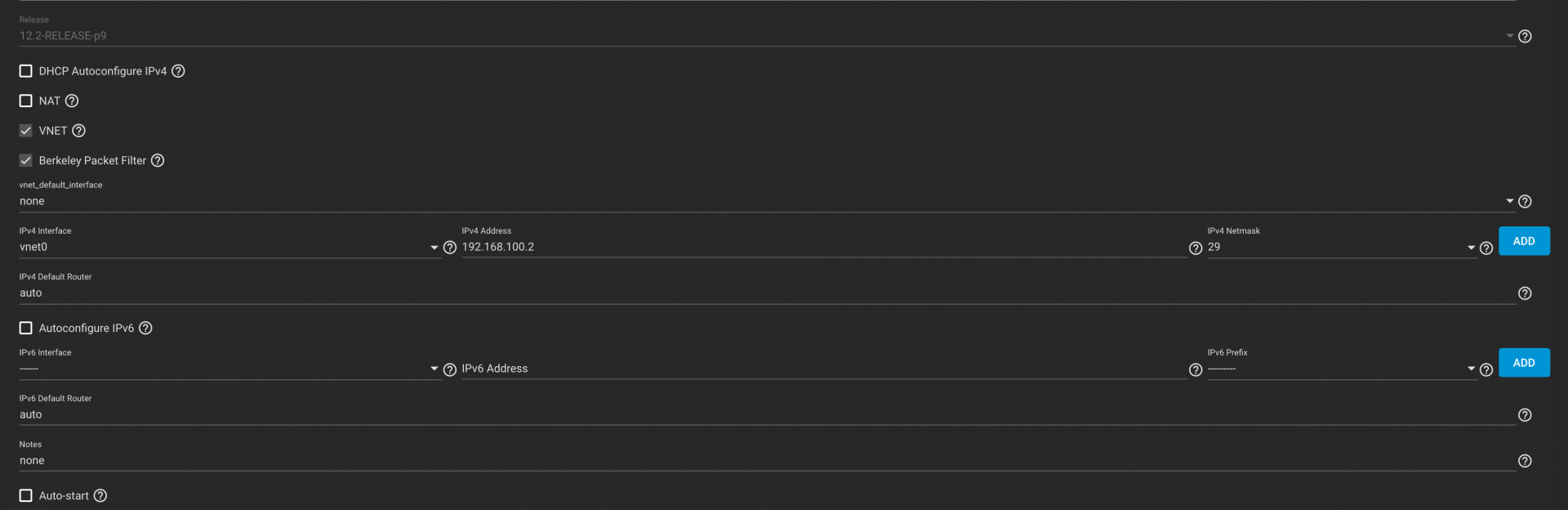

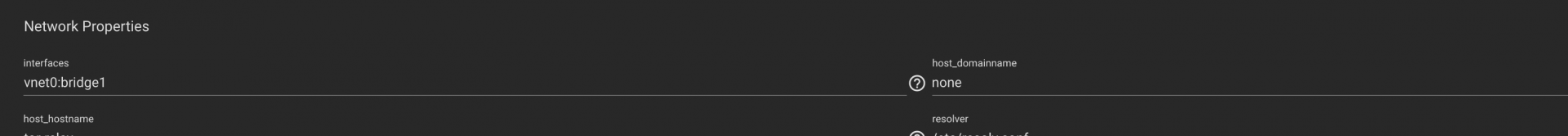

fsociety3765
Feb 2, 2021
61
I'm getting "Error: [EFAULT] Stopped due to VNET failure", when I attempt to start the jail.

That will be overwritten at the next jail restart. So don't.
Use this instead:
