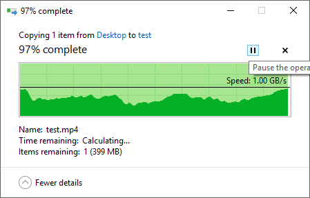

Is that on the HDD pool or the SSD pool?

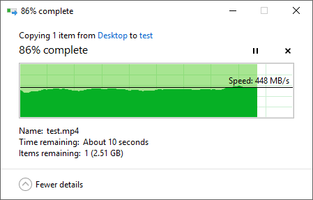

That is to either pool, but just the first few GBs while it's caching to RAM, then it decreases to the speeds on the screenshots I posted above.
And for comparison, same transfer but without jumbo frames:

Only improved overall performance by 100~150MB/s I've never seen 1GB/s writes w/ SMB.

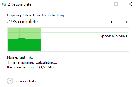

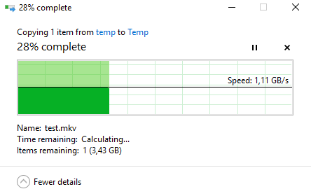

Definitely possible to get 1GB/s+ with SMB, at least while FreeNAS is caching to RAM:
Reading cached data from the server isn't an issue at all. I'll saturate 10Gbit. However I use the server on a primarily write basis so this is where issues start (on both pools).

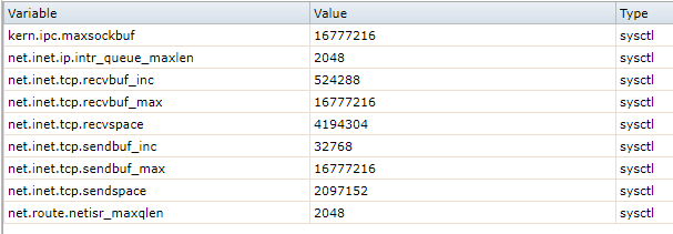

And if the OP wants to try (and besides enabling jumbo frames) these are the only tunables I'm using (found somewhere on the this forum):
I can try tweaking with these once I setup the array again.
I was talking about writes, the first few GB are cached to RAM by FreeNAS, IIRC about 1/8 of your installed RAM is used for cache, so for example I can get 1.1GB/s when I start writing to any pool, or for the total transfer if the total transfer size isn't larger than around 4GB, after that the speed drops to what the pool can sustain, around 900MB/s for the SSD pool, 400MB/s for the HDD pool.

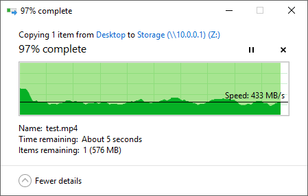

Well testing this using a series of configurations the only two that showed any meaningful insight as to the performance were the following.
unencrypted mirrors volume everything else default settings. The test file is a 19.2GB .mp4 file.
Both tests used a 1500 mtu as testing 9000 showed no meaningful benefit. I'm assuming this may have to do with it was useful in FreeNAS 9.3 but perhaps there were some improvements to the network driver since then.
Using the following Auxiliary parameters the result was as follows:

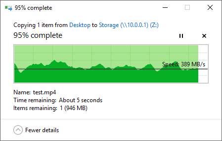

Same test but removing every Auxiliary parameter but server multi channel support = Yes yielded:
That is the first time I've seen it touch 1GB/s writes but the performance is so inconsistent and all over the place only peaking at the very beginning & end of the transfer.

It's not clear to me if you tried the tcp tunables I posted before, default values aren't appropriate for 10GbE.
I did not because my memory is crap at best. I will get back to you about that after I try it but today my schedule is pretty full so likely tomorrow afternoon.

Not what I was hoping to see. The tunables look as if they made absolutely no difference at all.
Bummer, the problem seems network related to me, since the beginning of the transfer, and while FreeNAS is caching the writes to RAM, should max out the link, assuming the source drive in your desktop is fast enough, like a NVMe device or an SSD raid.

Yeah, booting from an NVMe M.2. I can sustain well over 1GB/s reads. What doesn't make sense to me is why the performance is so sporadic for 1 large file transfer. I tried the tunables in combination with the auxiliary parameters mentioned before and tries jumbo packets in conjunction with that. The best peak I saw was 750MB/s but no transfer has sustained anything much higher than 500MB/s.
