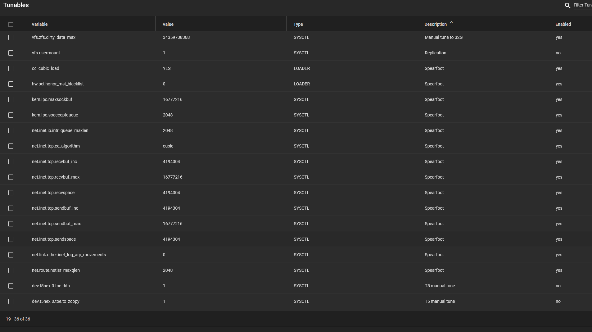

How you changed any of the tunables? If not, you should check out the 10G primers and look through the forums for 10G tuning tips. Use at your own risk, but I have included the tunables I use on both my systems. iperf3 gives me 39Gb+ throughput between systems on the 40G interfaces.

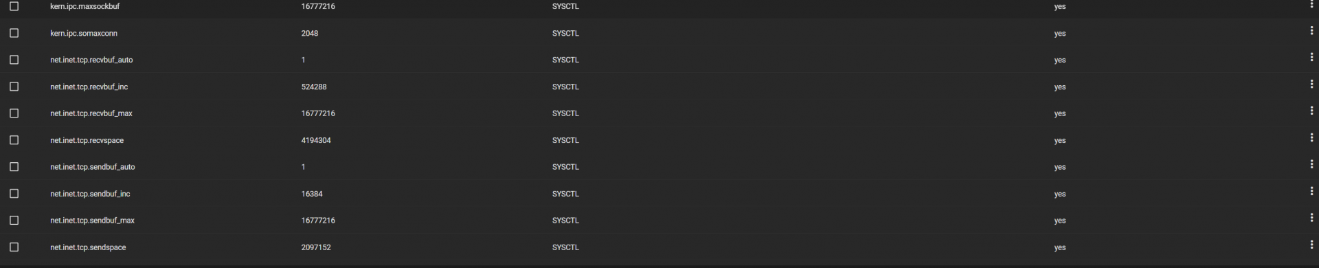

Thanks for the reply.
Here are mine.
