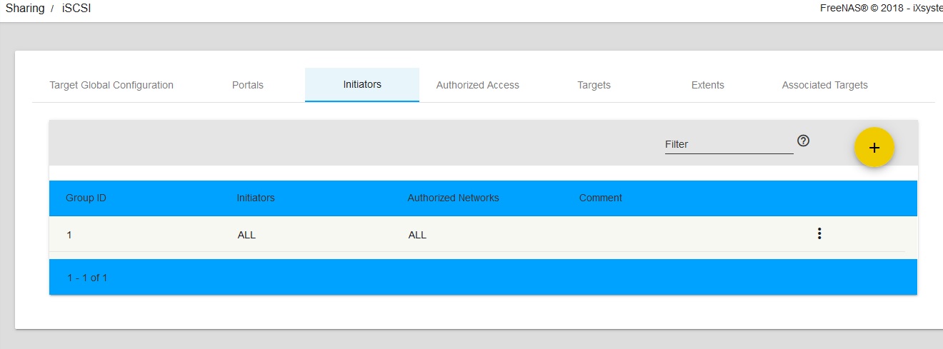

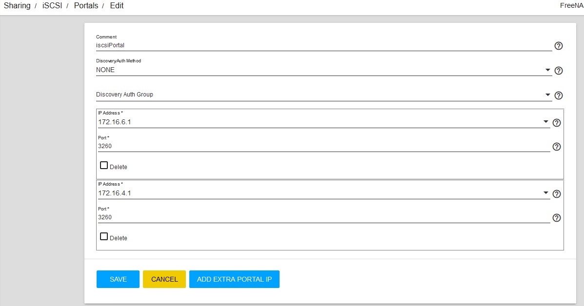

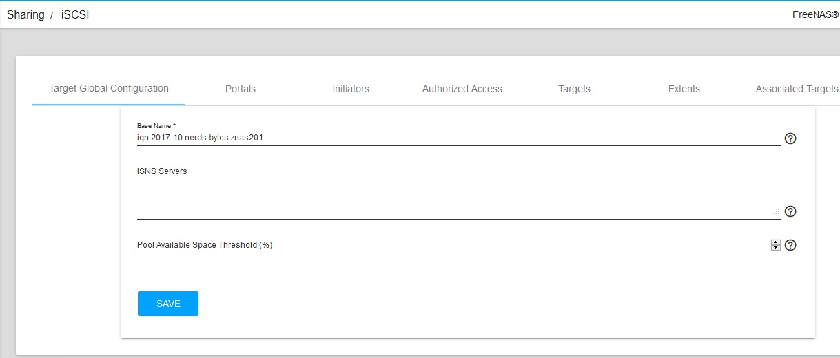

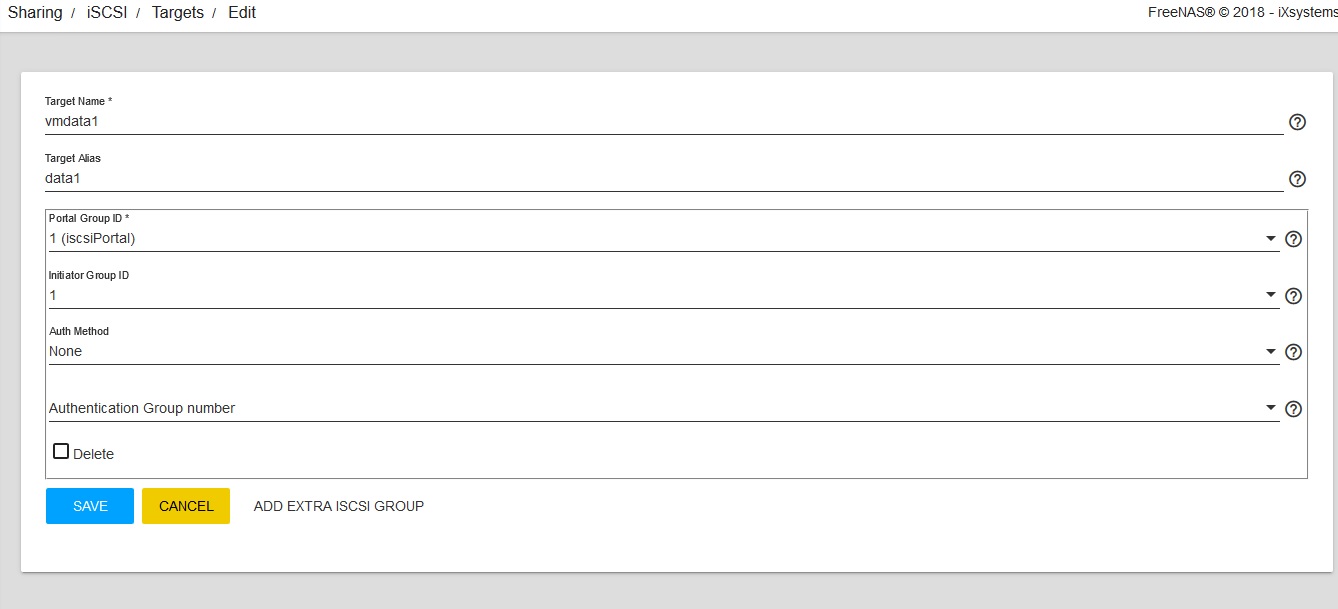

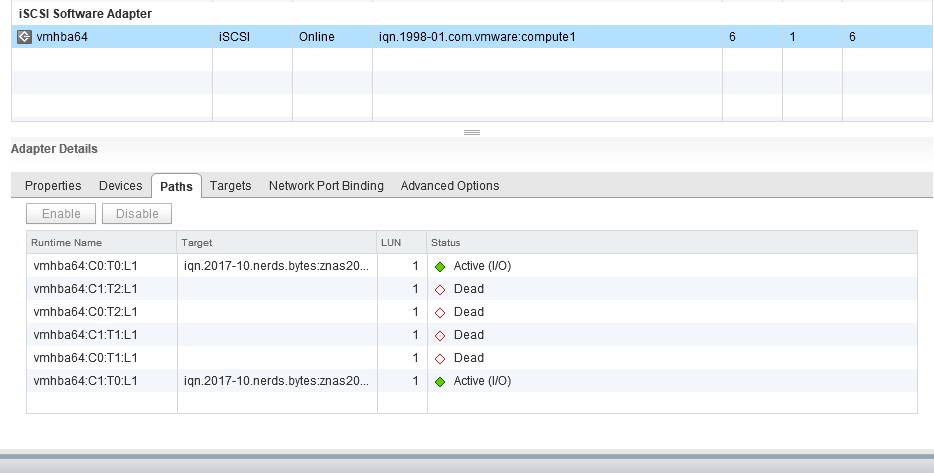

I'm hoping someone can point out something simple I'm overlooking on this one. I've got new hardware and I'm running 11.2 rc1. I had a couple of old pools I had imported and were not working well due to block size so I decided to reconfigure the pools and make new iscsi targets.
Currently I have 3 targets, one for windows and two for vmware (esxi 6.7 U1). All sharing the same portal and initiator. Windows can see and use any of the targets without problems. VMware can see all the targets but only lists the windows target as a device. The extents are identical. I am not using port bindng. In vcenter the paths are detected but have a status of dead. Screen shot of that attached.

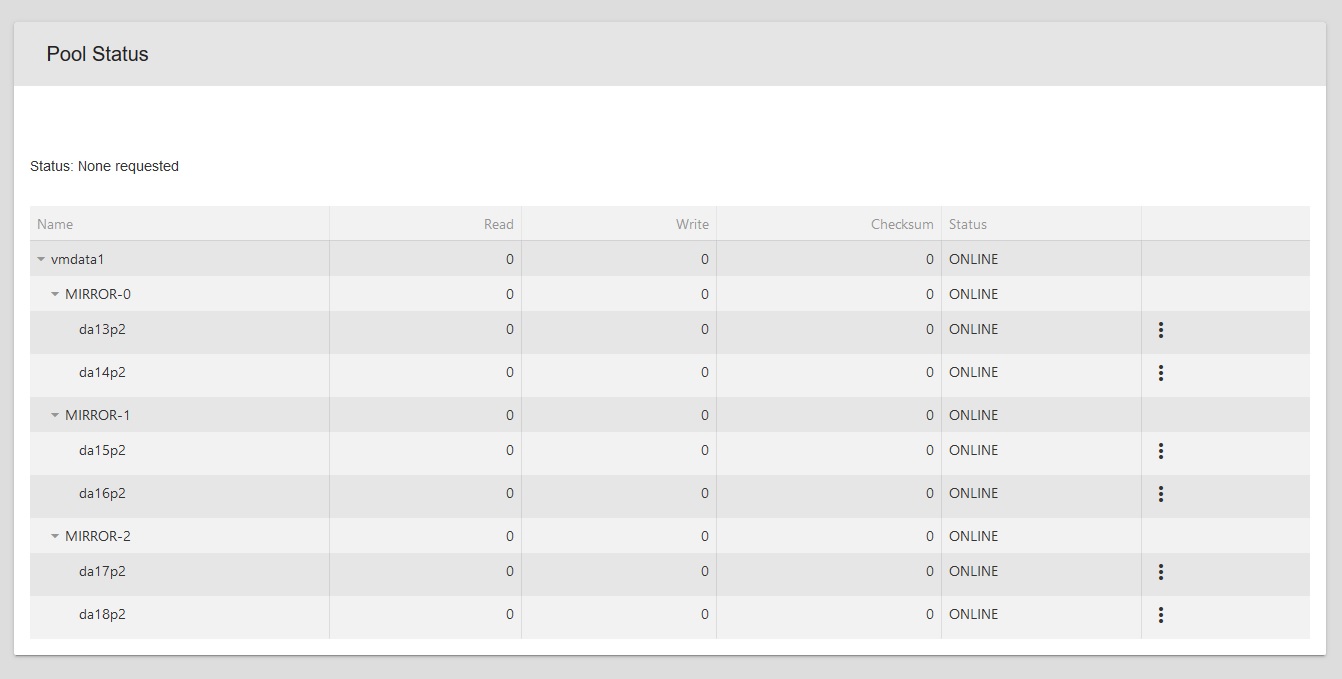

I have 2 pools for vmware storage each with 6 Seagate SAS drives in a mirrored stripe and a single zvol on each for use as a target. Standard GUI creation with no options changed.

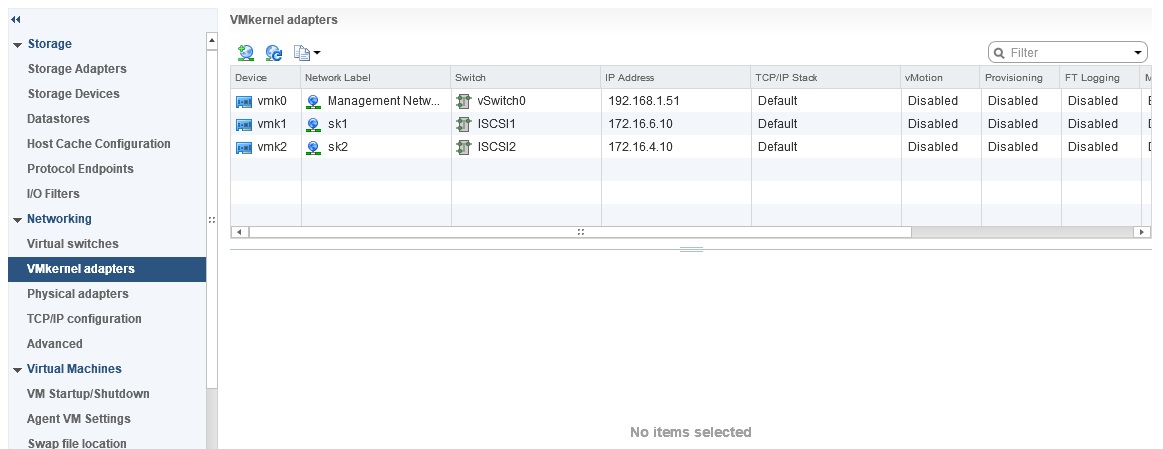

ESXI host is a Supermicro X9DRi-LN4 with dual 2660v2 and 128Gb RAM using an intel 10G x550 plus whats listed as an Intel 82599EB 10-Gigabit SFP+ that I was pretty sure was a MELLANOX CONNECTX-2.
NAS is in my sig and besides hard drives the only other addition was a Chelsio 10GB 2-Ports SFP+ card.
Currently iscsi network is not yet isolated and everything runs on a Netgear XS728T.

I was hoping it would be you kdragon. Updated original post and added additional screen captures. And yes that little flash drive is the boot drive.

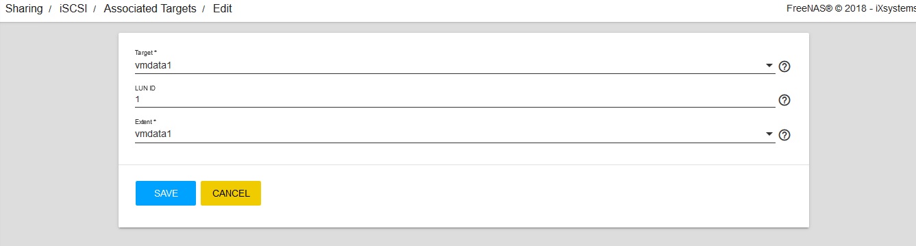

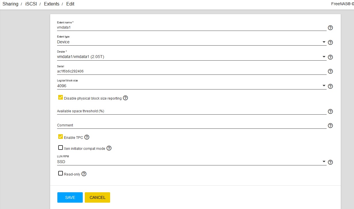

That looks like a fairly straight forward setup... The pool vmdata1 has a zvol (also named vmdata1) that is mapped as an extent to the data1 target with two portal IPs...
can you provide the output of cat /etc/ctl.conf in [ code ] tags? FreeNAS seems to be doing something screwy...
Also try:
ping -S 172.16.6.1 -r 172.16.6.10
and
ping -S 172.16.4.1 -r 172.16.4.10
This will ping from FreeNAS -S IP to ESXi but skip the -r routing table. This will prevent any pings from being routed and ensures a "direct" L2 path (only because we know 172.16.X.10 is not a router)
https://www.freebsd.org/cgi/man.cgi...FreeBSD+11.2-RELEASE&arch=default&format=html

Those pings worked fine from freenas. vmkping from the host works also.
root@znas:~ # ping -S 172.16.6.1 -r 172.16.6.10
PING 172.16.6.10 (172.16.6.10) from 172.16.6.1: 56 data bytes
64 bytes from 172.16.6.10: icmp_seq=0 ttl=64 time=2.192 ms
64 bytes from 172.16.6.10: icmp_seq=1 ttl=64 time=0.244 ms
64 bytes from 172.16.6.10: icmp_seq=2 ttl=64 time=0.643 ms
64 bytes from 172.16.6.10: icmp_seq=3 ttl=64 time=0.241 ms
64 bytes from 172.16.6.10: icmp_seq=4 ttl=64 time=0.218 ms
^C
--- 172.16.6.10 ping statistics ---
5 packets transmitted, 5 packets received, 0.0% packet loss
round-trip min/avg/max/stddev = 0.218/0.708/2.192/0.759 ms
root@znas:~ # ping -S 172.16.4.1 -r 172.16.4.10
PING 172.16.4.10 (172.16.4.10) from 172.16.4.1: 56 data bytes
64 bytes from 172.16.4.10: icmp_seq=0 ttl=64 time=3.232 ms
64 bytes from 172.16.4.10: icmp_seq=1 ttl=64 time=0.214 ms
64 bytes from 172.16.4.10: icmp_seq=2 ttl=64 time=0.348 ms
^C
--- 172.16.4.10 ping statistics ---
3 packets transmitted, 3 packets received, 0.0% packet loss
round-trip min/avg/max/stddev = 0.214/1.265/3.232/1.392 ms
root@znas:~ # cat /etc/ctl.conf
portal-group default {
portal-group pg1 {
		tag 0x0001
		discovery-filter portal-name
		discovery-auth-group no-authentication
		listen 172.16.6.1:3260
		listen 172.16.4.1:3260
		option ha_shared on
lun "NeoD" {
		ctl-lun 5
		path "/mnt/neoD/neoSet/data"
		blocksize 512
		option pblocksize 0
		serial "ac1f6b6c292405"
		device-id "iSCSI Disk	  ac1f6b6c292405				 "
		option vendor "FreeNAS"
		option product "iSCSI Disk"
		option revision "0123"
		option naa 0x6589cfc000000ed8f4c4ed6e16600ce9
		option insecure_tpc on
		option rpm 1
lun "vmdata1" {
		ctl-lun 6
		path "/dev/zvol/vmdata1/vmdata1"
		blocksize 4096
		option pblocksize 0
		serial "ac1f6b6c292406"
		device-id "iSCSI Disk	  ac1f6b6c292406				 "
		option naa 0x6589cfc00000074b2ada1d40d148e508
		option rpm 1
lun "vmdata2" {
		ctl-lun 7
		path "/dev/zvol/vmdata2/vmdata2"
		blocksize 4096
		option pblocksize 0
		serial "ac1f6b6c292407"
		device-id "iSCSI Disk	  ac1f6b6c292407				 "
		option naa 0x6589cfc000000a7ed61583ecc0aeb56d
		option rpm 1
target iqn.2017-10.nerds.bytes:znas201:neo {
		alias "neo"
		portal-group pg1 no-authentication
		lun 1 "NeoD"
target iqn.2017-10.nerds.bytes:znas201:vmdata1 {
		alias "data1"
		lun 1 "vmdata1"
target iqn.2017-10.nerds.bytes:znas201:vmdata2 {
		alias "data 2"
		lun 1 "vmdata2"
HoneyBadger
actually does care
Administrator
Feb 6, 2014
5,112
It shouldn't be an issue, but best practice is usually to not present the same LUNs to Windows and VMware due to potential issues. Windows is supposed to be polite and not clobber the partition table/resignature it - but Windows is supposed to do a lot of things that it doesn't.
Re: your ctl.conf - did you manually assign LUN ID 1 to the mappings, or is that the new default in 11.2? Mine are all LUN 0.
bed
Jun 17, 2011
38
New default.
As long as you don't favorite the targets in windows it shouldn't try to connect to it. When I get a little further along the windows target will get its own portal and initiator. Will have to wait till I get a second switch though (need more SFP+ ports).

What does the ESX output of esxcli storage core path list look like?
[root@localhost:~] esxcli storage core path list
iqn.1998-01.com.vmware:compute1-00023d000001,iqn.2017-10.nerds.bytes:znas201:neo,t,1-naa.6589cfc000000ed8f4c4ed6e16600ce9
   UID: iqn.1998-01.com.vmware:compute1-00023d000001,iqn.2017-10.nerds.bytes:znas201:neo,t,1-naa.6589cfc000000ed8f4c4ed6e16600ce9
   Runtime Name: vmhba64:C0:T0:L1
   Device: naa.6589cfc000000ed8f4c4ed6e16600ce9
   Device Display Name: FreeNAS iSCSI Disk (naa.6589cfc000000ed8f4c4ed6e16600ce9)
   Adapter: vmhba64
   Channel: 0
   Target: 0
   LUN: 1
   Plugin: NMP
   State: active
   Transport: iscsi
   Adapter Identifier: iqn.1998-01.com.vmware:compute1
   Target Identifier: 00023d000001,iqn.2017-10.nerds.bytes:znas201:neo,t,1
   Adapter Transport Details: iqn.1998-01.com.vmware:compute1
   Target Transport Details: IQN=iqn.2017-10.nerds.bytes:znas201:neo Alias= Session=00023d000001 PortalTag=1
   Maximum IO Size: 131072
sas.500605b00582f650-sas.606bab2d9facfd72-naa.600605b00582f650236bab2d9facfd72
   UID: sas.500605b00582f650-sas.606bab2d9facfd72-naa.600605b00582f650236bab2d9facfd72
   Runtime Name: vmhba0:C2:T0:L0
   Device: naa.600605b00582f650236bab2d9facfd72
   Device Display Name: Local LSI Disk (naa.600605b00582f650236bab2d9facfd72)
   Adapter: vmhba0
   Channel: 2
   Target: 0
   LUN: 0
   Plugin: NMP
   State: active
   Transport: sas
   Adapter Identifier: sas.500605b00582f650
   Target Identifier: sas.606bab2d9facfd72
   Adapter Transport Details: 500605b00582f650
   Target Transport Details: 606bab2d9facfd72
   Maximum IO Size: 262144
usb.vmhba32-usb.0:0-t10.SanDisk_Cruzer_Fit______4C532000020629114362
   UID: usb.vmhba32-usb.0:0-t10.SanDisk_Cruzer_Fit______4C532000020629114362
   Runtime Name: vmhba32:C0:T0:L0
   Device: t10.SanDisk_Cruzer_Fit______4C532000020629114362
   Device Display Name: Local USB Direct-Access (t10.SanDisk_Cruzer_Fit______4C532000020629114362)
   Adapter: vmhba32
   Channel: 0
   Target: 0
   LUN: 0
   Plugin: NMP
   State: active
   Transport: usb
   Adapter Identifier: usb.vmhba32
   Target Identifier: usb.0:0
   Adapter Transport Details: Unavailable or path is unclaimed
   Target Transport Details: Unavailable or path is unclaimed
   Maximum IO Size: 32768
iqn.1998-01.com.vmware:compute1-00023d000002,iqn.2017-10.nerds.bytes:znas201:vmdata2,t,1-
   UID: iqn.1998-01.com.vmware:compute1-00023d000002,iqn.2017-10.nerds.bytes:znas201:vmdata2,t,1-
   Runtime Name: vmhba64:C1:T2:L1
   Device: No associated device
   Device Display Name: No associated device
   Adapter: vmhba64
   Channel: 1
   Target: 2
   LUN: 1
   Plugin: NMP
   State: dead
   Transport: iscsi
   Target Identifier: 00023d000002,iqn.2017-10.nerds.bytes:znas201:vmdata2,t,1
iqn.1998-01.com.vmware:compute1-00023d000001,iqn.2017-10.nerds.bytes:znas201:vmdata2,t,1-
   UID: iqn.1998-01.com.vmware:compute1-00023d000001,iqn.2017-10.nerds.bytes:znas201:vmdata2,t,1-
   Runtime Name: vmhba64:C0:T2:L1
   Adapter: vmhba64
   Channel: 0
   Target: 2
   LUN: 1
   Plugin: NMP
   State: dead
   Transport: iscsi
   Target Identifier: 00023d000001,iqn.2017-10.nerds.bytes:znas201:vmdata2,t,1
iqn.1998-01.com.vmware:compute1-00023d000002,iqn.2017-10.nerds.bytes:znas201:vmdata1,t,1-
   UID: iqn.1998-01.com.vmware:compute1-00023d000002,iqn.2017-10.nerds.bytes:znas201:vmdata1,t,1-
   Runtime Name: vmhba64:C1:T1:L1
   Adapter: vmhba64
   Channel: 1
   Target: 1
   LUN: 1
   Plugin: NMP
   State: dead
   Transport: iscsi
   Target Identifier: 00023d000002,iqn.2017-10.nerds.bytes:znas201:vmdata1,t,1
iqn.1998-01.com.vmware:compute1-00023d000001,iqn.2017-10.nerds.bytes:znas201:vmdata1,t,1-
   UID: iqn.1998-01.com.vmware:compute1-00023d000001,iqn.2017-10.nerds.bytes:znas201:vmdata1,t,1-
   Runtime Name: vmhba64:C0:T1:L1
   Adapter: vmhba64
   Channel: 0
   Target: 1
   LUN: 1
   Plugin: NMP
   State: dead
   Transport: iscsi
   Target Identifier: 00023d000001,iqn.2017-10.nerds.bytes:znas201:vmdata1,t,1
sas.500605b00582f650-sas.606bf9784a60e3d2-naa.600605b00582f650236bf9784a60e3d2
   UID: sas.500605b00582f650-sas.606bf9784a60e3d2-naa.600605b00582f650236bf9784a60e3d2
   Runtime Name: vmhba0:C2:T1:L0
   Device: naa.600605b00582f650236bf9784a60e3d2
   Device Display Name: Local LSI Disk (naa.600605b00582f650236bf9784a60e3d2)
   Adapter: vmhba0
   Channel: 2
   Target: 1
   LUN: 0
   Plugin: NMP
   State: active
   Transport: sas
   Target Identifier: sas.606bf9784a60e3d2
   Target Transport Details: 606bf9784a60e3d2
iqn.1998-01.com.vmware:compute1-00023d000002,iqn.2017-10.nerds.bytes:znas201:neo,t,1-naa.6589cfc000000ed8f4c4ed6e16600ce9
   UID: iqn.1998-01.com.vmware:compute1-00023d000002,iqn.2017-10.nerds.bytes:znas201:neo,t,1-naa.6589cfc000000ed8f4c4ed6e16600ce9
   Runtime Name: vmhba64:C1:T0:L1
   Adapter: vmhba64
   Channel: 1
   Target: 0
   LUN: 1
   Plugin: NMP
   State: active
   Transport: iscsi
   Target Identifier: 00023d000002,iqn.2017-10.nerds.bytes:znas201:neo,t,1
   Target Transport Details: IQN=iqn.2017-10.nerds.bytes:znas201:neo Alias= Session=00023d000002 PortalTag=1
kdragon75
Aug 7, 2016
2,457
Ok so the SanDisk is the boot drive for ESXi. That's a relief. On your target association, try setting your second lun to LUN 2. I vaguely remember something about ESXi only allowing one LUN 1, 2, and so fourth per portal. i could be off on this but it's easy enough to test. If this fixes the issue, you should file a bug report as defaulting to LUN 1 per target may not be ideal even if its standard.
kdragon75
Aug 7, 2016
2,457
You could also just move both vmware LUNs into one target. That's perfectly acceptable.

I tried adjusting LUNs to no avail. I tried multiple combinations including moving the windows target to 3 and and splitting the vm targets on LUN 1 and 2 and vice versa. LUN 0 is not allowed via the GUI.
I removed one of the vm targets for testing and now not able to create any additional targets regardless of name used. A reboot did not help. messages says
Nov 12 10:20:06 znas ctld[2359]: no LUNs defined for target "iqn.2017-10.nerds.bytes:znas201:vmdata2"
Nov 12 10:20:08 znas ctld[2359]: no LUNs defined for target "iqn.2017-10.nerds.bytes:znas201:vmdata2"
Should I wipe my iscsi config and redo it?
Edit:
Looks like you get that error if you have no LUN 1. Changed one of them back to LUN 1 and I can create targets again.
File a bug report on this one. The UI needs better validation.

An update.
I destroyed the pools and recreated them using different names and the targets work now. I had recreated the pools several times but always used the same names. Maybe it didn't like having a pool and zvol using the same (nested) names?
I'll still probably have to add an SSD for a log or cache device on each pool but so far it seems to be working ok.
Those are different purposes (log vs cache) - also, can I ask why didn't you make one larger pool with 12 drives in mirrors and cut a larger zvol from that?
bed
Jun 17, 2011
38
Its been my understanding that a pool with that many drives was not advisable. Could be old thinking or my own misconceptions. As far as log/cache drive, Its because I forget which one is more beneficial for vm environments. I want to say I am seeking a log device for my purposes and while I type this am noticing your sig, that will be my next stop. Thanks.
