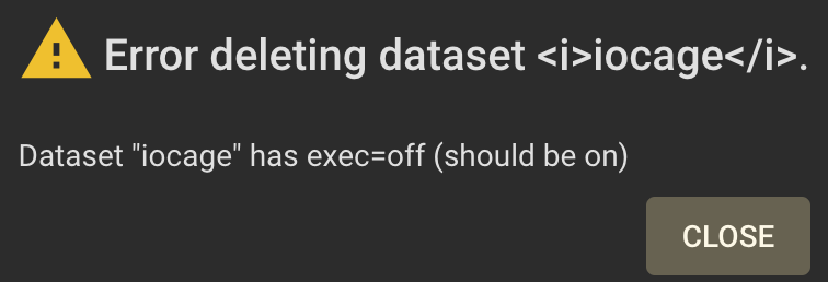

Just tried that and got the following error:
Looks like the UI is having some HTML rendering issues in addition to problems with having the directory destroyed.
Should I just do it from the command line?

Well, just tried that and all the devices are allegedly busy.
# rm -R *
rm: download: Device busy
rm: images: Device busy
rm: jails: Device busy
rm: log: Device busy
rm: releases: Device busy
rm: templates: Device busy
:frown:
when I traverse to jails in the GUI, I get the following message:
File "/usr/local/lib/python3.8/site-packages/middlewared/main.py", line 137, in call_method
result = await self.middleware._call(message['method'], serviceobj, methodobj, params, app=self,
File "/usr/local/lib/python3.8/site-packages/middlewared/main.py", line 1206, in _call
File "/usr/local/lib/python3.8/site-packages/middlewared/main.py", line 1110, in run_in_executor
File "/usr/local/lib/python3.8/concurrent/futures/thread.py", line 57, in run
File "/usr/local/lib/python3.8/site-packages/middlewared/schema.py", line 977, in nf
return f(*args, **kwargs)
File "/usr/local/lib/python3.8/site-packages/middlewared/plugins/jail_freebsd.py", line 711, in query
self.check_dataset_existence()
File "/usr/local/lib/python3.8/site-packages/middlewared/plugins/jail_freebsd.py", line 1019, in check_dataset_existence
IOCCheck(migrate=True, reset_cache=True)
File "/usr/local/lib/python3.8/site-packages/iocage_lib/ioc_check.py", line 58, in __init__
self.__check_datasets__()
File "/usr/local/lib/python3.8/site-packages/iocage_lib/ioc_check.py", line 131, in __check_datasets__
iocage_lib.ioc_common.logit({
File "/usr/local/lib/python3.8/site-packages/iocage_lib/ioc_common.py", line 107, in logit
callback(content, exception)
File "/usr/local/lib/python3.8/site-packages/iocage_lib/ioc_common.py", line 80, in callback
raise callback_exception(message)
RuntimeError: Dataset "iocage" has exec=off (should be on)
So I presume I have to chmod the directory first?
Patrick M. Hausen
Nov 25, 2013
7,776
These are all datasets. You need to zfs destroy -r <poolname>/iocage.
Constantin
Vampire Pig
May 19, 2017
1,829
Happiness! There is a giant smoking crater where iocage once was. Thank you!

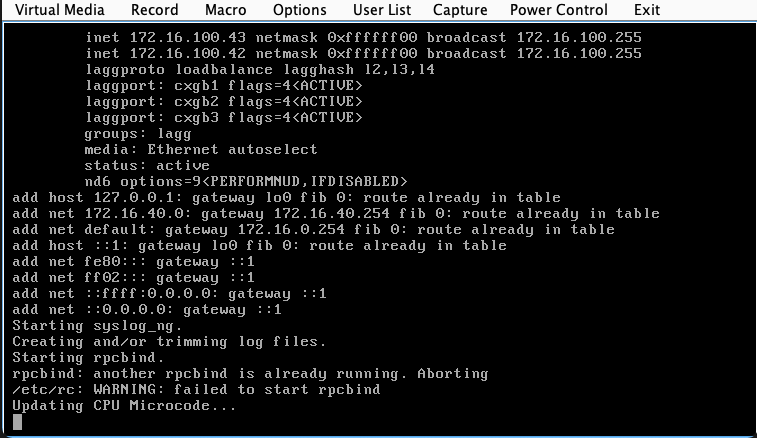

Tried to reboot to 12U3. it still goes into reboot loop.
An error I notice is "Failed to sync interfaces". Last thing I see I did not expect and before it flips into reboot is "Updating CPU Microcode"
