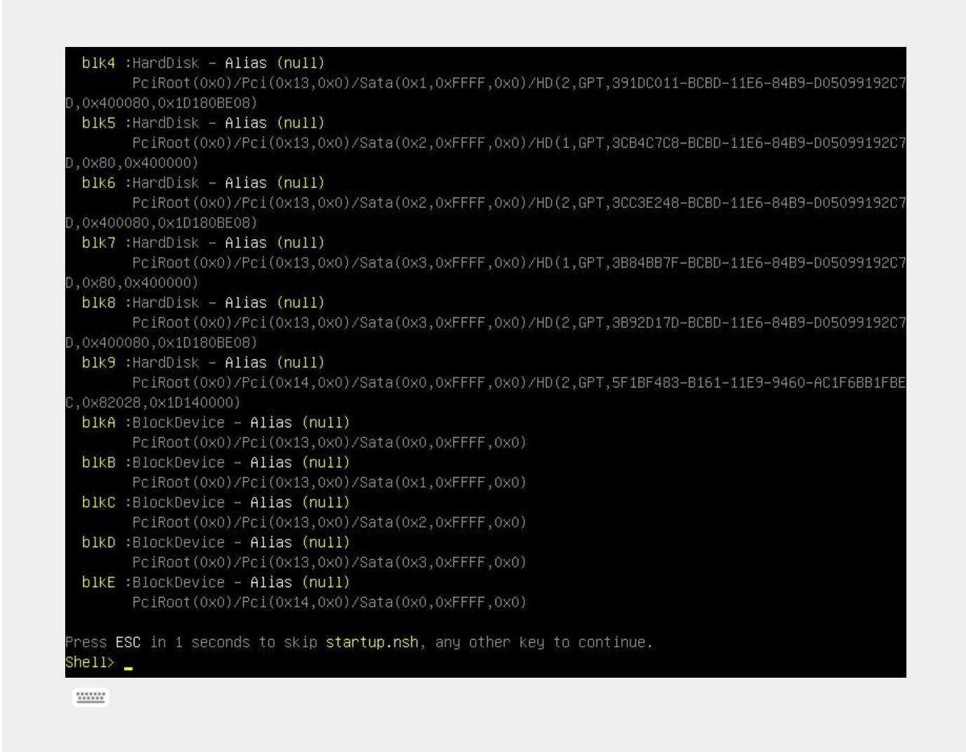

Upgrade from U2.1 to U3 this morning did not complete. I run a small system on a Supermicro A2SDi-8C+-HLN4F . 4 SATA drives (plus a SATA SSD boot disk), 64GB memory, serving SMB files. No jails.
Watching the installation this is how it ends:

UEFI shell - how did you try to upgrade? Just from the web ui? Could be something simple as uefi just needs a kick telling it what to boot.
Upgraded one of my (bios based) systems earlier without issues, and later my home system with uefi will get upgraded, hopefully not ending i uefi shell.
My failed update was from from the web UI.

After my trouble updating from the GUI, I downloaded the U3 ISO and installed it. The install gave me the option of preserving my config file and it did. Install took a couple of minutes and everything looks good.

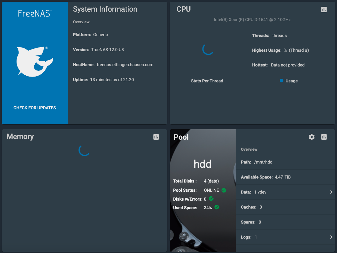

I experience two hanging dashboard widgets on my main system. Everything else seems to be working. Any ideas?

Clear cache I did, different browser not yet.

clear cache, different browser ?
I have the same issue as @Patrick M. Hausen - Tried it with Firefox 87.0 (64-bit) and Chrome Version 89.0.4389.114 (Official Build) (64-bit) on Ubuntu 20.10 (with clearning cache, etc.). Same issue.

Just ran into the same issure.
I did a fresh install og 12.0 U2.1, and then updated to U3, also for me the webgui id broken, and dont know what even more.
I will try a direct /fresh install of U3 and see what happens.
Greetz
Michael
Did testing with a fresh U3 install. Same issure.
If i directly access the metrics, all looks good. seems only be related to the dashboard.
