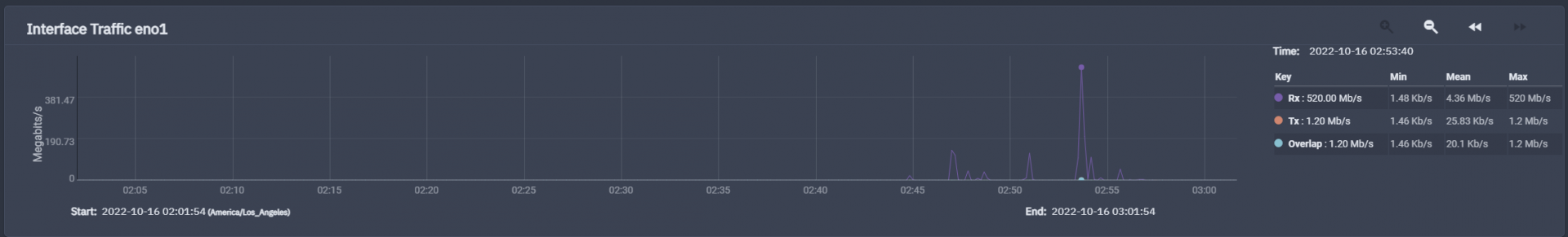

Patek2
Oct 15, 2022
12
Network statistic looks like this
diogen
Jul 21, 2022
72
Is this actually normal?
It CAN be normal...
The same goes with one large file mov. file (video) (that was 50 gb in size)... Back or Forth, speed were the same.
If your PC uses an NVMe drive and transfer speed (using this drive!) stays the same regardless
- whether you transfer one multi-GB file or a bunch of smaller ones
- what direction the transfer is done;
then most likely the bottleneck is the TrueNAS server.
Start with listing the hardware of your server in details...
Patek2
Oct 15, 2022
12
It CAN be normal...
i3 2 cores, 4 threads, 8 gb ram ddr3 1600 mhz, nas running on 120 gb ssd sata. Files are stored in two mirrored iron wolf seagate 2 tb.
It's HP ProDesk 600 G1
