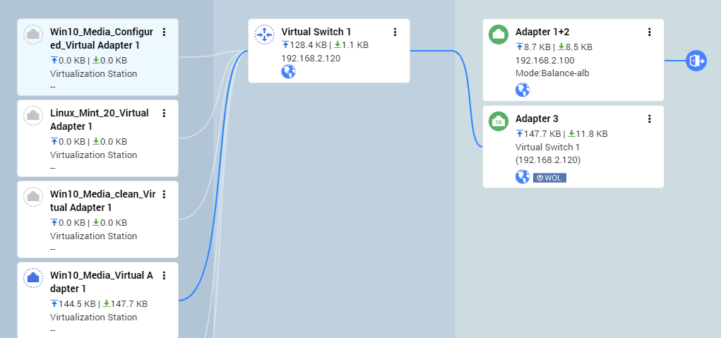

Tried to search but dont find much info on this. On my qnap i have a virtual switch which all my vm's go through as shown in the image.
Is there something similar on TrueNAS ? Its much more convenient to use this the physical port for each VM.
