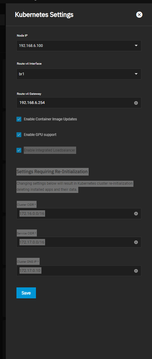

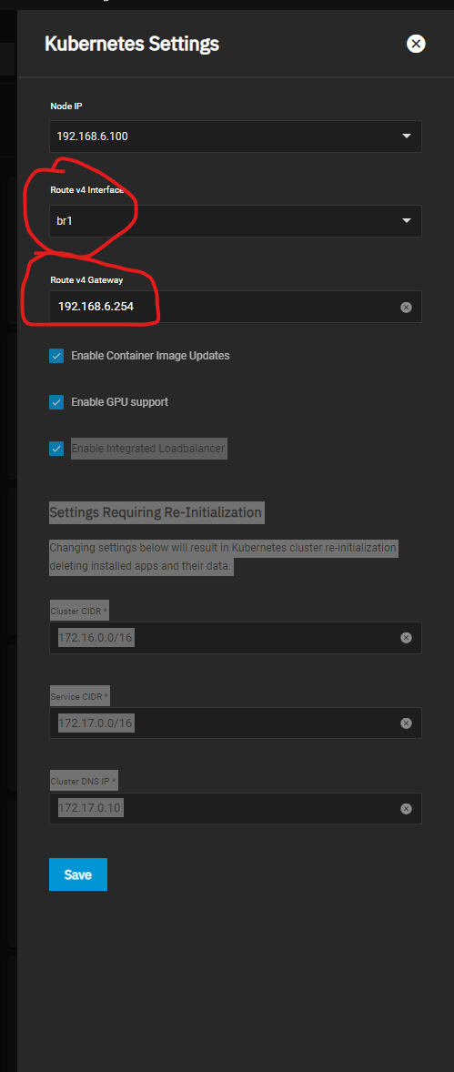

Have u set networksettings under Apps -> settings advanced ?
the important ones are "Route v4 Gateway" (your Router Address) and "Route v4 Interface" (your Truenas Lan interface)

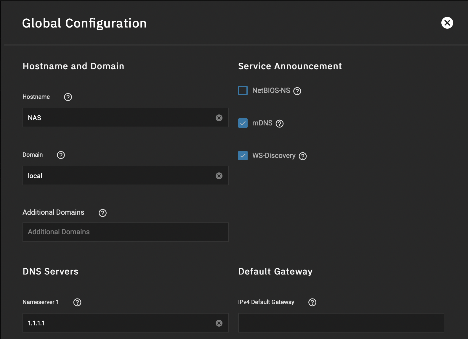

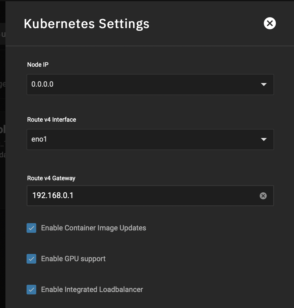

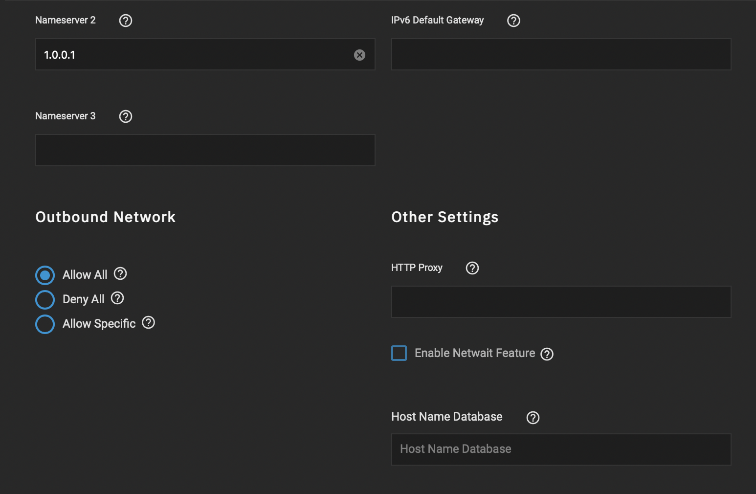

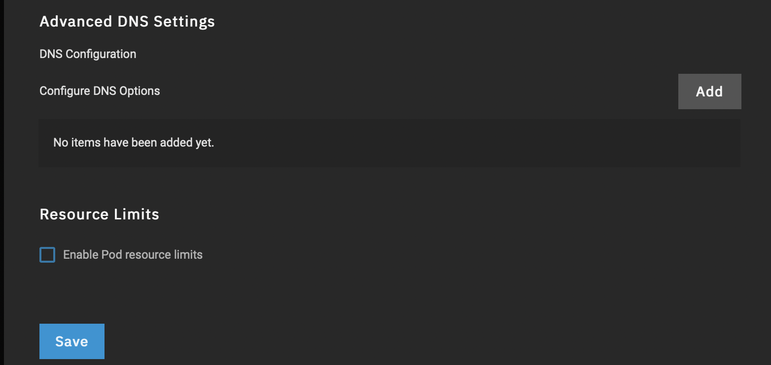

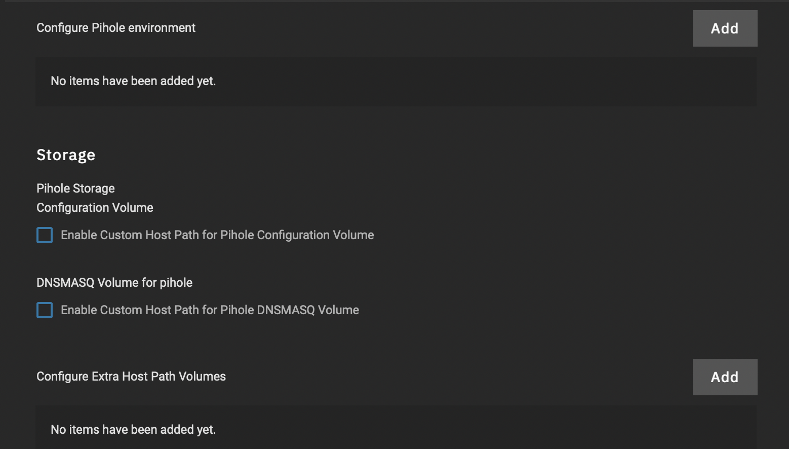

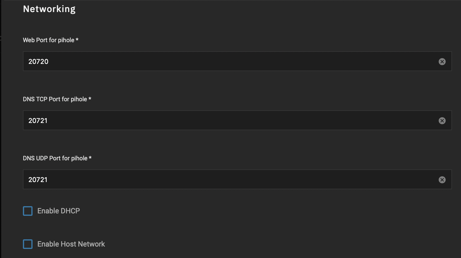

Southpaw1496
Jun 1, 2021
23

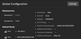

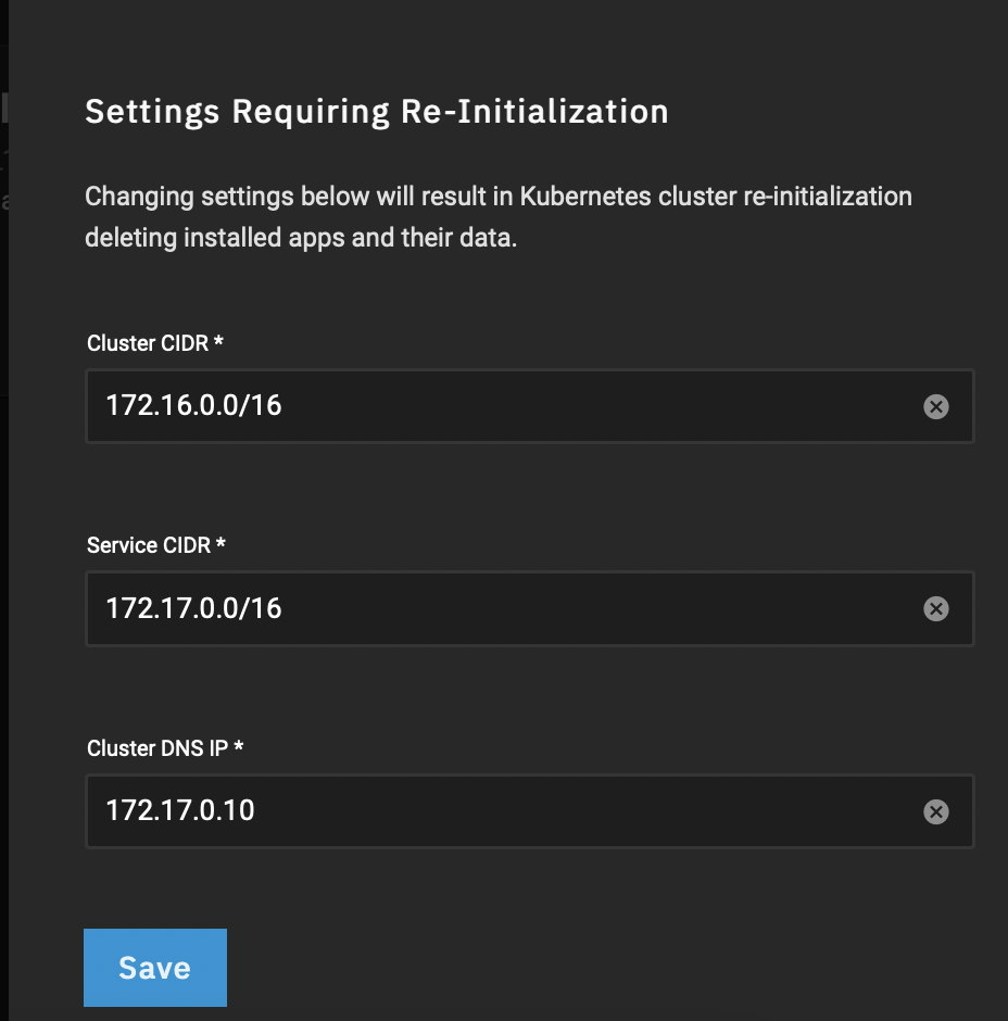

Kubernetes settings:
Screenshot 2022-10-18 at 11.39.30 am.png Screenshot 2022-10-18 at 11.39.44 am.png

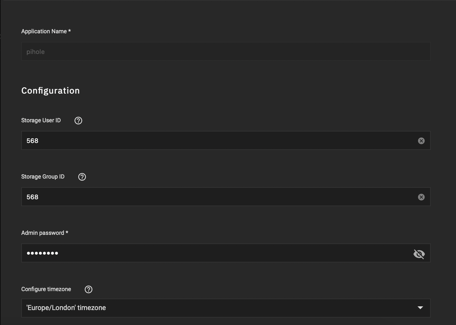

PiHole settings (left default whenever possible as it was only for testing):
Screenshot 2022-10-18 at 11.40.19 am.png Screenshot 2022-10-18 at 11.40.35 am.png Screenshot 2022-10-18 at 11.40.53 am.png Screenshot 2022-10-18 at 11.41.05 am.png

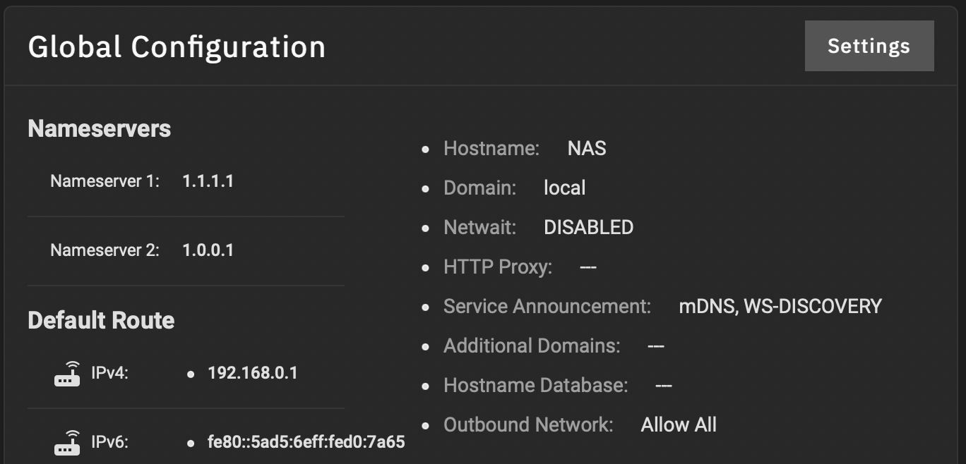

Network Settings:
Screenshot 2022-10-18 at 11.46.31 am.png Screenshot 2022-10-18 at 11.45.39 am.png Screenshot 2022-10-18 at 11.46.01 am.png
If there's a better way then screenshots to get all this information, I'm all ears
justjasch
May 8, 2022
20
ok,
plz. lets try 2 things, first add your default Gateway under Global Conf.
under Kuberbnetes settings set the Node IP (the drop down should have you Truenas ip avail. .
then plz restart and try again with pi hole install
Southpaw1496
Jun 1, 2021
23
ok,
0.0.0.0 is the only available Node IP in the dropdown.
I hardcoded the gateway (which was correct anyway) but still no joy.

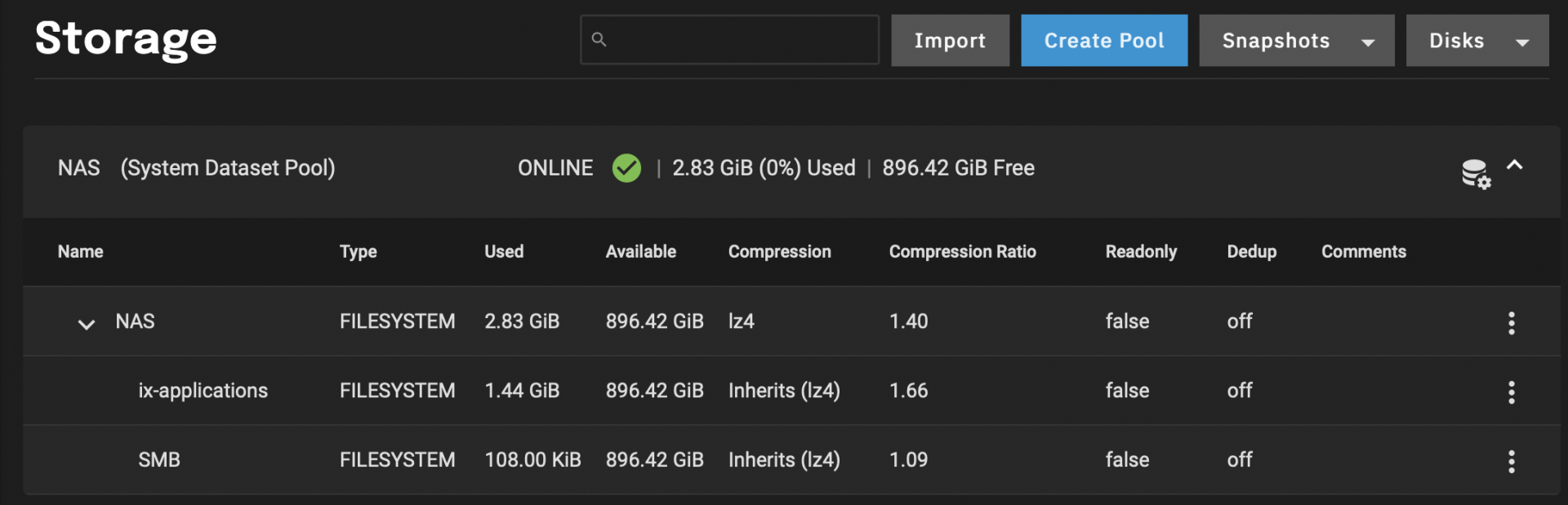

ok on other thing an App pool is set?
under apps settings a Pool ist set and under storage u can see Ixapplication Dataset on this Pool?

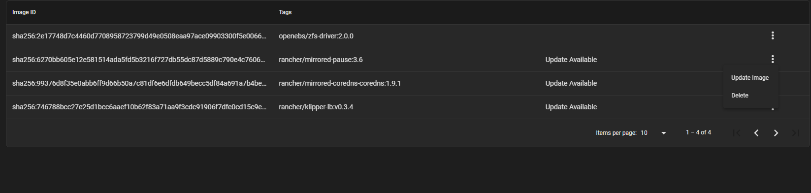

ok thats strange lets reset docker stuff (there is some stuff on it 1GB+ used).
under Apps Settings unset Pool-> then under Storage delete IX-Apps Dataset -> go back Apps now he promts for a Pool -> choose one base images will be fetched.
then go to Manage Docker Images and update the Base images .
then try a gain install with default.
Southpaw1496
