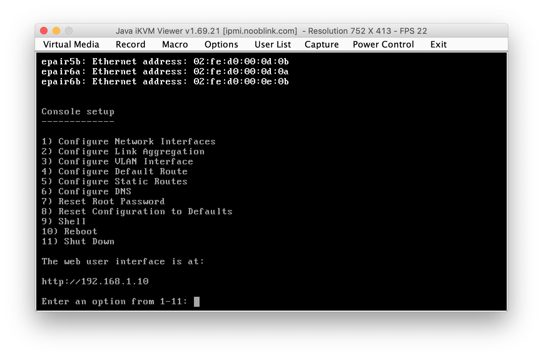

This looks to have fixed it for me as well:
