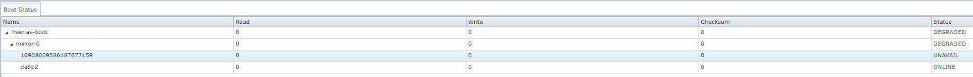

geopfarth
Apr 14, 2017
96
so I copied off the configuration and ran a scrub boot. da9p2 is showing as Faulted and the boot volume as degraded. I am still having the issue where the system will not let me designate the drive when I try to replace the disk. Is there a way to do this from command line? Do I have any options on this?
I downloaded and installed the 11.1.U2 update. the system seemed to install it just fine and rebooted as normal. The Boot status page now looks like this
I am still unable to input the drive name in the popup window when I click on the "replace" radio button.

Does anyone have any advice on how to get around this? Can I simply "Detach" the bad drive and attach a new one? I have other thumb drives that I could copy the config and OS to.

You should be able to do this. It's weird that you can't use the replace GUI window.

well, this is what I got back:
Request Method: POST
Request URL: http://192.168.0.23/system/bootenv/pool/detach/10908009586187677159/
Software Version: FreeNAS-11.1-U2 (c636d1f4b)
Exception Type: ClientException
Exception Value:
[EINVAL] Failed to find vdev for 10908009586187677159
Exception Location: /usr/local/lib/python3.6/site-packages/middlewared/client/client.py in call, line 394
Server time: Thu, 22 Feb 2018 12:47:20 -0800

Not sure if that is good or bad

That is not good. We're probably going to have to dive into the command line to get this solved.
